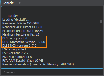

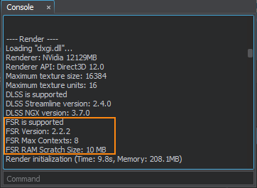

The upscalers are initialized on render initialization. To verify whether they are supported and initialized after application startup, you can do one of the following:升频器在渲染初始化时初始化。要验证它们是否受支持并在应用程序启动后初始化,可以执行以下操作之一:
  • Check the Render section of the console output.检查控制台输出的Render部分。
  • Run the dlss_info and/or fsr_info console commands.运行dlss_info和/或fsr_info控制台命令。
For example, the Render section may provide the following information:例如,Render部分可以提供以下信息:
源代码
---- Render ----
DLSS is supported
DLSS Streamline version: 2.7.32
FSR is supported
FSR Version: 3.1.3
FSR Max Contexts: 8
FSR RAM Scratch Size: 10 MB
If the upscaler is not supported, a corresponding message will be displayed in the console.如果不支持upscaler,则控制台中将显示相应的消息。

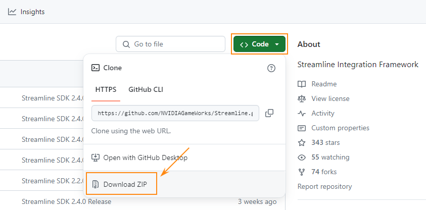

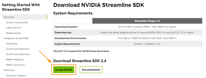

  1. Follow this link to download the NVIDIA Streamline SDK, which serves as a wrapper for DLSS and all its features.Follow this link to download the NVIDIA RTX DLSS SDK, which serves as a wrapper for DLSS and all its features.点击此链接下载 NVIDIA Streamline SDK,它作为 DLSS 及其全部功能的封装器。
  2. Click Access Github.点击 Access Github
  3. Before proceeding, review the license details and make sure you accept all of its terms and conditions:在继续操作之前,请查看许可协议详情,并确保您接受所有条款和条件:

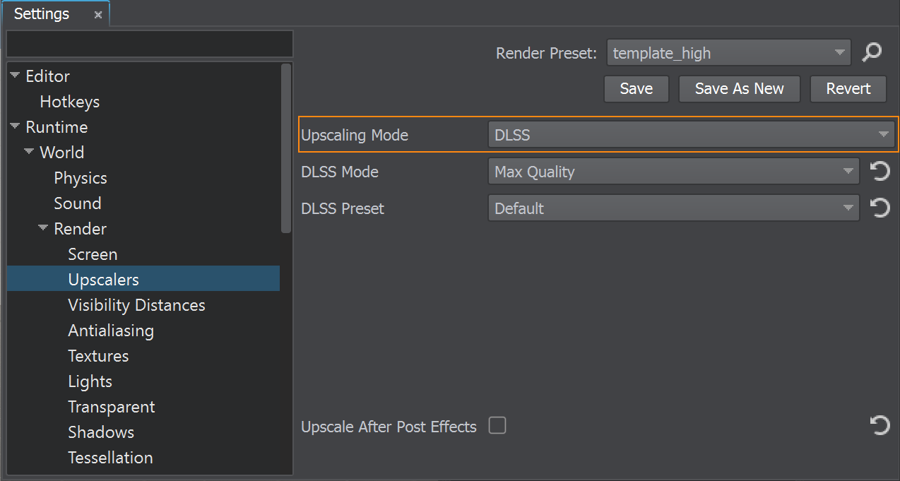

To use DLSS for the scene, enable it in one of the following ways and specify settings:要在场景中使用 DLSS,可通过以下方式之一启用并设置参数:
  • Via the UnigineEditor interface:通过 UnigineEditor 界面启用:
  • Using the render_upscale_mode console command:使用控制台命令 render_upscale_mode 启用:

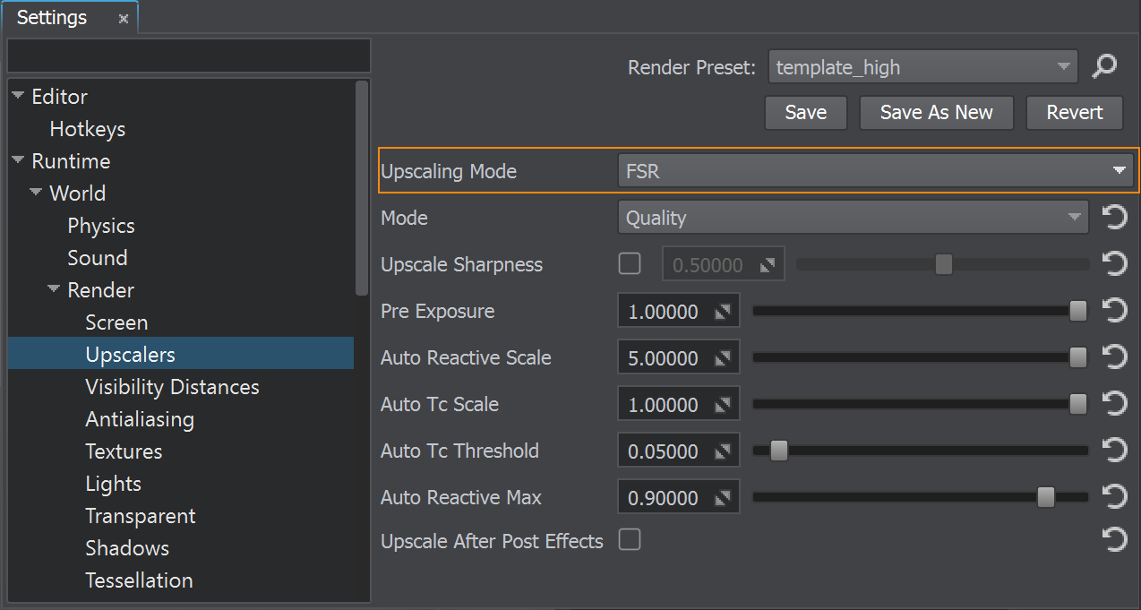

Using FSR 3
使用FSR 3#
Before applying FSR 3 upscaling, you should check if it is available. In UnigineEditor, open the console and check the information provided in the Render section:在应用FSR 3升级之前,您应该检查它是否可用。在UnigineEditor中,打开控制台并检查Render部分中提供的信息:
If FSR 3 is not available, the corresponding message will be shown in the console.如果FSR 3是不可用,相应的消息将显示在控制台中。
To use FSR 3 for the scene, enable it in one of the following ways and specify settings:要在场景中使用FSR 3,请通过以下方式之一启用它并指定设置:

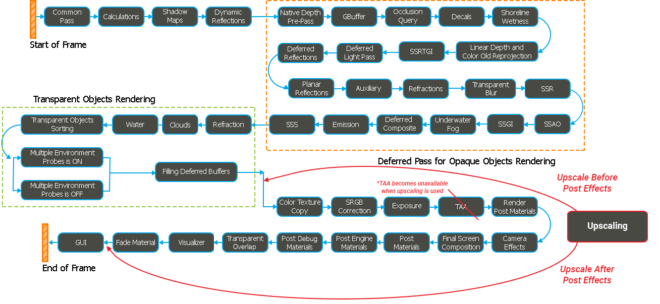

When to Apply Upscaling
何时申请升级#
By default, upscaling is applied before all post-processing effects are rendered. However, you can choose to apply upscaling after rendering the post-process effects.默认情况下,在渲染所有后处理效果之前应用放大。但是,您可以选择渲染后处理效果之后应用放大。
It can be done via the console using the render_upscale_post command or in UnigineEditor by toggling the Upscale After Post Effects parameter.它可以通过控制台使用render_upscale_post命令或在UnigineEditor中通过切换Upscale After Post Effects参数来完成。
