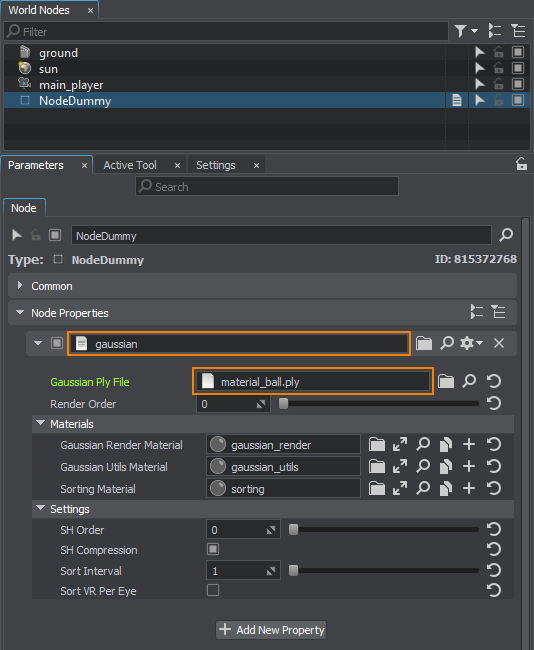

To add a Gaussian Splatting file to the scene, do the following:
  1. Create a Node Dummy and assign the gaussian property to it (this property is available in the project as a part of the plugin).
  2. In the property parameter Gaussian Ply File, assign the *.ply file that you want to render.
  3. Adjust other parameters, if necessary.

Gaussian Ply File The *.ply file containing 3D Gaussian splatting [3DGS] scene.
Render Order The order of rendering the 3DGS object. The object with the highest render order will be rendered last (on top of all other 3DGS objects).
Gaussian Render Material The material used for rendering the gaussians. It has a set of parameters that can be changed to adjust the look of the 3DGS render.
Gaussian Utils Material Utility material used to initialize Gaussian data and calculate distance from camera for each Gaussian splat.
Sorting Material Material used for Gaussian sorting based on their distance from the camera.
SH Order The spherical harmonics order used for rendering the gaussians, which determines the visual fidelity of the gaussians. The SH order equal to zero represents only the perspective-indepent base color, while higher orders encode more persective-dependent details, such as shininess, reflections, etc.
SH Compression Compressing the spherical harmonics data to improve VRAM usage efficiency.
Sort Interval Frame interval between sorting gaussian splats. Higher values can be set for a relatively static camera to save performance.
Sort VR Per Eye Enabling sorting for each eye in VR. If disabled, the Gaussian data will be sorted once and reused for the other eye.
