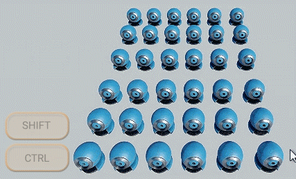

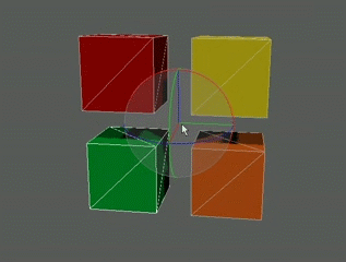

To select several nodes, do either of the following:选择多个节点,请执行以下任一操作:

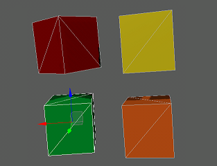

  • Use the selection box: click and hold the left mouse button, drag the mouse to select the required nodes. In this case, all surfaces of each mesh (if they exist) are selected.使用选择框:单击并按住鼠标左键,拖动鼠标选择需要的节点。在这种情况下,每个网格的所有表面(如果存在)都被选中。
    Select using Selection Box使用选择框选择
  • Select one of the nodes, press and hold Shift to add nodes to the selection and Ctrl to remove.选择其中一个节点,按住 Shift 将节点添加到选择中,按住 Ctrl 删除。
    Add and remove nodes from selection从选择中添加和删除节点

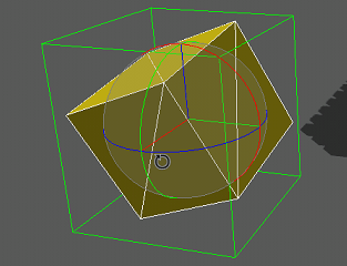

When the node is selected, the following is shown:选择节点后,显示如下:
  • Wireframe of the node节点的线框
  • Bounding box of the node节点的边界框
  • Bounding box of the selected surface (or surfaces)选定曲面(或曲面)的边界框

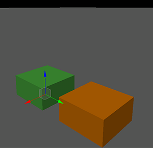

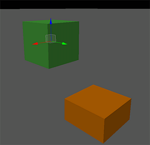

To move the node:移动节点:

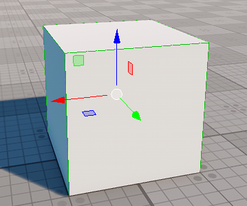

  1. Choose the manipulator on the Positioning panel (or press W).Positioning面板上选择 操纵器(或按 W)。
  2. Click the required node. The axes along which the node can be moved will be shown.单击所需的节点。将显示节点可以移动的轴。
    Move Node移动节点
  3. Move the node:移动节点:
    • If the arrow manipulator is dragged, the node can be moved along the selected axis.如果拖动箭头操纵器,则可以沿选定的轴移动节点。
    • If the rectangle manipulator is dragged, the node can be moved by two axes.如果拖动矩形操纵器,则可以将节点移动两个轴。
    • If the circle manipulator is dragged, the node can be moved in the screen plane.如果拖动圆形操纵器,则可以在屏幕平面中移动节点。
    Move along 1 axis沿 1 个轴移动
    Move by 2 axes移动 2 个轴
    Move in the screen plane在屏幕平面内移动

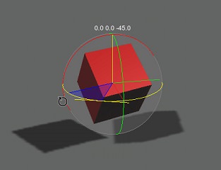

  3. Rotate the node:旋转节点:
    • If an axis of the sphere is dragged, the node is rotated around the axis.如果拖动球体的轴,则节点围绕轴旋转。
    • If the sphere is dragged, the node can be rotated freely around several axes.如果球体被拖动,节点可以围绕多个轴自由旋转。
    Rotate around 1 axis绕 1 轴旋转
    Rotate freely自由旋转

  2. Enable snapping by angle and specify the step for the rotation angle. Step can be set either by direct input of digits or using the box as a slider.使能够按角度捕捉并指定旋转角度的步长。可以通过直接输入数字或使用框作为滑块来设置步长。
    If snapping by angle is disabled, the node is rotated by 20 degrees.如果按角度捕捉禁用时,节点旋转 20 度。
  3. Select the node you want to rotate in the viewport. Rotate the node by using the arrow keys. The direction of rotation is projection-dependent. 在视口中选择要旋转的节点。使用箭头键旋转节点。旋转方向取决于投影。

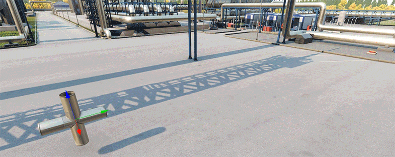

To clone a node:克隆节点:
  1. Select the node.选择节点。
  2. Press Ctrl+D (or Edit -> Clone).Ctrl+D(或 Edit -> Clone)。
    The cloned node will have the same position as the source node.克隆的节点将与源节点具有相同的位置。
To clone and transform a node:克隆和转换节点:
  2. Choose , , or on the Positioning panel (or press W, E, or R).定位面板上选择 (或按 W, ER)。
  3. Press and hold Shift and transform the node.按住 Shift 并变换节点。
  4. Press Shift + D as many times as required (or press and hold this combination) to create more clones. Every next clone will use the last applied transformation.根据需要多次按 Shift + D(或按住此组合)以创建更多克隆。每个下一个克隆都将使用最后应用的转换。

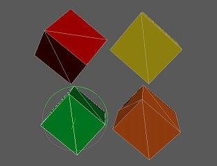

  • If you select several nodes, set the pivot point toggle to Center, and rotate these nodes, they rotate around the center of selection as follows:如果选择多个节点,将枢轴点切换设置为 Center,然后旋转这些节点,它们将围绕选择中心旋转,如下所示:
    Pivot point in the center of selection选择中心的枢轴点

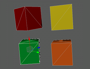

  • If you set the pivot point toggle to Pivot and rotate the selected nodes, each node will rotate around its center as follows:如果将枢轴点切换设置为 Pivot 并旋转选定节点,则每个节点将围绕其中心旋转,如下所示:
    Pivot point coincides with the center of the last selected node枢轴点与最后一个选定节点的中心重合

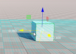

    • If one axis is chosen (the arrow manipulator is dragged), the node is aligned along the axis.如果选择一个轴(拖动箭头操纵器),则节点沿轴对齐。
    • If a node is repositioned by two axes (the rectangle manipulator is dragged), the node will be aligned by a horizontal or vertical grid.如果一个节点被两个轴重新定位(矩形操纵器被拖动),该节点将通过水平或垂直网格对齐。
    Snapping by an axis按轴捕捉

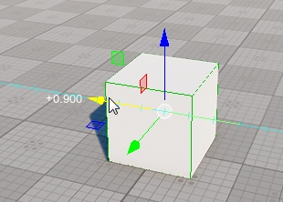

    Rotation by 45 degrees旋转 45 度

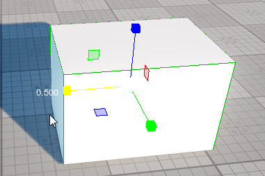

Snapping Nodes by Scale
按比例捕捉节点#
Snap by Scale allows scaling a node along the axis with a given step.Snap by Scale 允许以给定的step沿轴缩放节点。
Snapping should be enabled when scaling the node by using arrow keys.使用缩放节点时应启用捕捉方向键.
To snap a node by scale:要按比例捕捉节点:
  1. Choose on the Positioning panel.定位面板上选择
  2. Specify the step for the scale factor using the following drop-down box:使用以下下拉框指定比例因子的步长
    Step can be set either by direct input of digits or using the box as a slider.可以通过直接输入数字或使用框作为滑块来设置步长。
    Now you can scale any node in the world along the axis with the given step.现在,您可以使用给定的步长沿轴缩放世界上的任何节点。
  3. Scale the node.规模节点。
    Scaling by step 0.5按步长 0.5 缩放
You can use the Ctrl button to invert snapping controls (Grid, Angle, and Scale).您可以使用 Ctrl 按钮来反转捕捉控件(网格、角度和比例)。

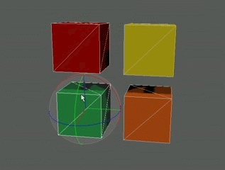

Snapping Nodes to Surface
将节点捕捉到曲面#
Snapping a node to a surface of another node provides pixel-perfect positioning of the nodes relative to each other.将一个节点捕捉到另一个节点的表面提供了节点相对于彼此的像素完美定位。
To snap a node to the surface:要将节点捕捉到曲面:
  1. Select a node that should be snapped.选择一个应该被捕捉的节点。
  2. Choose on the Positioning panel (or press Alt+W).定位面板上选择 (或按 Alt+W)。
  3. Specify snapping settings via the following panel:通过以下面板指定捕捉设置:
    Option Description
    Offset from Surface
    Specifies the distance from the node's pivot point to the surface (in units).指定到节点的距离中心点到表面(以单位为单位)。
    • To increase/decrease the distance to the surface, use the WHEEL UP/WHEEL DOWN hotkeys.要增加/减少到表面的距离,请使用WHEEL UP/WHEEL DOWN热键。
    • To reset the distance to the surface, use the MIDDLE CLICK hotkey.要重置到表面的距离,请使用MIDDLE CLICK热键。

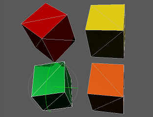

    Orient by Normal
    Specifies whether the node should be oriented by the surface normal.指定节点是否应按曲面法线定向。
    The hotkey is RIGHT MOUSE BUTTON.热键是鼠标右键

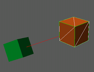

    Take Intersection Into Account If enabled, the node interacts only with the surfaces that have the Intersection option enabled.如果启用,节点只与启用了Intersection选项的曲面交互。
  4. Move the node until the red stripe intersects the required surface of the other node. Click the left mouse button to place the node.移动节点,直到红色条纹与另一个节点的所需表面相交。单击鼠标左键放置节点。
    To abort placement, press ESC.要中止放置,请按 ESC
The node will follow the mouse as on the image below:该节点将跟随鼠标,如下图所示:
Node is oriented by normalNode is oriented by normal
Node is not oriented by normalNode is not oriented by normal
Node is oriented by normalNode is not oriented by normal
Node is oriented by normal节点按法线定向
Node is not oriented by normal节点不是正常定向的

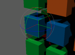

Dropping Nodes to Ground
将节点落地#
Dropping a node to the ground means positioning a selected node to the surface below or above this node.将节点放到地面意味着将选定节点定位到该节点下方或上方的表面。
To drop a node to the surface:要将节点拖放到表面:
  1. Select a node (or several nodes) that should be dropped.选择应该删除的一个节点(或几个节点)。
  2. On the Positioning panel, find and specify the required settings in the drop-down window:Positioning面板上,找到 并在下拉窗口中指定所需的设置:
    Option Description
    Direction
    Specifies the direction of dropping:指定下降方向:
    • Up — find the closest surface above the object. Up — 找到物体上方最近的表面。
    • Down — find the closest surface below the object. Down — 找到物体下方最近的表面。
    • Up And Down — find the closest surface below the object and above it. Up And Down — 找到物体下方和上方最近的表面。
    Offset from Surface Specifies the distance from the node's pivot point to the surface (in units).指定到节点的距离中心点到表面(以单位为单位)。
    Orient by Normal Specifies whether the node should be oriented by the surface normal.指定节点是否应按表面法线定向。
    Intersection Mask
    Sets an intersection mask that defines whether a node (or nodes) will be positioned on a surface to which it is dropped.设置一个交叉口掩码它定义了一个节点(或多个节点)是否将被放置在它被放置到的表面上。
    A node will be positioned on a surface if they both have matching intersection masks. Otherwise, the node will penetrate the surface.如果它们都具有匹配的交叉掩码,则节点将被定位在表面上。否则,节点将穿透表面。
  3. Click to drop a node (nodes).单击 以删除一个节点(节点)。
    Initial position of a node节点的初始位置
    Node dropped to surface (default settings)节点下降到表面(默认设置)
