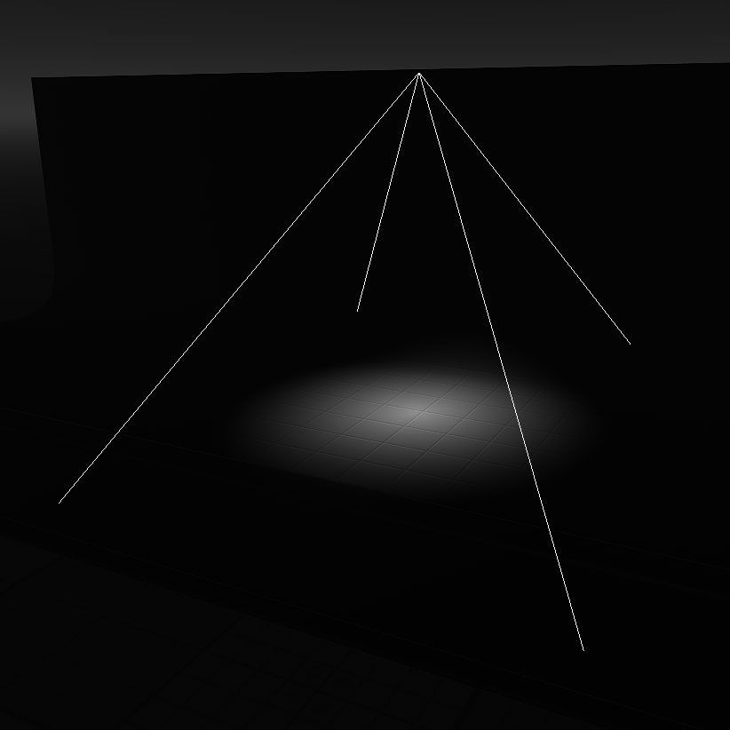

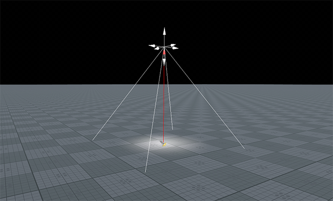

Light Projected is a light source that casts light from a single point forming a focused beam aimed in a specific direction. This type of light is visualized in a form of a pyramid. Due to its form, it is versatile and can be conveniently used to simulate the numerous light emitting sources: for example, car headlights, flash light, or street lamps.Light Projected是一个光源,该光源从单个点投射光线,从而形成聚焦在特定方向的聚焦光束。这种类型的光以金字塔的形式可视化。由于其形式,它是通用的,可以方便地用于模拟多种发光源:例如汽车前灯,闪光灯或路灯。
Light Projected can produce shadows of accurate perspective projection. They require only a single rendering pass and are performance-cheap if compared to World Light and Omni Light.Light Projected可以产生精确透视投影的阴影。与World LightOmni Light相比,它们仅需要一次渲染通道,并且性能低廉。

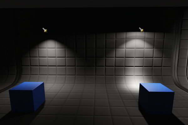

As the Light Projected can have different shapes, it can be used to create area lights.由于Light Projected可以有不同的形状,可用于创建区域照明
Example scene that uses Light Projected使用Light Projected的示例场景

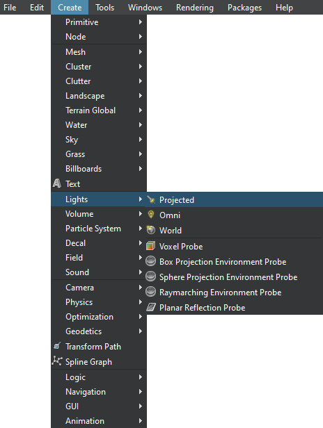

To add Light Projected, do the following:要添加Light Projected,请执行以下操作:
  1. On the Menu bar, click Create -> Light -> Projected在菜单栏上,单击Create -> Light -> Projected
  2. Place the light somewhere in the world.将灯光放置在世界上的某个地方。

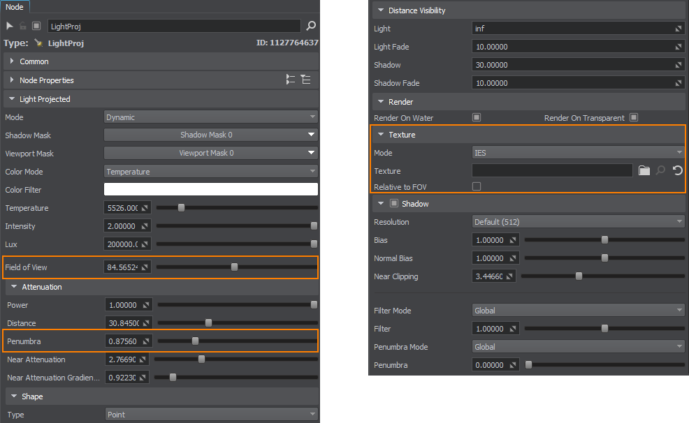

Parameters of Light Projected can be adjusted in the Node tab of the Parameters window. It contains both the common parameters and the parameters specific for Light Projected source. The specific ones are described below.可以在Parameters窗口的Node选项卡中调整Light Projected的参数。它既包含常用参数以及特定于Light Projected源的参数。具体描述如下。

Field of view
A field of view of Light Projected. This parameter defines the angle of the light clipping in range from 1 (only a very narrow segment is illuminated) to 175 degrees (the whole hemisphere is lit).Light Projected的视场。此参数在1(仅照亮非常狭窄的部分)到175度(照亮整个半球)的范围内定义了削光的角度。

Mode
The type of texture used to define light distribution:用于定义光分布的纹理类型:
  • IES — light distibution is defined by the IES profile, a lighting industry standard of describing how the light is cast based on real-world measured light fixtures.IES —灯光分布由IES配置文件定义,IES配置文件是一种照明行业标准,用于描述基于实际测量的灯具来投射光线的方式。

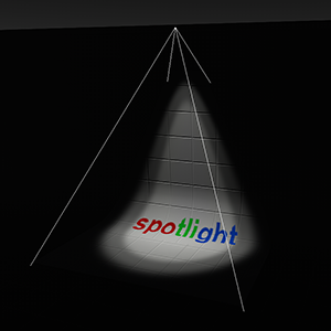

  • Simple — an arbitrary 2D texture is projected onto the scene. All the surfaces receiving the formed light pattern are redrawn in additional rendering pass, this is required because of manipulations with texture matrix.Simple —将任意2D纹理投影到场景上。所有接收到已形成光图案的表面都将在其他渲染过程中重新绘制,这是必需的,因为需要使用纹理矩阵进行操作。
    1st texture projected投影第一个纹理
    2nd texture projected投影第二纹理
Texture A simple or IES texture projected by Light Projected.Light Projected投射的简单或IES纹理。
Relative to FOV
The IES texture rendering mode:IES纹理渲染模式:
  • Disabled — the unchanged IES texture is clipped by the light source's Field of View.禁用-不变的IES纹理被光源的视场
  • Enabled — the IES texture is scaled to fit within the light source's Field of View.启用-IES纹理被缩放以适合光源的“视场”。

Penumbra
A light penumbra is used to simulate edge gradual falloff. This parameter determines how fast the intensity decreases from the center of spot to the non-illuminated areas border.淡半影用于模拟边缘逐渐衰减。此参数确定强度从光点中心到非照明区域边界的降低速度。
  • If the attenuation power is set to 0 or close to it, the edge between illuminated and non-illuminated areas will be sharp.如果将衰减功率设置为0或接近0,则照明区域和非照明区域之间的边缘将很锐利。
  • Increasing the value up will render softly dispersed light at the non-illuminated areas border.增大该值将在非照明区域边界处呈现柔和分散的光线。
