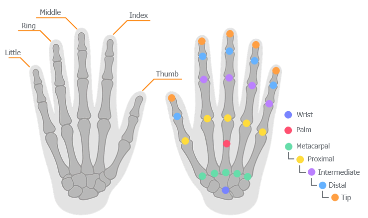

Hand Hierarchy
手部骨骼层级#
All hand tracking data is spatially relative to the main camera (i.e. the player's HMD - head-mounted display). This means that hand positions follow the headset, when the user moves or rotates their head, the hands move accordingly in the same local tracking space. They are not positioned in world space independently of the HMD.所有手部追踪数据在空间上都相对于主摄像机(即玩家的HMD--头戴显示器)定位。这意味着手部位置会跟随头显移动,当用户移动或旋转头部时,手部会在同一局部追踪空间中相应移动。它们并非独立于HMD的世界空间定位。
In the OpenXR Specification, tracked hand elements are referred to as joints. In UNIGINE, these elements are called bones, consistent with the VRBone class used in API. Conceptually, each bone corresponds to a tracked joint defined by XR_EXT_hand_tracking.在OpenXR规范中,被追踪的手部元素称为关节(joints)。在UNIGINE中,这些元素称为骨骼(bones),与API中使用的VRBone类保持一致。从概念上讲,每个骨骼对应XR_EXT_hand_tracking定义的一个被追踪关节。
Each hand's skeletal model consists of 26 bones organized in a hierarchy under a single root. The bones include the Wrist, Palm, and Finger bones for all five fingers (thumb, index, middle, ring, little). The finger bones, except the tips, are named after the corresponding bone at the further end of the bone from the fingertips.每只手的骨骼模型由26块骨骼组成,这些骨骼在单一根节点下按层级排列。骨骼包括腕部(Wrist)、手掌(Palm)以及五根手指(拇指、食指、中指、无名指、小指)的指骨。除指尖外,其他指骨均以远离指尖方向的相应骨骼命名。
The Wrist is considered as the root of the hierarchy for the hand - it's the point where the hand would connect to the forearm. Under the Wrist, all finger bones are arranged.腕部被视为手部层级的根节点——这是手部与前臂连接的部位。所有指骨都排列在腕部下方。
The Palm bone is located at the center of the middle finger's metacarpal bone, representing a convenient central point (the middle of the palm area), which can be useful for certain calculations or attaching objects to the user's hand.手掌骨骼位于中指掌骨中心,代表一个便利的中心点(手掌中部区域),可用于特定计算或将物体附着到用户手上。
Unlike the other fingers, the thumb lacks an intermediate phalanx, resulting in one less bone - just like in a real human hand.与其他手指不同,拇指缺少中间指节,因此少一块骨骼——这与真人手部结构一致。
The bone structure in the native OpenXR system differs from that used in the Ultraleap plugin.原生OpenXR系统的骨骼结构与Ultraleap插件使用的结构不同。

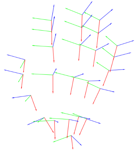

Coordinate System Orientation
坐标系方向#
All the hand tracking data is given in UNIGINE’s native coordinate system, which is a right-handed Cartesian coordinate system: X and Y form a horizontal plane, Z axis points up. When looking at a hand from the back (palm facing downward), the axes of each bone are aligned as follows:所有手部追踪数据都采用UNIGINE原生坐标系,这是一个右手笛卡尔坐标系:X和Y轴构成水平面,Z轴指向上方。当从手背观察(掌心朝下)时,每块骨骼的轴对齐如下:
  • X-axis points to the leftX轴指向左侧
  • Y-axis points backwards, along the wristY轴沿腕部向后指向
  • Z-axis points upward, out of the back of the handZ轴向上方伸出,垂直于手背
This consistent basis orientation applies to all bones in the hand.这种统一的基准方向适用于手部所有骨骼。
