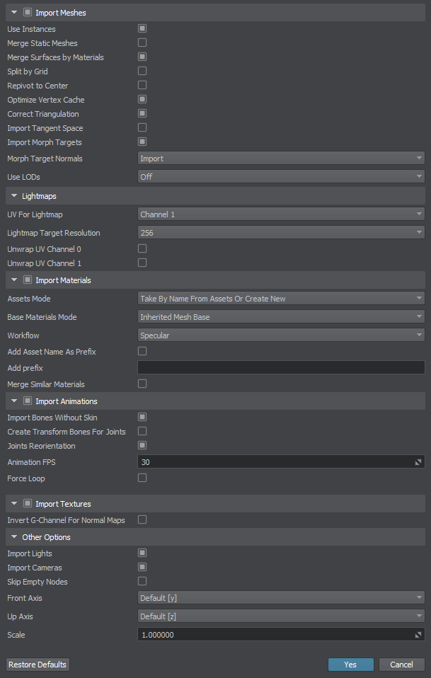

When you import an FBX asset (just like importing any other asset), the import settings window appears:导入FBX资源时(就像进口任何其他资源),出现导入设置窗口:
To simplify sequential import of multiple similar assets, Asset Browser remembers previous asset import settings and offers to use them by default. To reset import settings to system defaults use the Restore Defaults button.为了简化多个相似资源的顺序导入,Asset Browser会记住以前的资源导入设置,并默认提供使用它们的功能。要将导入设置重置为系统默认值,请使用Restore Defaults按钮。

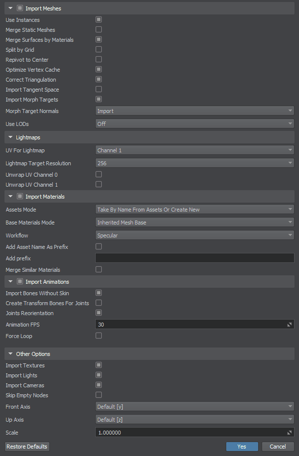

The list of available import options covers all components that can be imported from an FBX scene and includes the following:可用的导入选项列表涵盖了可以从FBX场景导入的所有组件,包括以下内容:
Mesh Import Options
网格导入选项#
Import Meshes Import geometry meshes from the file.从文件导入几何体网格。
Use Instances Imports FBX with mesh instances. When enabled, a single mesh is imported instead of several identical ones. If you add such FBX to the scene, all meshes in the World Hierarchy will refer to the single mesh stored inside the imported FBX container.导入带有网格物体实例的FBX。启用后,将导入单个网格,而不是多个相同的网格。如果将此类FBX添加到场景中,则“世界层次”中的所有网格都将引用存储在导入的FBX容器内的单个网格。
Merge Static Meshes Merges all of the children static meshes into a single one (named after the parent mesh). All surfaces of all meshes surfaces will be copied and shown in the Surfaces hierarchy.将所有子静态网格物体合并为一个(以父网格物体命名)。所有网格曲面的所有曲面都将被复制并显示在Surfaces层次结构中。
Merge Surfaces by Materials Enables merging surfaces that have the same materials.启用具有相同材质的合并曲面。

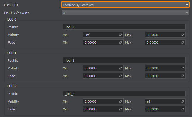

  2. Select the number of LODs that are stored in the FBX container.选择存储在FBX容器中的LOD数量。
  3. For each LOD, define a postfix that will be used to group objects in an FBX file into a corresponding LOD.对于每个LOD,定义一个后缀,该后缀将用于将FBX文件中的对象分组为相应的LOD。
    The postfix must be the same as the one used when creating objects in a 3D editor.后缀必须与在3D编辑器中创建对象时使用的后缀相同。
    The names of generated surfaces will be as follows: material_name + LOD_postfix.生成的曲面的名称如下:material_name + LOD_postfix
  4. Specify the minimum and maximum visibility and fade distances for each LOD.指定每个LOD的最小可见距离。每个LOD的最大可见距离等于下一个LOD的最小可见距离。最后一个LOD的最大可见距离等于inf

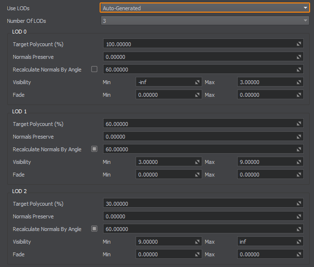

Automatic LOD Generation feature based on the meshoptimizer library will help in case you only have a high-poly model, saving you a lot of time on preparing levels of detail manually.自动 LOD 生成功能基于meshoptimizer 库将在您只有一个高多边形模型的情况下提供帮助,从而为您节省大量手动准备细节级别的时间。
To use the feature choose Auto-Generated in the Use LODs dropdown and configure the settings listed below - the Engine will do the rest, generating all LODs automatically based on your configuration.要使用该功能,请在 Use LODs 下拉列表中选择 Auto-Generated 并配置下面列出的设置 - 引擎将完成剩下的工作,并根据您的配置自动生成所有 LOD。
Max LODs Count Number of Levels of Detail.Number of Levels of Detail.详细级别数。
Target Polycount
Desired degree of geometry simplification for each LOD (target geometry complexity percentage from the initial number of polygons).每个LOD所需的几何简化程度(目标几何复杂度与初始多边形数量的百分比)。
Please keep in mind that this is only a target value, that in some cases may be unreachable for the mesh simplifier. In case any artefacts with the topology of the simplified meshes occur, try increasing this value.请记住,这只是一个目标值,在某些情况下,网格简化器可能无法达到。如果出现任何具有简化网格拓扑的伪影,请尝试增加此值。
Normals Preserve This parameter indicates the impact of normals on mesh topology simplification. Higher values increase the influence of normals, by the value of 0 normals are ignored. Avoid setting too high values as this may restrict simplifier too much and simplification will fail (as normals may differ significantly). Default setting is suitable for most cases.该参数表示法线对网格拓扑简化的影响。较高的值会增加法线的影响,0 的值会忽略法线。避免设置太高的值,因为这可能会过多地限制简化器并且简化将失败(因为法线可能会有很大差异)。默认设置适用于大多数情况。
Recalculate Normals by Angle Enables recalculation of normals in the process of mesh simplification based on the specified angle threshold. If an angle between the normals to adjacent polygons exceeds this value, normals will be recalculated between them to smoothen the look of the geometry and get rid of possible shading issues.启用基于指定角度阈值的网格简化过程中的法线重新计算。如果相邻多边形的法线之间的角度超过此值,则将在它们之间重新计算法线以平滑几何体的外观并消除可能的阴影问题。
Visibility / Fade Distances
See their description above.请参阅上面的描述。

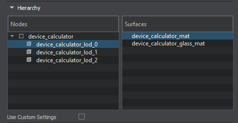

This auxiliary section is available in the Parameters window when selecting an imported FBX asset in the Asset Browser. It enables you to preview the content of the FBX asset according to the current Mesh Import Options.在资源浏览器中选择导入的FBX资源时,该辅助部分可在Parameters窗口中使用。它使您可以根据当前预览FBX资源的内容。网格导入选项
Nodes List of nodes obtained from the FBX asset.从FBX资源获得的节点列表。
Surfaces List of surfaces of the selected node.所选节点的曲面列表。
Use Custom Settings Enables custom Lightmaps options for the selected surface(s).启用自定义光照贴图选定表面的选项。

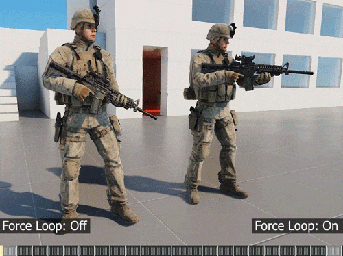

Force Loop
Forced smoothing of looped animation playback.强制平滑循环动画的播放。
Looped Frames Number of frames to be used for smoothing of looped animation playback. The specified number of frames is taken from the beginning and from the end of the animation. If the specified value exceeds the (total_number_of_frames)/2, the latter is used instead.用于平滑循环播放动画的帧数。指定的帧数是从动画的开头和结尾开始获取的。如果指定的值超过(total_number_of_frames)/2,则使用后者。

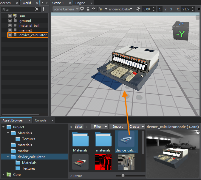

To import 3D geometry data contained in an FBX scene, you should enable the Import Meshes option.要导入FBX场景中包含的3D几何数据,应启用Import Meshes选项。
Imported geometry (same as any object in the scene) after being added to the world, becomes a node and can be seen in the World Hierarchy window. This node will have the same name as the imported FBX asset and a hierarchy of child nodes representing the hierarchy of static meshes contained in the imported scene. 导入的几何图形(与场景中的任何对象相同)在添加到世界后变为节点并可以在World Hierarchy窗口中看到。该节点的名称与导入的FBX资源的名称相同,子节点的层次结构表示包含在导入场景中的静态网格物体的层次结构。
You can combine all child objects into a single one by enabling the Merge Static Meshes option. In this case, all surfaces of child meshes will be copied to the single parent mesh and will appear in its Surfaces hierarchy.您可以通过启用Merge Static Meshes选项将所有子对象合并为一个。在这种情况下,子网格物体的所有表面将被复制到单个父网格物体,并将出现在其Surfaces层次结构中。

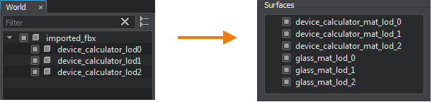

Surfaces of a single mesh generated instead of separate meshes with device_calculator and glass_mat materials assigned生成单个网格的表面,而不是分配了device_calculatorglass_mat材质的单独网格

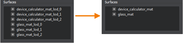

You can also merge the surfaces having the same material assigned by enabling the Merge Surfaces by Materials option.您也可以通过启用Merge Surfaces by Materials选项合并具有相同材质的曲面。
Surfaces merged by materials材质合并的表面

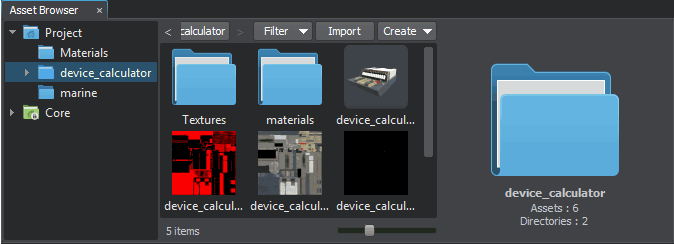

To import materials from an FBX container, you should enable the Import Materials option. In this case, the surfaces of the imported model will have the corresponding materials assigned.要从FBX容器导入材质,应启用Import Materials选项。在这种情况下,将为导入的模型的曲面分配相应的材质。
If materials are imported, the material assets are created in the materials subfolder of the folder where the .fbx asset is stored.如果材质是进口的,则该材质资源在存储.fbx资源的文件夹的materials子文件夹中创建。

When the Import Materials option is disabled, all surfaces of the model will have the default mesh_base material assigned. 禁用Import Materials选项时,将为模型的所有曲面分配默认的mesh_base材质。
When importing materials, you might have a situation when a material with a given name already exists in the project. You can choose whether to overwrite existing materials (the corresponding assets will be overwritten) or not. For this purpose, the Overwrite Existing Materials option is used. When unchecked, existing materials will be used.导入材质时,项目中可能已经存在具有给定名称的材质。您可以选择是否覆盖现有材质(对应的资源将被覆盖)。为此,使用了Overwrite Existing Materials选项。如果未选中,则将使用现有材质。
In case when a source model contains lots of objects with many identical materials that just have different names (often happens when an FBX file was exported from a CAD system), it makes sense to combine such materials into a single one. To do so, you should enable the Merge Similar Materials option.如果源模型包含许多具有许多相同材质但名称不同的对象(通常是从FBX文件中导出FBX文件时发生的)电脑辅助设计系统),将这些材质合并为一个材质是有意义的。为此,您应该启用Merge Similar Materials选项。
UNIGINE支持两种PBR材质工作流程:MetalnessSpecular。使用Workflow选项设置所需的工作流程。

When reading the materials data, you are also able to import textures stored in an FBX container. To do so, enable the Import Textures option.读取材质数据时,您还可以导入存储在FBX容器中的纹理。为此,启用Import Textures选项。
If textures are imported, the corresponding texture assets are created in the same folder, where the .fbx asset is stored.如果导入纹理,则对应的纹理资源在存储.fbx资源的同一文件夹中创建。

You can import skeletal animations and morph targets from an FBX file.您可以从FBX文件导入骨骼动画和变形目标。
To import animations from an FBX container:要从FBX容器导入动画,请执行以下操作:
To import morph targets just enable the Import Morph Targets option. Morph targets will be imported as child nodes.要导入变形目标,只需启用Import Morph Targets选项。变形目标将作为子节点导入。
If you have an FBX file containing skeletal animation without any geometry, you can import it to your UNIGINE project via the Import Bones Without Skin and use generated .anim files.如果您有一个FBX文件,其中包含没有任何几何图形的骨骼动画,则可以通过Import Bones Without Skin将其导入到UNIGINE项目中,并使用生成的.anim文件。
Lights
You can import light sources from an FBX scene (if any) by simply enabling the Import Lights option. Imported light sources will be added as child nodes to the root node. The following conversion will be performed:您可以通过简单地启用Import Lights选项从FBX场景导入光源(如果有)。导入的光源将作为子节点添加到根节点。将执行以下转换:

Cameras can also be imported from an FBX scene (if they exist) by simply enabling the Import Cameras option. They are converted into PlayerDummy (cameras without physical properties). Both types of projection are supported in UNIGINE:只需启用Import Cameras选项,也可以从FBX场景导入摄像机(如果存在)。它们被转换为PlayerDummy(没有物理属性的相机)。 UNIGINE支持两种类型的投影:

To add a new imported FBX asset to the scene, as any other asset, simply drag it from the Asset Browser to the Viewport window. The corresponding node will be created and displayed in the World Hierarchy window. This node will have the same name as the imported FBX asset and a hierarchy of child nodes representing separate objects contained in the 3D model.要将新导入的FBX资源与其他资源一样添加到场景中,只需将其从Asset Browser拖动到Viewport窗口即可。相应的节点将被创建并显示在World Hierarchy窗口中。该节点的名称与导入的FBX资源的名称相同,并且子节点的层次结构代表3D模型中包含的单独对象。
Non-native geometry asset types (fbx, obj, dae, etc.) are containers for meshes. If you double-click such asset in the Asset Browser (or use the right-click Open command), the generated runtime .mesh, .anim and .node files stored in the container asset will be displayed:非本机几何图形资源类型(fbx, obj, dae等)是网格的容器。如果您在Asset Browser中双击此类资源(或使用右键单击Open命令),则生成的运行时将显示存储在容器资源中的.mesh, .anim.node文件:
