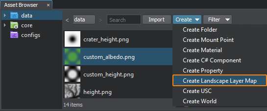

  4. Select Create -> Create Landscape Layer Map in the Asset Browser.Asset Browser中选择Create -> Create Landscape Layer Map
  5. Enter a name for the layer map: crater.输入层地图的名称:crater

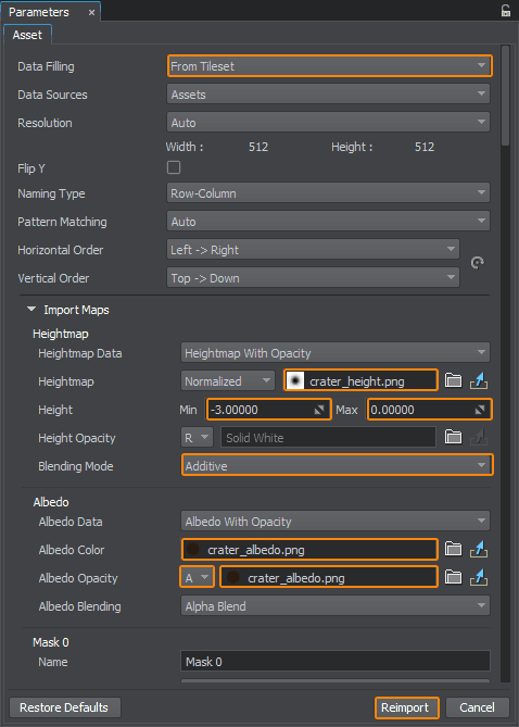

  6. Select your new crater.lmap asset and adjust its settings as shown below (assign our images, select blending mode and adjust heights range for the crater).选择你的新的crater.lmap资源,并调整其设置如下所示(分配我们的图像,选择混合模式和调整火山口的高度范围)。
  7. Click Reimport and process to the Code section below.单击Reimport并处理到下面的 Code部分。
