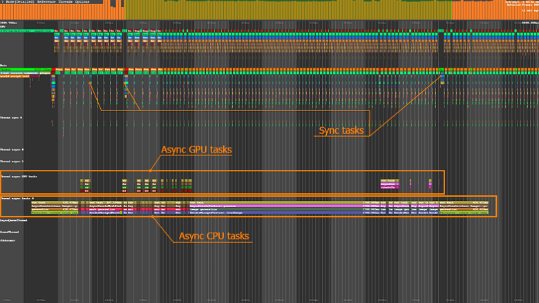

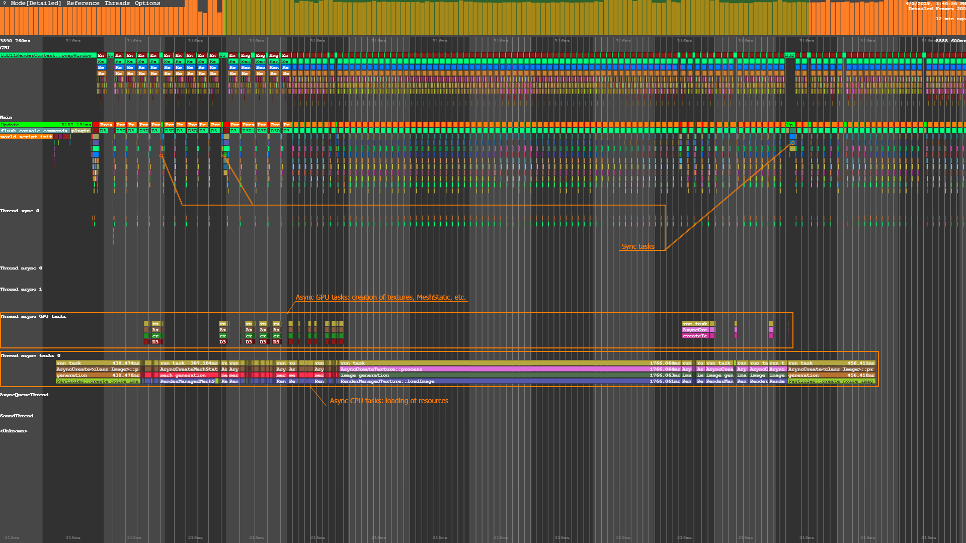

Resource loading is performed and transferred to the GPU in separate asynchronous threads. After that, resources are synchronized and added to the virtual scene on the CPU side.在单独的异步线程中执行资源加载并将其传输到GPU。之后,资源被同步并添加到CPU侧的虚拟场景中。
The output of the Microprofile tool.Microprofile工具的输出

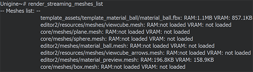

It is also possible to print the list of loaded resources and detailed information on them by using the render_streaming_meshes_list and render_streaming_textures_list console commands.还可以通过使用render_streaming_meshes_listrender_streaming_textures_list控制台命令输出已加载资源的列表和有关它们的详细信息。
The render_streaming_meshes_list output.render_streaming_meshes_list输出
