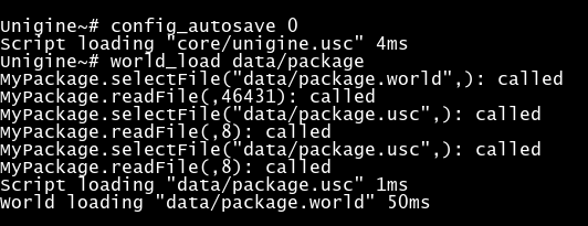

Output#
The following result will be shown in the console:
