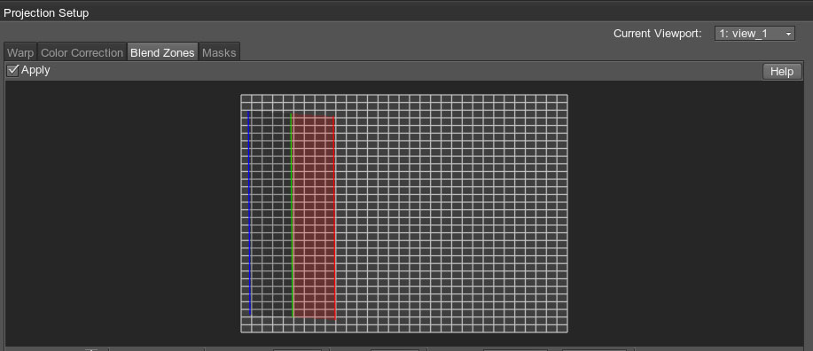

This class stores data on all blend zones created for the viewport and provides the interface for configuring each blend zone.
The blend zone is an arbitrary shape formed by three vertical lines so that it has two parts — one part is a mask (from blue to green line), and the other one (from green to red line) is a gradient zone.
The blend zone data are stored in the configuration file.
To configure parameters of a specific blend zone of a viewport, the methods of this class are to be used. However, the instance of the BlendZonesData class doesn't store any information on which viewport it is assigned to — the information is stored in the ViewportData class instance.
