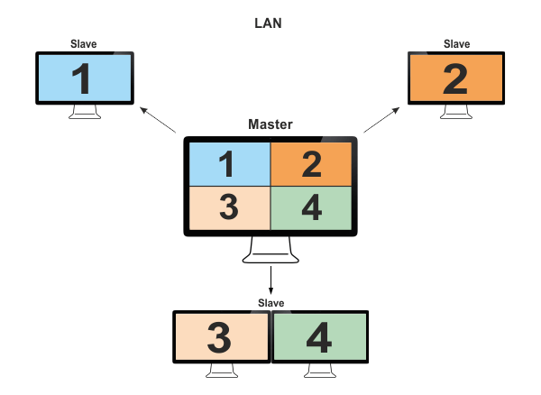

Simply connect multiple computers into one high-resolution seamless display using LAN. And it does not matter if these computers are running on Windows and Linux at the same time, as Syncker works even across different platforms. Moreover, created virtual environments can have any monitor configuration, since all viewports are fully configurable and multi-monitor grids on Slave computers are supported.
Syncker
Computers in LAN connected via Syncker

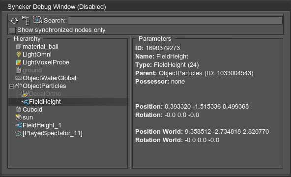

  • Objects of the following types are synchronized automatically: ObjectWaterGlobal, ObjectCloudLayer, ObjectParticles, WorldLight, if they are present in the *.world file on all computers.
  • Animations are updated on the Master computer, while Slave apps only get calculated bone transformations.
  • Particle systems are updated on Slave but according to parameters received from Master.
  • Physics simulation in Slave applications should be disabled not to override position and orientation of nodes sent over the network from a Master.

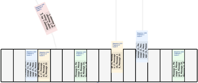

For sending and receiving messages between Master and Slave, Syncker uses a single UDP socket with the following five technologies:
  • Reliable — guarantees packet delivery using the so-called acknowledge packets. When Master sends a message, Slave reports that the message is received. In case Slave does not reply in a certain period of time, Master tries to re-send the message.
  • Sequenced — guarantees that all packets are received in the right order, finding all duplicates. Each packet has a number and until Slave receives the packet, Master shall not send next ones to it (with greater numbers).

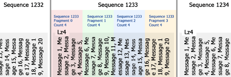

  • Merged — small messages are combined into a greater one instead of sending them all one right after the other (send a single 100-bytes packet rather than sending 10 packets 10-bytes each). This makes sending acknowledge packets to the sender simpler and faster.
  • Fragmented — a large message exceeding the MTU size (Maximum Transmission Unit), shall be split into several packets having the MTU size. This ensures delivery of all packets protecting Slave from buffer overflow caused by a single large packet.
  • Compressed — all messages are compressed using the LZ4 algorithm before sending. This reduced network load, but slightly increases the load on the computer itself.
So, here's how the packets are delivered:
  1. During the frame up to the Data Sync Point, Master prepares messages for sending and places them to a queue. This "big message" is compressed, split into parts according to the MTU size, wrapped into packets with the following three numbers specified for each of them: sequence number (packet group), fragment number, and total number of fragments in this sequence.
  2. The packets are sent.
  3. Upon receiving any of the packets, Slave changes the size of its sliding window in accordance with the number of fragments and adds the received fragment to this window.
  4. In case of missing/lost packets, Slave adds the corresponding information on the missing part it requests to be sent again to the acknowledge packet dispatched to Master.

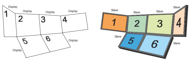

Two types of configuration can be used:
  • A multi-monitor setup formed by displays, where each Slave renders its viewport on the corresponding monitor (or several monitors).
    Projection and modelview matrices are automatically calculated on the basis of the viewer's position.
    The following picture shows the screen configuration for the multi-monitor setup, where each Slave renders its viewport to a single monitor.
    Screen Configuration (the left picture) for Multi-Monitor Setup (the right picture)

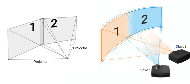

  • A multi-projector setup formed by projectors, where each Slave renders its viewport via the corresponding projector. By default, the projectors display images as seen from the viewer's position.
    Projector Configuration (the left picture) for Multi-Projector Setup (the right picture)

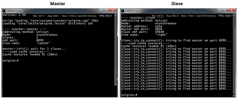

Let us consider Syncker running using broadcast addressing with Master and a single Slave:
  1. After being launched, Master opens the port (-sync_port), and starts listening to it. Syncker status is switched to "Wait for connections".
  2. Slave gets the list of all available network adapters (Wifi, Ethernet), finds a broadcast address for each of them, and periodically sends connection request packets (broadcast mode). The Syncker status is "Wait for connections".
  3. Master receives the connection request packet, registers Slave and sends a connection response packet (unicast mode), where it indicates the currently loaded world. When all Slave PCs are connected, the Syncker status is switched to "Starting..." and Master sends projection settings to all of them.
  4. As soon as Slave receives the confirmation from Master the status is switched to "Starting..." and starts loading the world from Master.

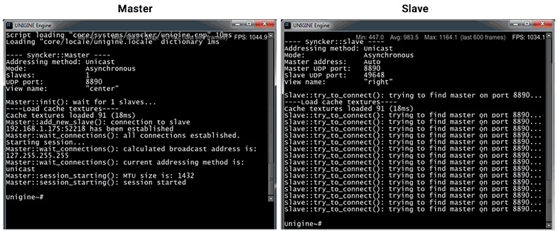

  5. While the Syncker status remains "Starting...", both Master and Slave are trying to find the maximum possible MTU value (currently limited to 1432 bytes).
  6. Upon completion Slave sends a message to Master that it is ready to continue. After receiving such messages from all Slave PCs (and finding an MTU for each Slave), Master changes the status to "Session Started" notifying all hosts.
  7. The session has started, everything is ready for work.

Debug Window#
Syncker's debug window enables you to monitor the hierarchy of objects at run time. The whole hierarchy means all objects (not only the ones registered in the Editor) including objects in cache, internal structure of node references, etc. When a node is selected, all necessary debug information is displayed. This information is updated each frame.
The Search option allows you to find any node by its name or ID (on Master or Slave), so a faulty node can be found quickly.
To open the debug window, run the syncker_debug console command from Master or Slave as follows:
Source code
syncker_debug 1
The debug window can also be opened via the System Menu:
  1. Open the System Menu by pressing Esc.
  2. Enable the Show debug window option:
The debug window will open:
Debug Window

Slave Cannot Connect to Master#
The console shall look like this:
Slave periodically sends broadcast messages when trying to find Master that responds, but there's no reply. Messages do not reach Master.
Solutions:
  • Make sure that the port used by Slave for sending/receiving messages (Slave UDP port) is not blocked by the firewall on Master. Try disabling firewalls on Master and all Slave PCs.
  • Make sure that broadcast/multicast messages are not blocked by the router/switch. It is unlikely, but still possible.
  • Try to explicitly specify Master's IP address via the sync_master_address command, for example:
    Source code
    -sync_master_address 192.168.0.1
    In this case Slave shall skip the phase of searching for Master via broadcast messages and use unicast mode for direct connection.
  • Make sure that Master really waits for new connections. Check the sync_count value, is it greater than 1?
Master Cannot Reply to Slave#
In this case the console shall look like this:
Connection requests from Slave were received by Master, the connection was opened and the session was started, but connection response did not reach Slave.
Solutions:
  • Make sure that the port used by Slave for sending/receiving messages (Slave UDP port) is not blocked by the firewall. Try disabling firewalls on Master and all Slave PCs.
  • Try using a unicast connection:
    Source code
    -sync_method unicast
  • Check that the broadcast address found is valid, try setting up a broadcast channel for all hosts:
    Source code
    -sync_broadcast_address 255.255.255.255
  • Try setting another multicast address on the Master and Slave PCs via the sync_multicast_address command.
  • Check IP/port of the Slave connected to Master. Is this the right Slave, or maybe there is another instance of Slave looking for Master on the same port? Try changing port number on Master and Slave (e.g., -sync_port 25100) and restart applications.
