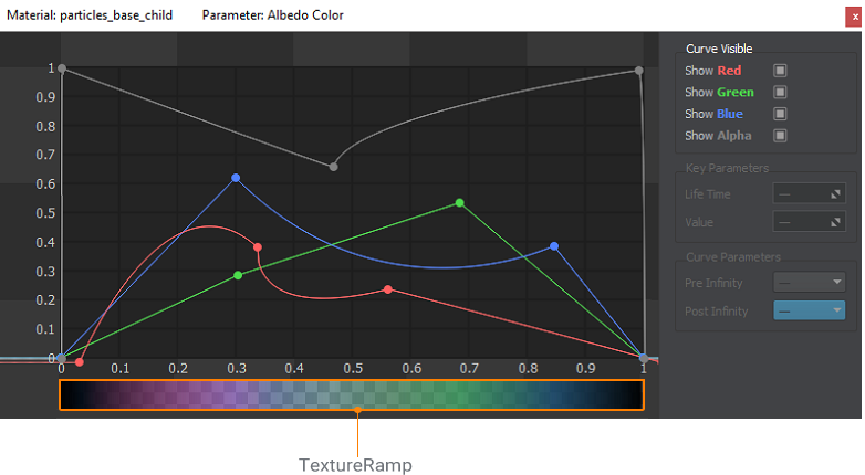

Interface for handling ramp textures. This class lets the user store 2d curves in a form of a texture (convert vectors to raster data).
Ramp textures can be used for color variation in the particles_base material of Particle Systems or in other custom materials.
You can set up to 4 channels for the ramp texture.
