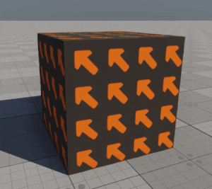

Scrolling UV
This material graph demonstrates a basic UV scrolling effect using the Time node. The time value is added to the UV coordinates (both X and Y), causing the texture to scroll diagonally over time. This is done by connecting the Time node output to the Add node, where it's combined with the Vertex UV 0. The modified UVs are used to sample the texture, creating continuous motion across both axes.
