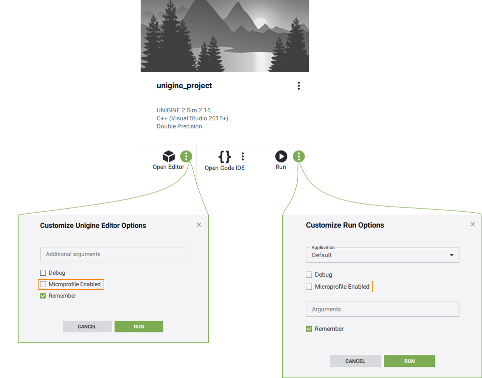

Enabling and Disabling Microprofile#
Microprofile is performance-consuming, that's why we recommend you to enable it only when you work with it and keep disabled otherwise.
One way to disable Microprofile is to untick the corresponding option before running UnigineEditor or the application:
Disabling Microprofile via SDK Browser
Another way is to use the microprofile_enabled console command.
If you change the Microprofile status via the console, this setting is saved in the <Project_Name>/data/configs/default.user file. The state set in the user configuration file will override the state defined via SDK Browser.

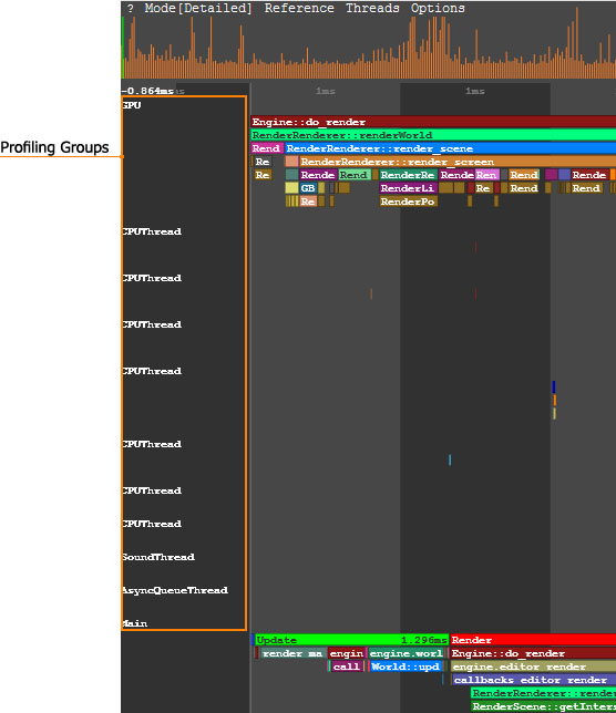

Performance Data#

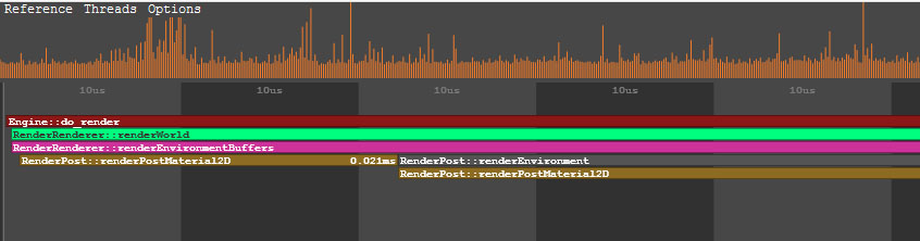

The Microprofile visualizes the detailed per frame performance data on the operations performed by the engine on CPU and GPU and on the engine threads. In the Microprofile main menu, you can change the visualization mode: click Mode and choose the required one. By default, the Detailed mode is set.
Profiling Groups Displayed in Detailed Mode
In the Detailed mode, each operation (function) and thread is displayed as a separate colored region. The regions are hierarchical: the function called by the other function is displayed under the last one. The size of the region is determined by the time the corresponding operation takes.
In the picture below, the Engine::do_render() function calls the RenderRenderer::renderWorld() functions and so on:
To view the data on a certain operation or a thread, point to the corresponding region. To zoom in/out the displayed regions, scroll the mouse wheel.

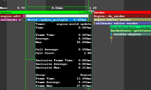

CPU Data#
In the Main group of the performance data, the call stack of the operations (e.g., update, rendering, etc.) performed by the engine on CPU is displayed.
Performance Data on World Update Function

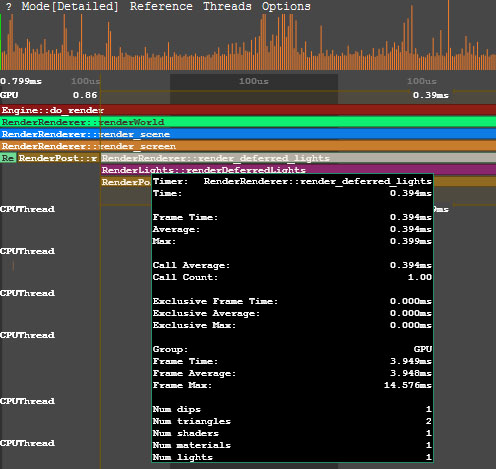

In the GPU group of the performance data, the call stack of the operations performed by the engine on GPU is displayed. In addition to the main performance data, for each function (e.g. environment rendering, post materials rendering and so on), the number of DIP calls and rendered triangles is shown. Also there can be the number of surfaces, lights, shadows rendered by this function, the number of materials and shaders used; the information on the node or material for which the function is called (identifier, name, etc.).
Performance Data on Deferred Lighting Rendering
When the region that corresponds to the certain function is pointed, the Microprofile displays when this function is called on CPU and how much time is spent on its performing.

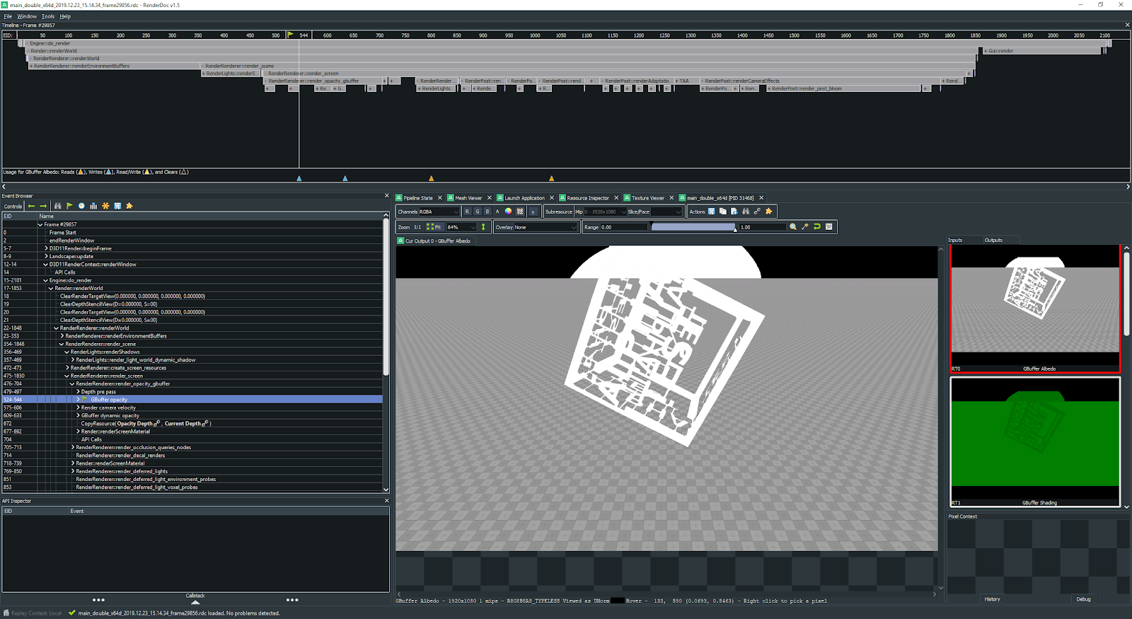

Vulkan or DirectX commands can be combined into GPU Debug groups that are created automatically when defining a profiling scope. All graphic resources loaded from external files, such as textures, shaders, static or skinned meshes, as well as the Engine's internal resources, have their own debug names to simplify identification. This information can be useful when using Graphics API debuggers, such as NVIDIA Nsight or RenderDoc.
Example of debug data viewed in RenderDoc

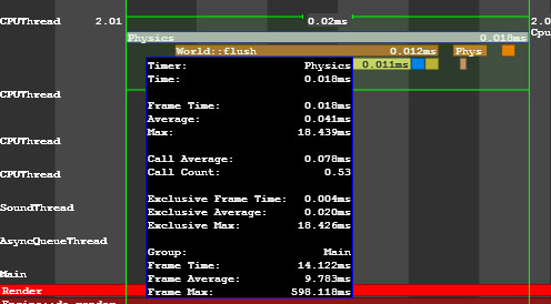

Engine Threads Data#
The performance data on the engine threads is visualized in the CPUThread, SoundThread, AsyncQueueThread, WorldSpawnMeshClutterThread, WorldSpawnGrassThread groups.
Performance Data on Physics Thread

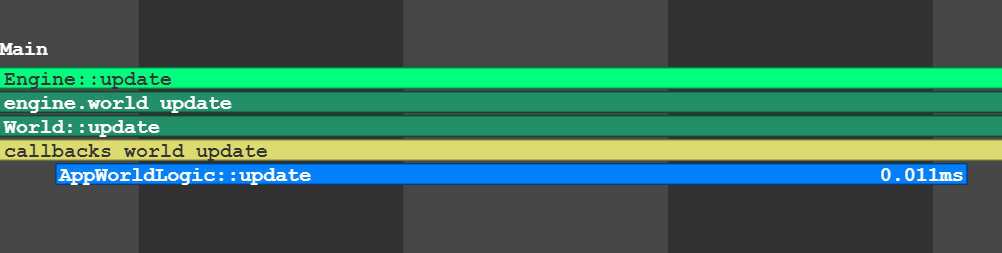

  6. Run the project.
  7. Open the console and run the microprofile_enabled 1 command.
  8. Go to the Microprofile and find the region with the specified name.
The begin() and end() functions make the profiling scope available for both the Profiler and Microprofile.

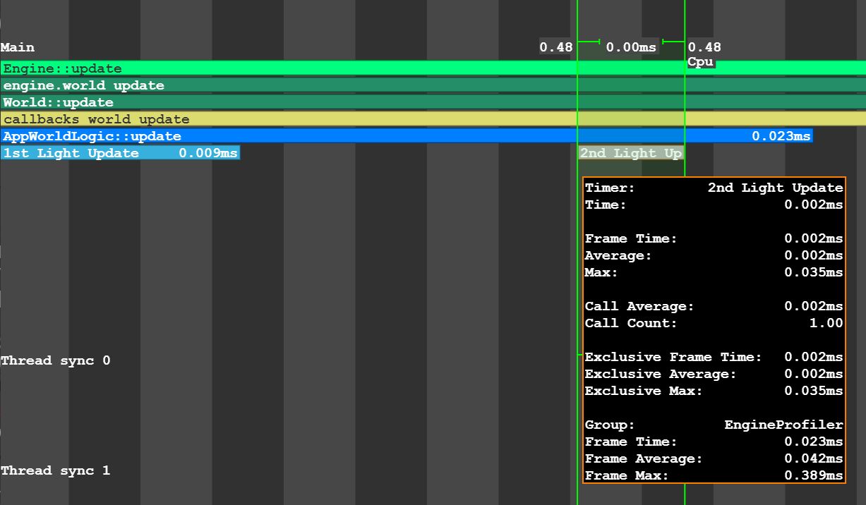

Creating Nested Counters for Profiling#
To create several nested counters, you should use the beginMicro() and endMicro() functions. beginMicro() returns an identifier that should be passed to endMicro(). This enables to create nested and intersecting profiler counters.
In the following example, combination of begin()/end() and beginMicro()/endMicro() is used. So, profiling of the AppWorldLogic::update() function will be available in both the Profiler and the Microprofile.
AppWorldLogic.cpp
int AppWorldLogic::update()
	// start profiling
	Profiler::begin("AppWorldLogic::update");
	float time = Game::getTime();
	float angle_0 = time * 1.0f;
	float angle_1 = time * 1.5f;
	float angle_2 = time * 2.0f;
	// start profiling of the first light source (available in the Microprofile only)
	int id_0 = Profiler::beginMicro("1st Light Update");
	light_0->setWorldTransform(translate(Unigine::Math::Vec3(sinf(angle_0), cosf(angle_0), 1.0f) * 20.0f));
	// stop profiling of the first light source
	Profiler::endMicro(id_0);
	// start profiling of the second light source (available in the Microprofile only)
	int id_1 = Profiler::beginMicro("2nd Light Update");
	light_1->setWorldTransform(translate(Unigine::Math::Vec3(sinf(angle_1), cosf(angle_1), 1.0f) * 20.0f));
	// stop profiling of the second light source
	Profiler::endMicro(id_1);
	light_2->setWorldTransform(translate(Unigine::Math::Vec3(sinf(angle_2), cosf(angle_2), 1.0f) * 20.0f));
	// stop profiling
	Profiler::end();
