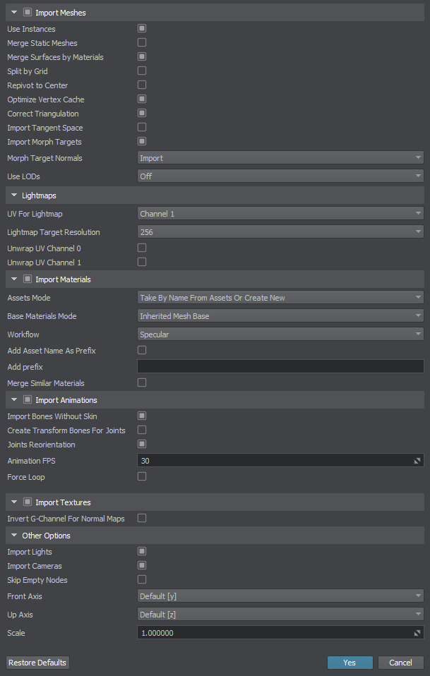

When you import an FBX asset (just like importing any other asset), the import settings window appears:
To simplify sequential import of multiple similar assets, Asset Browser remembers previous asset import settings and offers to use them by default. To reset import settings to system defaults use the Restore Defaults button.
The list of available import options covers all components that can be imported from an FBX scene and includes the following:
Mesh Import Options#
Import Meshes Import geometry meshes from the file.
Use Instances Imports FBX with mesh instances. When enabled, a single mesh is imported instead of several identical ones. If you add such FBX to the scene, all meshes in the World Hierarchy will refer to the single mesh stored inside the imported FBX container.
Merge Static Meshes Merges all of the children static meshes into a single one (named after the parent mesh). All surfaces of all meshes surfaces will be copied and shown in the Surfaces hierarchy.
Merge Surfaces by Materials Enables merging surfaces that have the same materials.
Split by Grid
Enables splitting of imported meshes. Too large models having sizes, that exceed 10000 units may have various artefacts (jitter, etc.) associated with positioning errors. You can eliminate such artefacts by splitting your mesh into multiple separate meshes. To do so, just enable this option and set the size of the grid cell (see the Grid Size parameter below) to be used for mesh splitting.
This option does not split surfaces.
Grid Size Size of the grid cell to split imported meshes, in units.
Repivot to Center Places a pivot of generated mesh to its center. Can be used for meshes having their geometry located too far from their pivot, as this may lead to various artefacts (jitter, etc.) associated with positioning errors.
Optimize Vertex Cache Enables vertex cache optimization. This option reorders an indexed triangle list to improve vertex cache utilization at runtime. It can be turned off to accelerate saving process; however, it should always be turned on if saving the final version.
Correct Triangulation
Enables correct triangulation of meshes, NURBS and patches.
Disabling this option decreases import time, but may lead to triangulation errors resulting in incorrect geometry.
Import Tangent Space
Imports built-in tangent space data instead of recalculating it.
If the option is checked, but an FBX asset has no tangent space, it will be calculated with orientation for the right-handed coordinate system.
Import Morph Targets Enables importing morph targets from the file.
Morph Target Normals
The morph target import parameter that defines how the normals of the morph target are imported. Three modes are available:
  • None — morph targets normals are the same as in the base mesh.
  • Import — morph targets normals are imported with the 3D asset.
  • Recalculate — morph targets normals are recalculated using the specified Morph Target Normals Angle in the range [0, 180]. With the maximum value of 180, all edges become smoothed out. The minimum value of 0 makes the edges sharp.
Use LODs Defines if Levels of Detail (LODs) are to be used for the imported model, as well as the LOD creation and configuration mode.

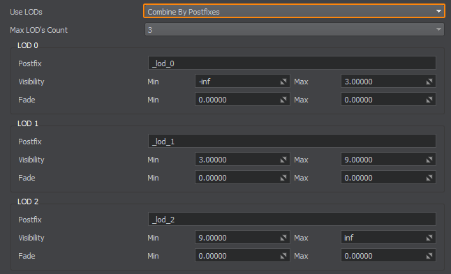

Levels of Detail#
To create several variations of one object with different level of detail (LODs) you should have them as separate surfaces of the object. This will allow you to reduce the number of nodes in the hierarchy and simplify the settings of the LODs visibility.
UNIGINE provides automatic assignment and configuration of Levels of Detail based on the name postfixes, enabling you to create and export different meshes for different LODs of your model in a single FBX file. When naming these meshes, you should add a postfix to specify the LOD each mesh represents. You can also specify visibility and fade distances for each LOD of your model at the importing stage, saving time, as you don't have to adjust these settings for the surfaces on the scene - choose Combine by Postfixes in the Use LODs dropdown.
See the video tutorial on how to configure LODs for more details.
You can also enable the Merge Static Meshes option for more optimization.
  1. Choose Combine by Postfixes in the Use LODs dropdown.
    This will show additional LODs settings:
    Max LODs Count Number of Levels of Detail.
    Postfix Surface name postfix that determines the current LOD.
    Min Visibility
    The minimum distance on which this LOD is visible in camera local axes.
    -inf — the LOD is visible by default.
    Max Visibility
    The maximum distance on which this LOD is visible in camera local axes.
    Min Fade
    Over this distance, the surface fades in until it is completely visible. Along this distance the engine automatically interpolates the level of detail from completely invisible to completely opaque. Fading-in starts when the camera has reached the minimum distance of surface visibility and is in the full visibility range.
    Max Fade
    Over this distance, the surface fades out until it is completely invisible. Fading out starts when the camera has reached the maximum distance of surface visibility and is out of the full visibility range.
  2. Select the number of LODs that are stored in the FBX container.
  3. For each LOD, define a postfix that will be used to group objects in an FBX file into a corresponding LOD.
    The postfix must be the same as the one used when creating objects in a 3D editor.
    The names of generated surfaces will be as follows: material_name + LOD_postfix.
  4. Specify the minimum and maximum visibility and fade distances for each LOD.

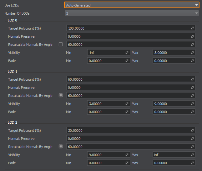

Automatic Generation of LODs#
Automatic LOD Generation feature based on the meshoptimizer library will help in case you only have a high-poly model, saving you a lot of time on preparing levels of detail manually.
To use the feature choose Auto-Generated in the Use LODs dropdown and configure the settings listed below - the Engine will do the rest, generating all LODs automatically based on your configuration.
Target Polycount
Desired degree of geometry simplification for each LOD (target geometry complexity percentage from the initial number of polygons).
Please keep in mind that this is only a target value, that in some cases may be unreachable for the mesh simplifier. In case any artefacts with the topology of the simplified meshes occur, try increasing this value.
Normals Preserve This parameter indicates the impact of normals on mesh topology simplification. Higher values increase the influence of normals, by the value of 0 normals are ignored. Avoid setting too high values as this may restrict simplifier too much and simplification will fail (as normals may differ significantly). Default setting is suitable for most cases.
Recalculate Normals by Angle Enables recalculation of normals in the process of mesh simplification based on the specified angle threshold. If an angle between the normals to adjacent polygons exceeds this value, normals will be recalculated between them to smoothen the look of the geometry and get rid of possible shading issues.
Visibility / Fade Distances
See their description above.

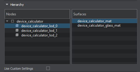

This auxiliary section is available in the Parameters window when selecting an imported FBX asset in the Asset Browser. It enables you to preview the content of the FBX asset according to the current Mesh Import Options.
Nodes List of nodes obtained from the FBX asset.
Surfaces List of surfaces of the selected node.
Use Custom Settings Enables custom Lightmaps options for the selected surface(s).

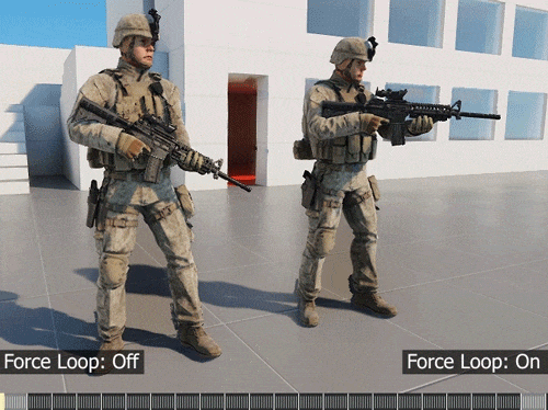

Force Loop
Forced smoothing of looped animation playback.
Looped Frames Number of frames to be used for smoothing of looped animation playback. The specified number of frames is taken from the beginning and from the end of the animation. If the specified value exceeds the (total_number_of_frames)/2, the latter is used instead.

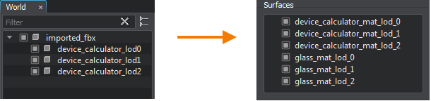

You can combine all child objects into a single one by enabling the Merge Static Meshes option. In this case, all surfaces of child meshes will be copied to the single parent mesh and will appear in its Surfaces hierarchy.
Surfaces of a single mesh generated instead of separate meshes with device_calculator and glass_mat materials assigned

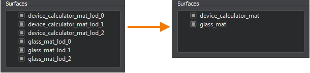

You can also merge the surfaces having the same material assigned by enabling the Merge Surfaces by Materials option.
Surfaces merged by materials

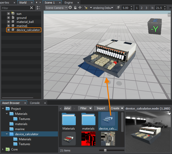

To import materials from an FBX container, you should enable the Import Materials option. In this case, the surfaces of the imported model will have the corresponding materials assigned.

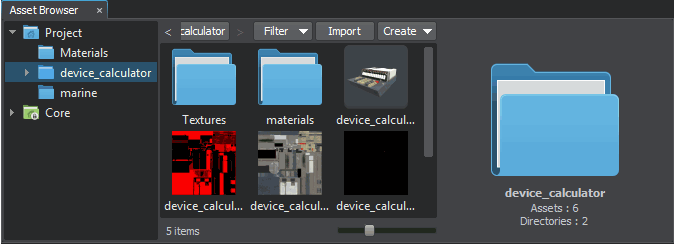

If materials are imported, the material assets are created in the materials subfolder of the folder where the .fbx asset is stored.

If textures are imported, the corresponding texture assets are created in the same folder, where the .fbx asset is stored.

Adding Imported FBX Asset to the World#
To add a new imported FBX asset to the scene, as any other asset, simply drag it from the Asset Browser to the Viewport window. The corresponding node will be created and displayed in the World Hierarchy window. This node will have the same name as the imported FBX asset and a hierarchy of child nodes representing separate objects contained in the 3D model.
Non-native geometry asset types (fbx, obj, dae, etc.) are containers for meshes. If you double-click such asset in the Asset Browser (or use the right-click Open command), the generated runtime .mesh, .anim and .node files stored in the container asset will be displayed:
Opening FBX Container
