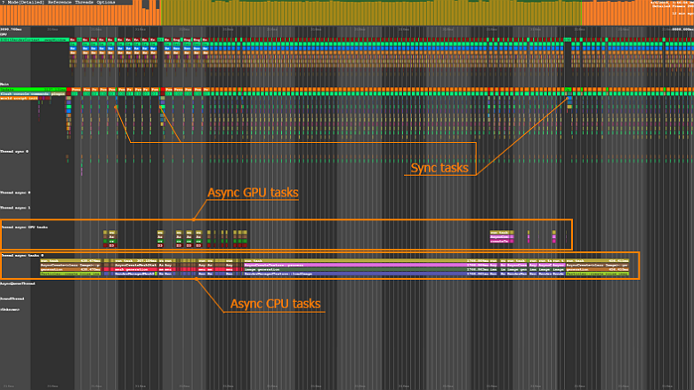

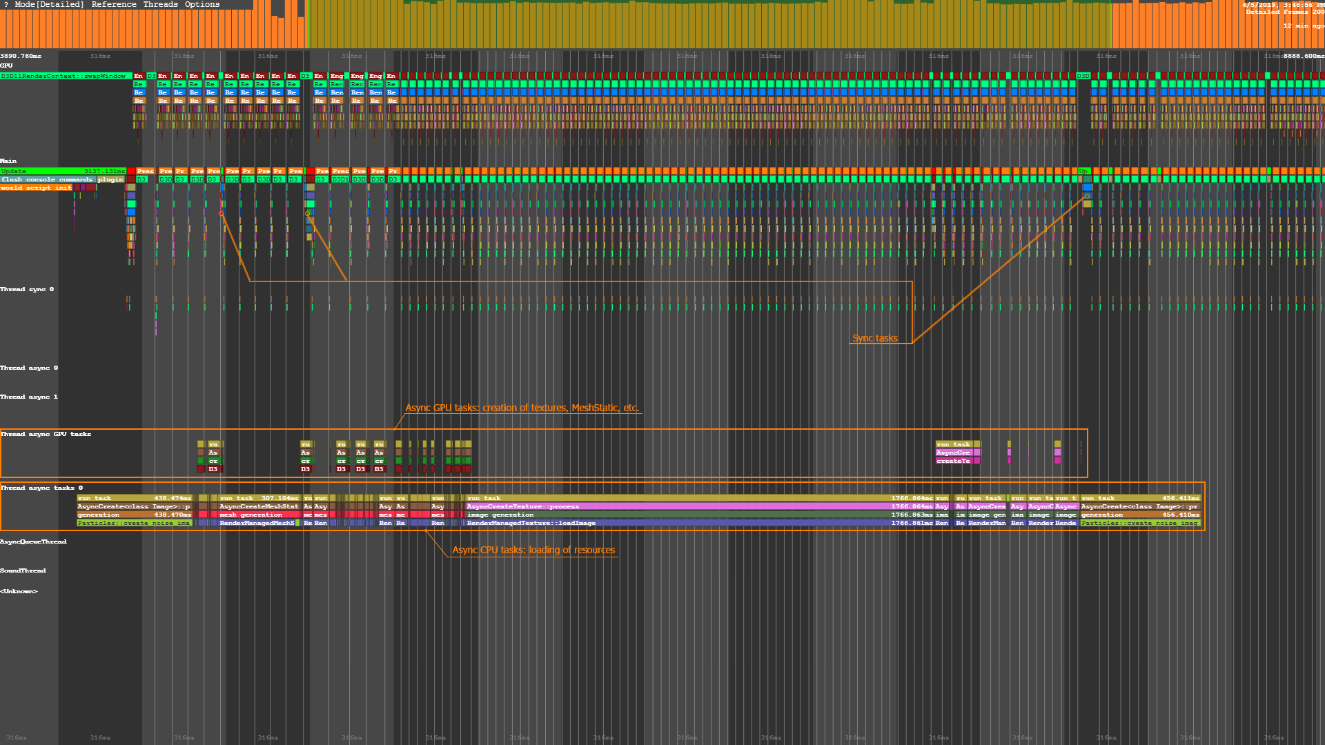

Resource loading is performed and transferred to the GPU in separate asynchronous threads. After that, resources are synchronized and added to the virtual scene on the CPU side.
The output of the Microprofile tool.

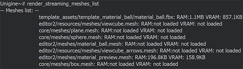

It is also possible to print the list of loaded resources and detailed information on them by using the render_streaming_meshes_list and render_streaming_textures_list console commands.
The render_streaming_meshes_list output.
