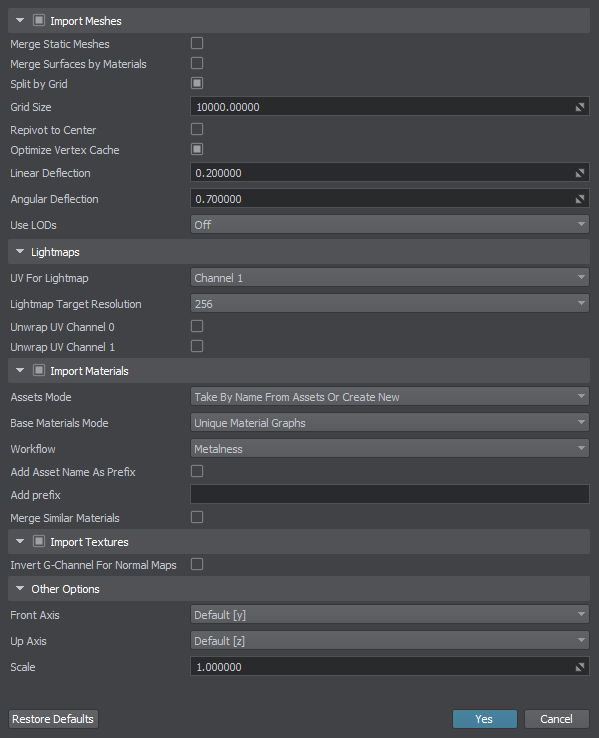

When you import a CAD asset, the import settings window appears:
To simplify sequential import of multiple similar assets, Asset Browser remembers previous asset import settings and offers to use them by default. To reset import settings to system defaults use the Restore Defaults button.
The list of available import options includes the following:
Mesh Import Options#
Import Meshes Import geometry meshes from the file.
Merge Static Meshes Merges all children static meshes in one (names it after the parent mesh). All of the meshes surfaces will be copied and shown in the Surfaces hierarchy.
Merge Surfaces by Materials Enables merging surfaces that have the same materials.
Split by Grid
Enables splitting of imported meshes. Too large models having sizes, that exceed 10000 units may have various artefacts (jitter, etc.) associated with positioning errors. You can eliminate such artefacts by splitting your mesh into multiple separate meshes. To do so, just enable this option and set the size of the grid cell (see the Grid Size parameter below) to be used for mesh splitting.
This option does not split surfaces.
Grid Size Size of the grid cell to split imported meshes, in units.
Repivot to Center Places a pivot of generated mesh to its center. Can be used for meshes having their geometry located too far from their pivot, as this may lead to various artefacts (jitter, etc.) associated with positioning errors.
Optimize Vertex Cache Enables vertex cache optimization. This option reorders an indexed triangle list to improve vertex cache utilization at runtime. It can be turned off to accelerate saving process; however, it should always be turned on if saving the final version.
Linear Deflection Limits the distance between triangles and the original surface. It is used to define triangulation of the imported model together with the Angular Deflection.
Angular Deflection Limits the angle between adjacent triangles generated from a surface. It is used to define triangulation of the imported model together with the Linear Deflection.
Use LODs Defines if Levels of Detail (LODs) are to be used for the imported model.

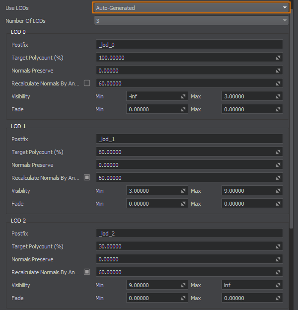

Levels of Detail#
Automatic LOD Generation feature based on the meshoptimizer library will help create several variations of one object with different level of detail (LODs).
To use the feature choose Auto-Generated in the Use LODs dropdown and configure the settings listed below - the Engine will do the rest, generating all LODs automatically based on your configuration.
See the video tutorial on how to configure LODs for more details.
You can also enable the Merge Static Meshes option for more optimization.
Number of LODs Number of Levels of Detail.
Target Polycount
Desired degree of geometry simplification for each LOD (target geometry complexity percentage from the initial number of polygons).
Please keep in mind that this is only a target value, that in some cases may be unreachable for the mesh simplifier. In case any artefacts with the topology of the simplified meshes occur, try increasing this value.
Normals Preserve This parameter indicates the impact of normals on mesh topology simplification. Higher values increase the influence of normals, by the value of 0 normals are ignored. Avoid setting too high values as this may restrict simplifier too much and simplification will fail (as normals may differ significantly). Default setting is suitable for most cases.
Recalculate Normals by Angle Enables recalculation of normals in the process of mesh simplification based on the specified angle threshold. If an angle between the normals to adjacent polygons exceeds this value, normals will be recalculated between them to smoothen the look of the geometry and get rid of possible shading issues.
Min Visibility
The minimum distance on which this LOD is visible in camera local axes.
-inf — the LOD is visible by default.
Max Visibility
The maximum distance on which this LOD is visible in camera local axes.
Min Fade
Over this distance, the surface fades in until it is completely visible. Along this distance the engine automatically interpolates the level of detail from completely invisible to completely opaque. Fading-in starts when the camera has reached the minimum distance of surface visibility and is in the full visibility range.
Max Fade
Over this distance, the surface fades out until it is completely invisible. Fading out starts when the camera has reached the maximum distance of surface visibility and is out of the full visibility range.

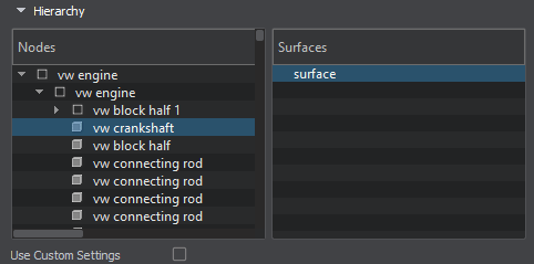

Hierarchy Options#

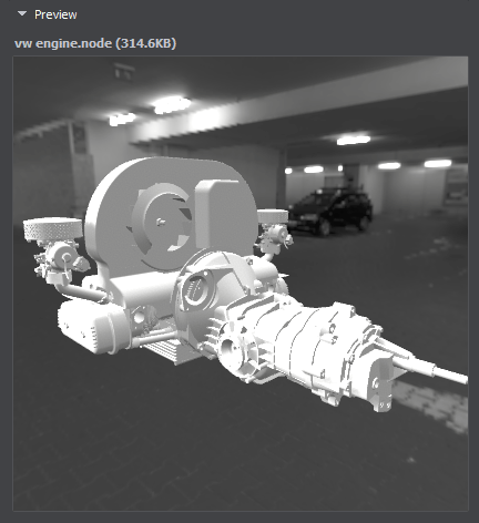

This auxiliary section is available in the Parameters window when selecting an imported CAD asset in the Asset Browser. It enables you to preview the content of the CAD asset imported with the current Mesh Import Options.
Nodes List of nodes obtained from the CAD asset.
Surfaces List of surfaces of the selected node.
Use Custom Settings Enables custom Lightmaps options for the selected surface(s).
Asset Preview#
This section is available in the Parameters window when selecting an imported CAD asset in the Asset Browser. It allows you to preview the imported model.

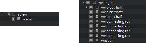

CAD model can be represented as a single detail or as an assembly. If parts of the assembly are stored in separate files, you should specify all of them on the assembly import.
To import 3D geometry data contained in a CAD model, you should enable the Import Meshes option. When you add the imported geometry to the scene, it will be available in the World Hierarchy as a Dummy Node:
  • If the imported CAD asset stores a detail, a single static mesh will be a child of the Dummy Node.
  • If the imported CAD asset stores an assembly, the Dummy Node will have a hierarchy of child nodes representing parts of the assembly.
A Detail (left) and An Assembly (right)
By default, the surfaces of each detail of the CAD model that have the same material are merged resulting in a single surface for each detail in most cases.
If you enable the Merge Static Meshes option, all child meshes will be combined into a single one. At that, all surfaces of child meshes will be copied to the single parent mesh and will appear in its Surfaces hierarchy.
You can also merge the surfaces of the CAD model having the same material assigned by enabling the Merge Surfaces by Materials option.

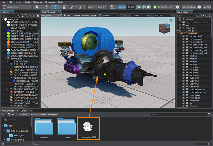

Adding Imported CAD Asset to the World#
To add an imported CAD asset to the scene, drag it from the Asset Browser to the Viewport window. The corresponding node will be created and displayed in the World Hierarchy window. This node will have the same name as the imported CAD asset and a hierarchy of child nodes representing separate objects contained in the model.
If you double-click the imported CAD asset in the Asset Browser, the .mesh and .node files generated in run-time and stored in the CAD file will be displayed.
