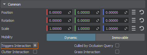

Catching Nodes with World Triggers#
A World trigger triggers events when any nodes (colliders or not) get inside or outside of them. The trigger can detect a node of any type by its bounding box. The trigger reacts to all nodes (default behavior).
The handler function of World Trigger is actually executed only when the next engine function is called: that is, before updatePhysics() (in the current frame) or before update() (in the next frame) - whatever comes first.
If you have moved some nodes and want to execute handler functions based on changed positions in the same frame, you need to call updateSpatial() first.
You can subscribe for Enter and Leave events with handler functions to be executed when a node enters or leaves the World Trigger. A handler function must receive a Node as its first argument.
