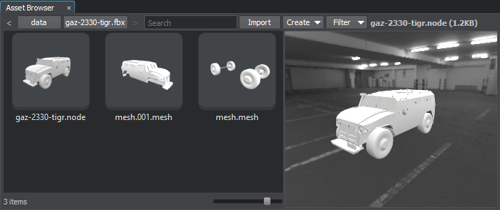

In UNIGINE, an imported FBX asset appears as a container for all meshes it stores in the Asset Browser. The link to the original file isn't created, the file is copied to the project data folder when imported. You can access the contents by right-clicking the asset and choosing Open:
Meshes within an FBX asset in UNIGINE
Every separate object in the FBX model is represented by a .mesh runtime asset. Materials (if there are any, provided the Import Materials option was enabled) are generated in the materials folder next to the asset. To adjust import settings, select the FBX asset and proceed to the Parameters window.

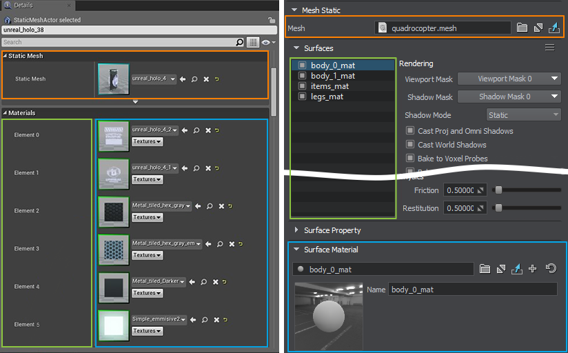

To create a node that uses the mesh or FBX asset you can simply drag it to the UnigineEditor viewport the same way you would do in Unreal Editor. In UNIGINE, this will add a Static Mesh object to the world hierarchy.
Object nodes are major building blocks that construct the world. Most of them represent visible geometry of the scene. For example, it is best to use a Static Mesh object for objects that are not intended to change their geometry the same way as Static Mesh actor in UE4.
On the picture below similar UI elements for static mesh parameters are color-coded for both editors:
Static Mesh parameters in Unreal Editor and UnigineEditor
Here Surface come into play. They are pretty close to Elements of a Static Mesh in Unreal Engine, but a surface encapsulates a sub-mesh having a certain material assigned (in third-party 3D editors) and has the name according to that material. For convenience, surfaces can be rearranged in a hierarchy and toggled on and off. Some settings you would set for the whole Static Mesh actor, such as visibility and contribution to lighting, are available for each surface separately.

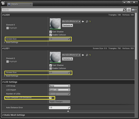

Levels of Detail (LOD)#

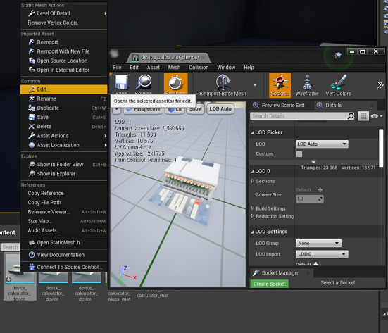

In Unreal Editor, you are likely to be used to configuring LODs for a Static Mesh asset using the Static Mesh Editor. You usually import additional FBX files for all LODs and specify the screen size for each one. The active LOD is defined by the threshold based on the ratio of the mesh's screen-space size to the total screen height.
LOD Group
Configuring LODS in Static Mesh Editor

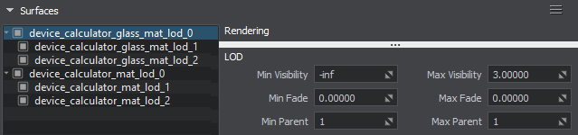

In UNIGINE, it is much more handy to store all LODs in a single .fbx model, in this case a Static Mesh created based on the asset will have several surfaces corresponing to LODs. Levels of detail are defined based on distances — in a more low-level manner to make fine tuning available. Surfaces have visibility settings for this purpose. You can set the minimum and maximum visibility distances from the camera for each surface. For Cross Fading use the Minimum Fade and Maximum Fade values.
Surface LOD Settings
Configuring LODs in UNIGINE
Note the -inf value in one of the fields. You can use inf (Infinity) and -inf (-Infinity) values for parameters supporting this format to define the lowest and highest possible values respectively.
Automatic generation of LODs is not provided in UNIGINE, but automatic LODs setup when importing a model is described in the FBX Import Guide. For more details on configuring LODs refer to the dedicated article.

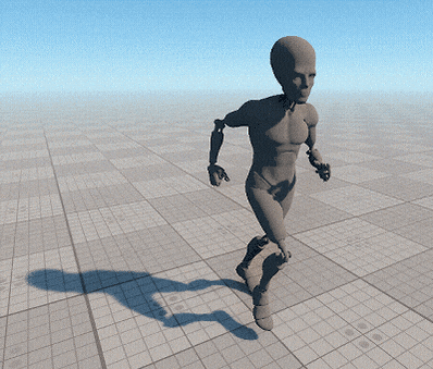

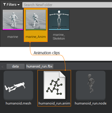

FBX models containing bone-animated skinned meshes create animation clips when imported in both engines. In UNIGINE, such clips are represented by .anim assets.
Animation sequence in UE4 and .anim asset in UNIGINE
Skinned Mesh object acts the same way as Skeletal Mesh Actor in UE4 used for handling bone animations.
There is no skeleton concept as a special type of asset in UNIGINE. The skinned animation system is focused on operating animation layers: you can configure multiple layers with various animation clips and perform blending between them by using API methods.
Example of animation using two layers

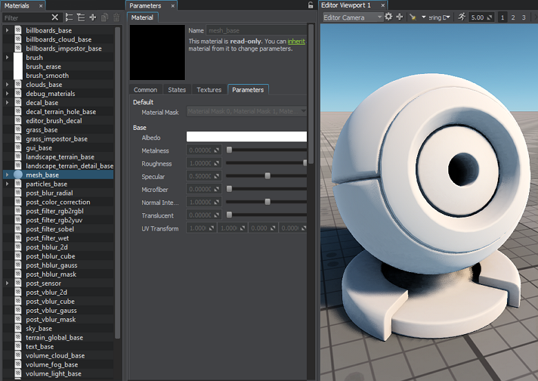

The mesh_base is the base PBR material in UNIGINE used for mesh surfaces. Right here you can inherit a new material from it and start setting it up by tweaking the parameters and assigning textures in the Parameters window.
Parameters of the mesh_base material

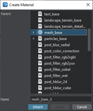

We create user materials by inheriting them from base materials to override some properties passed to shaders on rendering. When creating a material in the Asset Browser, we choose the base material to inherit from, thus defining the type of objects the new material will support.
Create Material window

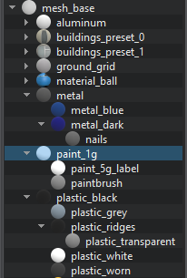

Furthermore, user materials can form a hierarchy for convenience. So, when parameters of the parent material are changed, overridden parameters of its children remain the same.
Materials Hierarchy window

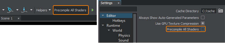

Shader Compilation#
UE4 compiles shaders asynchronously using a streaming system.
In UNIGINE, Forced Shader Compilation, an in-editor feature, is available via both the toolbar and the Editor section of the Settings window.

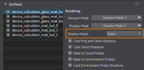

The Mixed or Static Shadow Casting Mode of a light source filters the surfaces that cast shadows from it. By using the Mixed mode you can combine baked shadows from static geometry and realtime shadows cast by certain dynamic meshes. Use the Shadow Mode to decide whether the surface is static or dynamic.
The Shadow Mode parameter is set per surface
You don't have to bake shadows to achieve the soft shadows effect. This is controlled by the Penumbra Mode and Filtering Mode parameters per each light source.

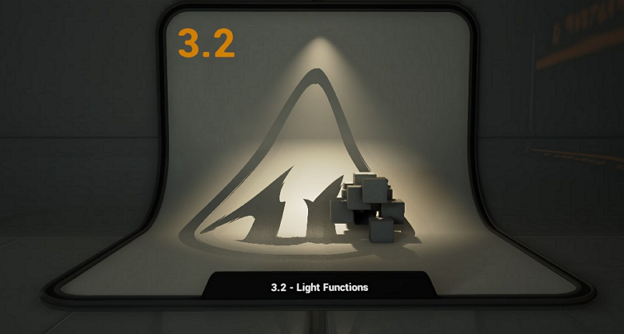

Light Functions#
To filter a light's intensity Unreal Engine provides Light Functions.
In UNIGINE, you can use an arbitrary 2D diffuse or albedo texture in the Texture parameter of Light Projected. The same way you can apply texture modulation to a Light Omni by using a cubemap texture.
Modulation by texture
Modulation by cubemap
This is the way IES Light Profiles can be simulated as well.

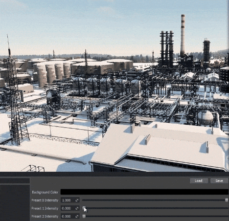

UNIGINE provides three environment presets, by configuring which you can create a smooth transition between different weather conditions. By default, the first preset is enabled only.
UNIGINE Environment Settings

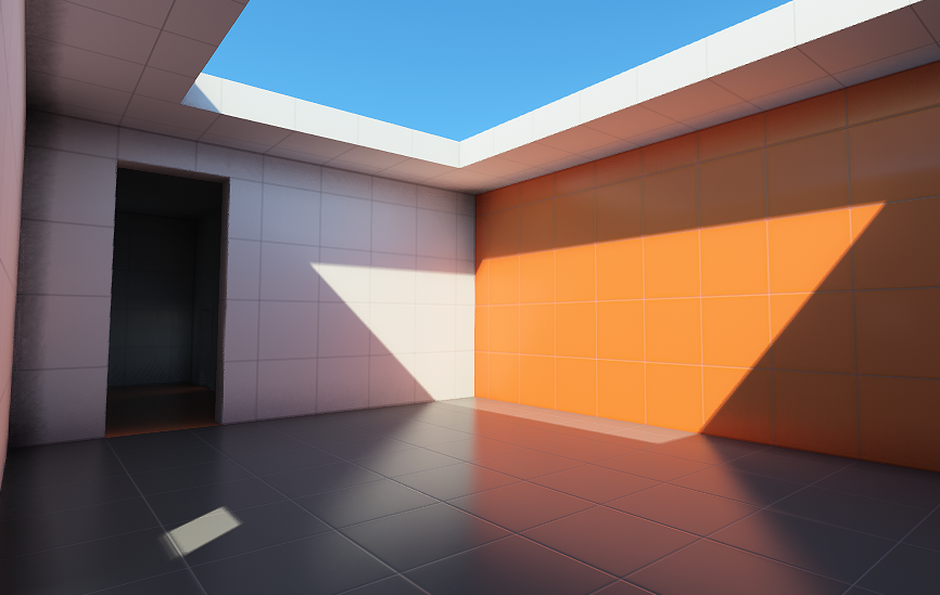

In UNIGINE, lightmaps are also supported and baked using the integrated GPU Lightmapper tool.

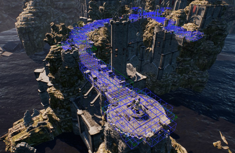

UNIGINE provides another advanced solution for static GI — Voxel-Based Global Illumination provided by Voxel Probe.
UNIGINE Voxel-Based Global Illumination

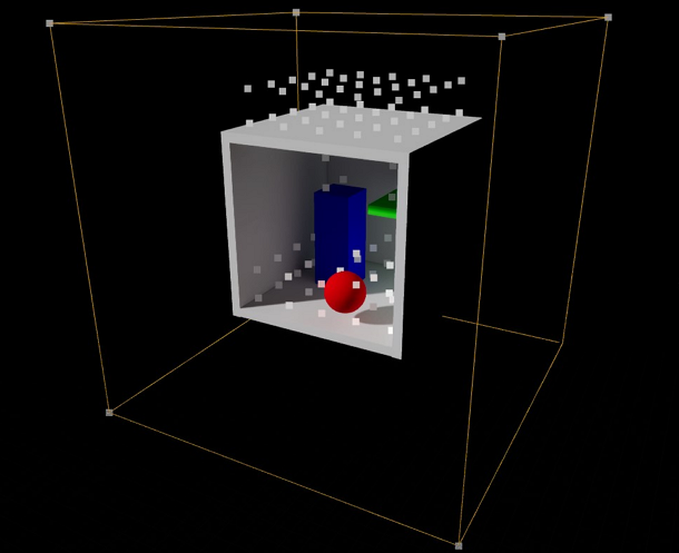

Voxel Probe is a box-shaped volume composed of voxels of fixed size, providing both pre-calculated indirect lighting and diffuse (blurred) reflections. One of advantages of this approach — there is no need in UV coordinates, any geometry will contribute to GI with no issues.
Light baking is performed using Bake Lighting tool.
Similar to using Lightmass Importance Volume in UE4, you can make insets — Voxel Probes with more dense grid — to bake more details of GI where necessary.

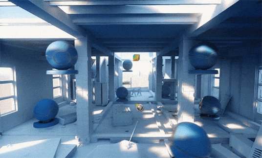

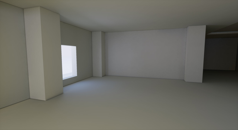

Volumetric Lightmaps#

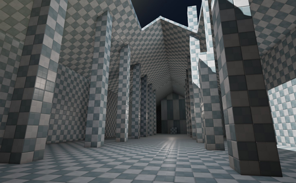

Volumetric Lightmap storing precomputed lighing in all points in space is much closer to UNIGINE Voxel Probe.
Volumetric Lightmap in Unreal Editor

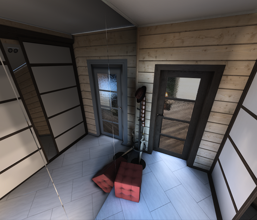

As Voxel Probe has internal volume baked, it will illuminate objects that move within its bounds. The Bake Internal Volume parameter enables to choose the quality and time required to bake GI for empty voxels (i.e. the voxels that do not cover any geometry).
Voxel-based GI on moving objects in UNIGINE
To preview ambient lighting in the viewport, switch the Rendering Debug mode to Indirect Lighting.

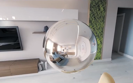

Reflection Capture#
An almost complete counterpart for Sphere Reflection Capture and Box Reflection Capture actors of UE4 is Environment Probe in UNIGINE. This reflection provider stores a cubemap texture to be rendered on reflective surfaces within its bounds.
A reflective sphere placed inside Environment Probe
Environment Probe can be either Static or Dynamic:
Dynamic Mode. The cubemap is grabbed each frame providing real time reflections and a massive load on the CPU.
Static Mode. Environment Probe uses a pre-baked cubemap obtained using the Bake Lighting tool. This mode suits mostly static environments.
Custom Static Mode. The static mode with a custom cubemap texture assigned.
Box projection is supported as well:
Projection types shown on a box-shaped room
Furthermore, spherical Environment Probe can be subject to Parallax effect controlled by the corresponding parameter. While the 0 value implies projecting the reflection on an infinitesimally far sphere, the value of 1 corresponds to the actual Probe bounding sphere taking into account the viewer's perspective.

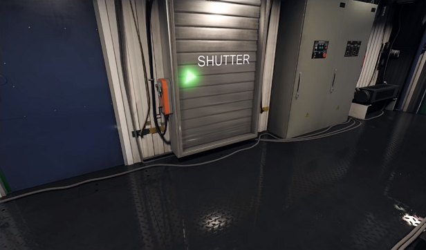

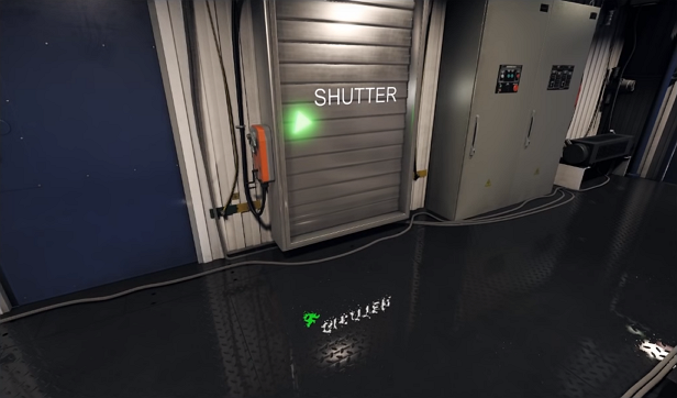

Screen Space Reflections#
Screen-Space Reflections are also a part of UNIGINE. Global SSR settings contain multiple parameters making fine-tuning available.

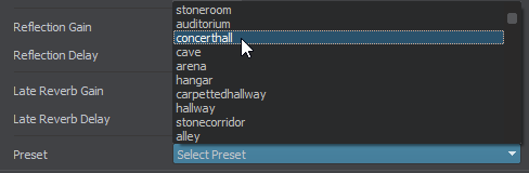

Audio Volumes#
Just like Audio Volume in Unreal Engine, UNIGINE Sound Reverb objects represent reverberation zones where ambient sound effect appears provided the player is within the zone. With fine-tuned parameters a reverberation zone correctly reproduces the way the sound is reflected from surfaces, forming three main components:
  • Early reflections
  • Late reverberation
  • Echo
Besides that, a number of parameters can be changed to alter the type of environment being simulated. A number of presets may help you to quickly choose the most suitable type of environment to simulate:
By adjusting the Threshold parameter you can enable smooth sound transition when the listener moves from the outside area into the reverberation zone.

In UE4, apart from the common culling technique, such as Frustum Culling, there is also a set of additional ones. Mostly all of them have Occlusion Culling analogs available in UNIGINE. These techniques extremely reduce the number of polygons rendered.
Precomputed Static Visibility in UE4
In UNIGINE, technique is represented by methods:
  • Cull Distance Volumes can be replaced by Switcher nodes.
  • Precomputed Static Visibility. It is usual for you, as an Unreal Engine user, to define Visibility Volumes and precompute visibility cells.
    In UNIGINE, you can use box-shaped and mesh-based Occluder culling geometry occluded by them dynamically.
  • Hardware Occlusion Queries technique is also available in UNIGINE. It allows skipping rendering of objects, the bounding boxes of which are covered by another opaque geometry.

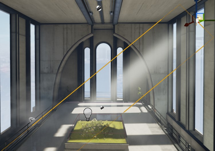

Billboards#
In UE4, you use Billboard rendering component — a 2D texture rendered always facing the camera that can be used to replace a complex 3D mesh at some distance from the camera, thus reducing the load on GPU.
Fog sheet created using Billboard in UE4
UNIGINE provides support for Billboards as well. In UNIGINE, a billboard is a rectangular flat object that always faces the camera so it is capable of representing some flat effects and objects that are barely seen from far off.
Billboards sample in UNIGINE

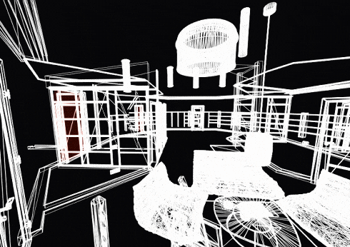

In UNIGINE, you can generate a billboard-based Impostor using the Impostors Creator. This out-of-the-box tool creates a series of snapshots of the object while saving shading fidelity and combines them in a single Billboard object. Now you can use the Impostor object as the lowest LOD for the mesh at a distance.
Impostor albedo texture
Object and Impostor wireframes

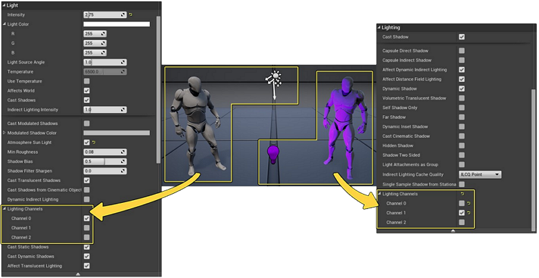

Channels#
In UE4, you are accustomed to use Channels to define groups of GameObjects to be unapproachable by light sources, as well as for selective collisions.
In UNIGINE, a similar system is called the Bit Masking mechanism. Objects, cameras, materials, and other entities have bit masks used by various effects and features to define their scope. Each bit in a bit mask can be named for convenience.
The masks are compared bitwise using logical conjunction, so if two masks have at least one matching bit enabled, they match and, therefore, the entity is subject to the effect.
For instance, you can filter out certain objects (e.g. tooltips) for reflections by adjusting the Reflection Viewport Mask:
For more details and usage examples:
