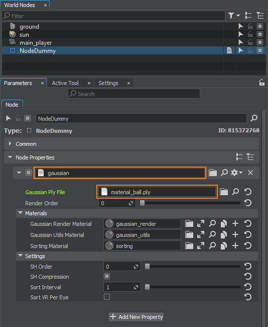

To add a Gaussian Splatting file to the scene, do the following:
  1. Create a Node Dummy and assign the gaussian property to it (this property is available in the project as a part of the plugin).
  2. In the property parameter Gaussian Ply File, assign the *.ply file that you want to render.
  3. Adjust other parameters, if necessary.
