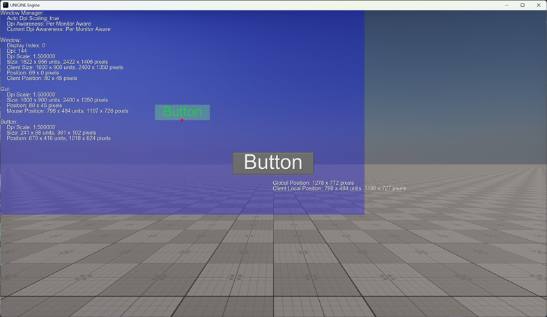

Misaligned Window Coordinates#
If your application isn't DPI-aware, the operating system may apply automatic scaling, but that doesn't always mean everything lines up correctly. One common problem is misaligned window borders, where the application thinks it's at one position, but the system renders it somewhere else without proper coordinate conversion. This can cause, for example, window scrolling being triggered too early or too late. For instance, instead of scrolling when you reach the edge, it may only start when the cursor is somewhere in the middle of the window.

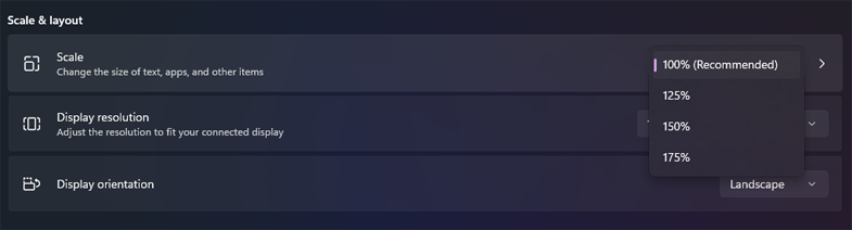

Example. System scaling: 175%.
When working with raw mouse coordinates (e.g. Input::getMousePosition()) it's important to remember that these coordinates are usually in global screen coordinates (pixels), whereas most other UI sizes are in logical units by default (e.g. window size).
WRONG
AppSystemLogic.cpp
ivec2 mouse_pos = Input::getMousePosition(); // pixels
ivec2 client_pos = window->getClientPosition(); // pixels
${#HL}$ivec2 client_size = window->getClientSize(); // units - WRONG ${HL#}$
if (client_pos.x > mouse_pos.x && mouse_pos.x > (client_pos.x + client_size.x))
    if (client_pos.y > mouse_pos.y && mouse_pos.y > (client_pos.y + client_size.y))
        // intersection
Widgets are offset, and rightward scrolling is triggered too early. Although the visual output is distorted, application logic (selection) still functions correctly.

Example. System scaling: 125%.

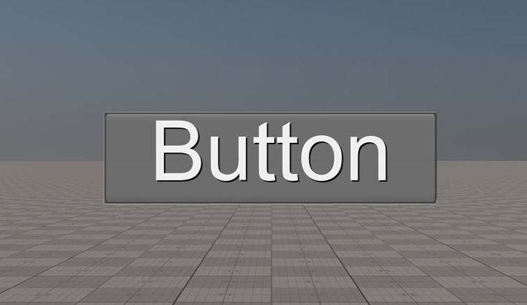

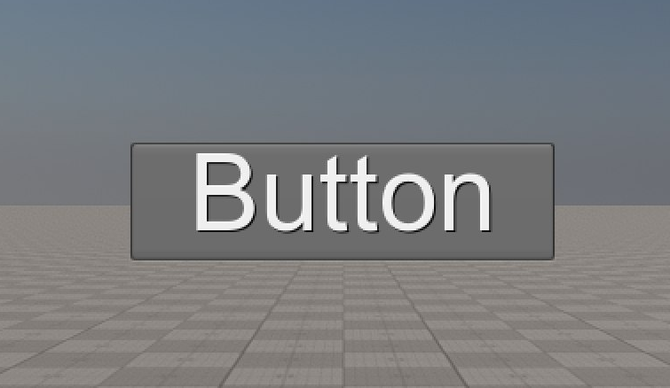

Example. Same GUI at 200% scaling.
WRONG
Auto DPI Scaling disabled. The font and the background texture become blurry and visually degraded with the parameter toggled off.
FIXED
Auto DPI Scaling enabled. Both the font and the background texture look sharp.

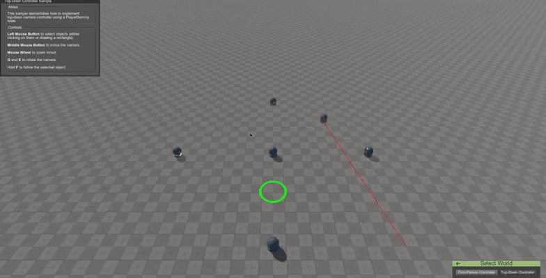

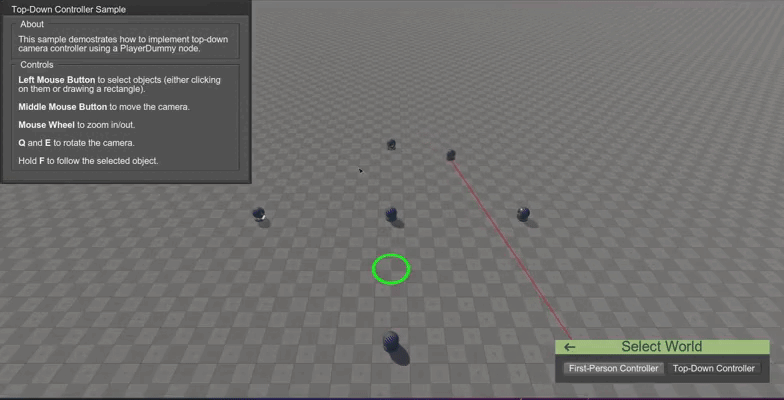

Setting Up Proper DPI Scaling#
Transitioning an application to support proper DPI scaling can be complicated, especially when dealing with legacy code that was built with fixed pixel-based layouts. Here are several approaches to making the transition smoother while minimizing breakage:
  1. If you want to keep the old behaviour completely, use DPI Awareness Level 0 (DPI Unaware) and disabled GUI Auto DPI Scaling. To do this, use the following launch arguments:
    • -dpi_awareness 0 -auto_dpi_scaling 0
  2. If you want to enable window viewport scaling but not apply it to widgets yet, use DPI Awareness Level 1 (System Aware) or DPI Awareness Level 2 (Per Monitor DPI Aware) and disabled Auto DPI Scaling. To do this, use the following launch arguments:
    • -dpi_awareness 1 -auto_dpi_scaling 0
    • -dpi_awareness 2 -auto_dpi_scaling 0
    The window will allow you to get the current value of DPI, but the widget scale will remain at 100%.

      The following example demonstrates how to create a debug overlay to detect coordinates misalignment:
      DebugDpiScale.h
      #ifndef __APP_SYSTEM_LOGIC_H__
      #define __APP_SYSTEM_LOGIC_H__
      #include "UnigineLogic.h"
      #include "UnigineWidgets.h"
      class AppSystemLogic : public Unigine::SystemLogic
          int init() override;
          int update() override;
          Unigine::WidgetLabelPtr info_label;
          Unigine::WidgetLabelPtr mouse_info_label;
          Unigine::WidgetButtonPtr button;
          Unigine::WidgetCanvasPtr info_canvas;
          int polygon_client_window{-1};
          int polygon_button{-1};
          int polygon_mouse{-1};
          int text_button{-1};
          Unigine::Math::vec4 polygon_button_color{0.5f, 1.0f, 0.5f, 0.3f};
          Unigine::EventConnections connections;
      #endif // __APP_SYSTEM_LOGIC_H__
      DebugDpiScale.cpp
      #include "AppSystemLogic.h"
      using namespace Unigine::Math;
      int AppSystemLogic::init()
          info_canvas = WidgetCanvas::create();
          polygon_client_window = info_canvas->addPolygon();
          polygon_button = info_canvas->addPolygon();
          text_button = info_canvas->addText();
          polygon_mouse = info_canvas->addPolygon();
          info_canvas->setTextText(text_button, "Button");
          info_canvas->setTextSize(text_button, 60);
          WindowManager::getMainWindow()->addChild(info_canvas, Gui::ALIGN_LEFT | Gui::ALIGN_OVERLAP | Gui::ALIGN_BACKGROUND);
          info_label = WidgetLabel::create();
          info_label->setFontSize(16);
          info_label->setFontOutline(1);
          WindowManager::getMainWindow()->addChild(info_label, Gui::ALIGN_LEFT | Gui::ALIGN_OVERLAP);
          mouse_info_label = WidgetLabel::create();
          mouse_info_label->setFontSize(16);
          mouse_info_label->setFontOutline(1);
          WindowManager::getMainWindow()->addChild(mouse_info_label, Gui::ALIGN_OVERLAP);
          button = WidgetButton::create("Button");
          button->setFontSize(60);
          button->setFontOutline(1);
          WindowManager::getMainWindow()->addChild(button, Gui::ALIGN_CENTER);
          button->getEventPressed().connect(connections, [this]()
              polygon_button_color = vec4(0.0f, 1.0f, 0.0f, 0.3f);
          button->getEventReleased().connect(connections, [this]()
              polygon_button_color = vec4(0.5f, 1.0f, 0.5f, 0.3f);
          Input::setMouseHandle(Input::MOUSE_HANDLE_USER);
      int AppSystemLogic::update()
          String info;
          auto print_dpi_awareness = [&info](const char *title, WindowManager::DPI_AWARENESS awareness)
              info += String::format("\t%s: ", title);
              switch (awareness)
                  case WindowManager::DPI_AWARENESS_CUSTOM:            info += "Custom";            break;
                  case WindowManager::DPI_AWARENESS_UNAWARE:           info += "Unaware";           break;
                  case WindowManager::DPI_AWARENESS_SYSTEM_AWARE:      info += "System Aware";      break;
                  case WindowManager::DPI_AWARENESS_PER_MONITOR_AWARE: info += "Per Monitor Aware"; break;
              info += "\n";
          auto print_int = [&info](const char *title, int value) { info += String::format("\t%s: %d\n", title, value); };
          auto print_float = [&info](const char *title, float value) { info += String::format("\t%s: %f\n", title, value); };
          auto print_ivec2 = [&info](const char *title, const ivec2 &value, const char *measure)
              info += String::format("\t%s: %d x %d %s\n", title, value.x, value.y, measure);
          auto print_units_and_pixels = [&info](const char *title, const ivec2 &units, const ivec2 &pixels)
              info += String::format("\t%s: %d x %d units, %d x %d pixels\n", title, units.x, units.y, pixels.x, pixels.y);
          // window manager
          info += "Window Manager:\n";
          info += String::format("\tAuto Dpi Scaling: %s\n", WindowManager::isAutoDpiScaling() ? "true" : "false");
          print_dpi_awareness("Dpi Awareness", WindowManager::getDpiAwareness());
          print_dpi_awareness("Current Dpi Awareness", WindowManager::getCurrentDpiAwareness());
          info += "\n";
          // window
          info += "Window:\n";
          EngineWindowPtr window = WindowManager::getMainWindow();
          print_int("Display Index", window->getDisplayIndex());
          print_int("Dpi", window->getDpi());
          print_float("Dpi Scale", window->getDpiScale());
          print_units_and_pixels("Size", window->getSize(), window->getRenderSize());
          print_units_and_pixels("Client Size", window->getClientSize(), window->getClientRenderSize());
          print_ivec2("Position", window->getPosition(), "pixels");
          print_ivec2("Client Position", window->getClientPosition(), "pixels");
          info += "\n";
          // gui
          info += "Gui:\n";
          GuiPtr gui = window->getSelfGui();
          print_float("Dpi Scale", gui->getDpiScale());
          ivec2 unit_gui_size = gui->getSize();
          ivec2 pixel_gui_size(gui->toRenderSize(unit_gui_size.x), gui->toRenderSize(unit_gui_size.y));
          print_units_and_pixels("Size", unit_gui_size, pixel_gui_size);
          print_ivec2("Position", gui->getPosition(), "pixels");
          ivec2 unit_gui_mouse_position(gui->getMouseX(), gui->getMouseY());
          ivec2 pixel_gui_mouse_position(gui->toRenderSize(unit_gui_mouse_position.x), gui->toRenderSize(unit_gui_mouse_position.y));
          print_units_and_pixels("Mouse Position", unit_gui_mouse_position, pixel_gui_mouse_position);
          info += "\n";
          // button
          info += "Button:\n";
          print_float("Dpi Scale", button->getDpiScale());
          ivec2 unit_button_size(button->getWidth(), button->getHeight());
          ivec2 pixel_button_size(button->toRenderSize(unit_button_size));
          print_units_and_pixels("Size", unit_button_size, pixel_button_size);
          ivec2 unit_button_position(button->getPositionX(), button->getPositionY());
          ivec2 pixel_button_position(button->toRenderSize(unit_button_position));
          print_units_and_pixels("Position", unit_button_position, pixel_button_position);
          info += "\n";
          info_label->setText(info);
          // mouse info
          String mouse_info = "\n";
          ivec2 global_mouse_position = Input::getMousePosition();
          ivec2 unit_local_mouse_position = window->globalToLocalUnitPosition(global_mouse_position);
          ivec2 pixel_local_mouse_position = global_mouse_position - window->getClientPosition();
          mouse_info += String::format("Global Position: %d x %d pixels\n", global_mouse_position.x, global_mouse_position.y);
          mouse_info += String::format("Client Local Position: %d x %d units, %d x %d pixels\n",
                                       unit_local_mouse_position.x, unit_local_mouse_position.y,
                                       pixel_local_mouse_position.x, pixel_local_mouse_position.y);
          mouse_info_label->setText(mouse_info);
          mouse_info_label->setPositionX(unit_local_mouse_position.x);
          mouse_info_label->setPositionY(unit_local_mouse_position.y);
          // canvas
          info_canvas->setPosition(0, 0);
          info_canvas->setWidth(unit_gui_size.x);
          info_canvas->setHeight(unit_gui_size.y);
          const float line_size = 3.0f;
          const float dpi_scale = window->getDpiScale();
          auto update_polygon = [this, dpi_scale](int id, const vec2 p0, const vec2 p1,
              const vec2 p2, const vec2 p3, const vec4 &color)
              info_canvas->clearPolygonPoints(id);
              info_canvas->clearPolygonIndices(id);
              info_canvas->addPolygonPoint(id, vec3(p0.x, p0.y, 0.0f) / dpi_scale);
              info_canvas->addPolygonPoint(id, vec3(p1.x, p1.y, 0.0f) / dpi_scale);
              info_canvas->addPolygonPoint(id, vec3(p2.x, p2.y, 0.0f) / dpi_scale);
              info_canvas->addPolygonPoint(id, vec3(p3.x, p3.y, 0.0f) / dpi_scale);
              info_canvas->setPolygonColor(id, color);
          // client window
          update_polygon(polygon_client_window,
              vec2(0.0f, 0.0f),
              vec2(0.0f, itof(unit_gui_size.y)),
              vec2(itof(unit_gui_size.x), itof(unit_gui_size.y)),
              vec2(itof(unit_gui_size.x), 0.0f),
              vec4(0.0f, 0.0f, 1.0f, 0.3f)
          // button
          update_polygon(polygon_button,
              vec2(itof(unit_button_position.x), itof(unit_button_position.y)),
              vec2(itof(unit_button_position.x), itof(unit_button_position.y + unit_button_size.y)),
              vec2(itof(unit_button_position.x + unit_button_size.x), itof(unit_button_position.y + unit_button_size.y)),
              vec2(itof(unit_button_position.x + unit_button_size.x), itof(unit_button_position.y)),
          info_canvas->setTextColor(text_button, vec4(0.0f, 1.0f, 0.0f, 0.5f));
          info_canvas->setTextSize(text_button, ftoi(60 / dpi_scale));
          info_canvas->setTextPosition(text_button, (vec2(unit_button_position) + vec2(34.0f, -10.0f)) / dpi_scale);
          // mouse
          update_polygon(polygon_mouse,
              vec2(unit_local_mouse_position) + vec2(-5.0f, -5.0f),
              vec2(unit_local_mouse_position) + vec2(-5.0f, +5.0f),
              vec2(unit_local_mouse_position) + vec2(+5.0f, +5.0f),
              vec2(unit_local_mouse_position) + vec2(+5.0f, -5.0f),
              vec4(1.0f, 0.0f, 0.0f, 1.0f)
      Coordinate misalignment caused by mixing pixel and logical units without proper DPI scaling.
