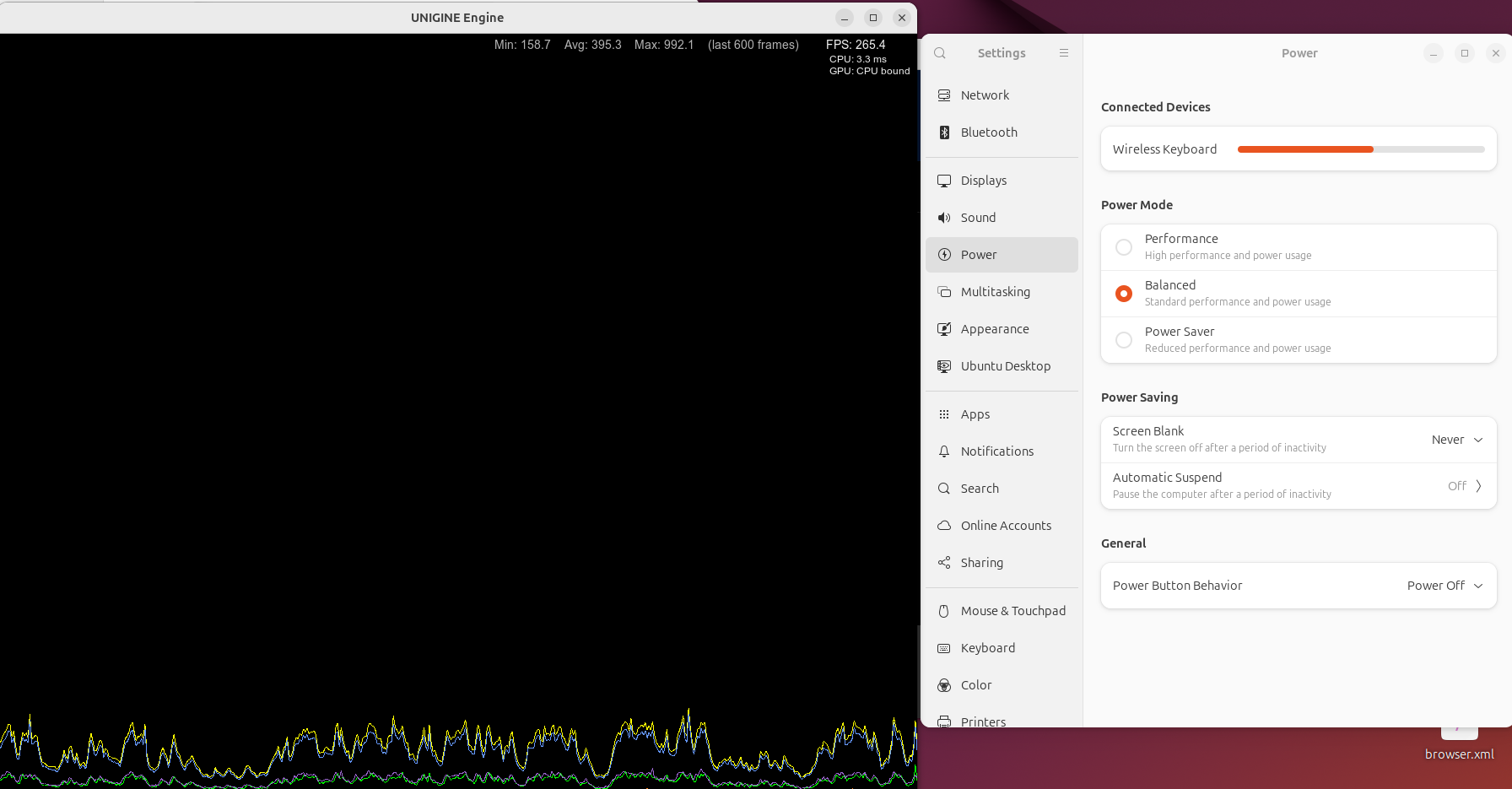

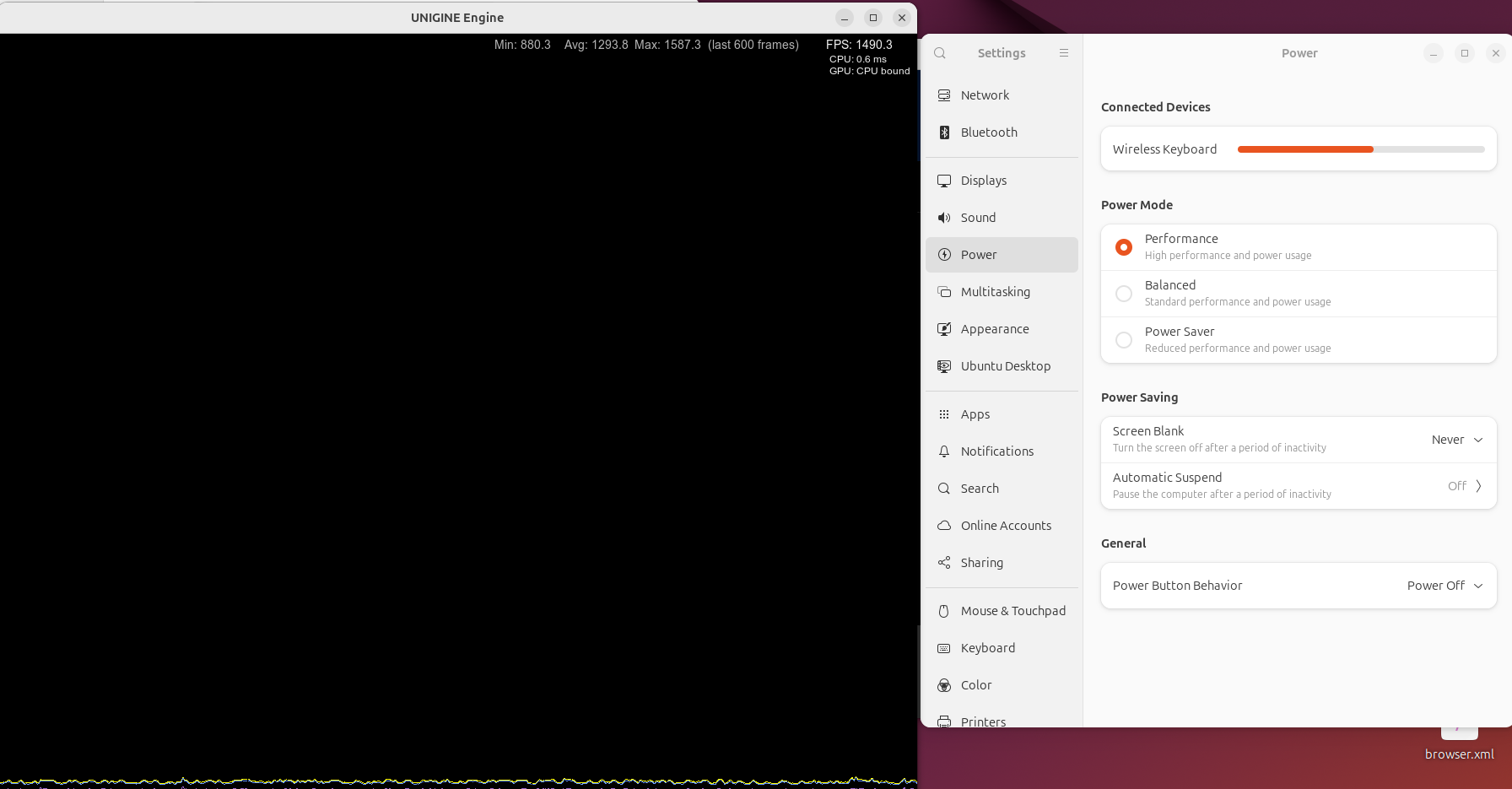

Energy Efficiency Setting#
If you develop an UNIGINE project in Linux, check the energy efficiency settings. It is noticed that an energy saving mode Balanced is set by default in the Ubuntu 24.04.1 LTS distribution. Due to this, the engine performance is reduced and developers are faced with spikes.
To prevent spikes and improve the engine performance we recommend switching the settings to Performance mode.
