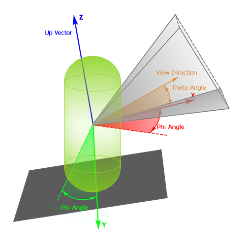

UNIGINE features several types of players that can be used for various reasons (they have additional parameters depending on their intended use):
Player Dummy is a simple viewport into the world that has no physical properties and cannot collide with objects.
Player Actor is a player with a physical body (having mass, etc.) approximated by a capsule that can only walk on the ground (it can be used in shooters, for example).
Player Persecutor is a free flying camera without a physical body that follows the target node at a specified distance (can be used, for example, for a third-person view in racing). It can collide with other objects, but cannot push or interact with them.
Player Spectator is a free flying camera without a physical body used to create a spectator mode. It can collide with objects but cannot push or interact with them.

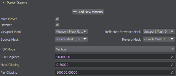

  1. Orient the currently used camera as required and configure its parameters (its position, rotation, and settings will be copied to a new camera).
  2. In the Camera panel, click . A new PlayerDummy camera with the specified settings will be added to the list of available cameras.
  3. Adjust the camera settings, if required.
You can also add a new camera via the Create menu (Create → Camera → Required camera type) and then set the desired settings in the Parameters window.
You can define for any camera whether it will be used for listening to sounds (Listener) and whether it will be set by default when the application is launched (Main Player). You can also define a set of masks that allow you to additionally control what will be heard and seen through this camera and what will be ignored (sound sources, reverberation, objects, and reflections). We'll deal with masks in more detail later.
