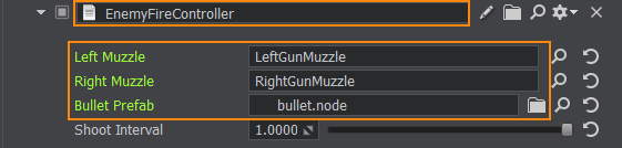

    Save all the files that we modified and then build and run the application by hitting Ctrl + F5 to make the Component System update properties used to assign the components to nodes. Close the application after running it and switch to UnigineEditor.
  2. If necessary, enable editing of the robot_enemy node and assign the EnemyFireController component to the robot_root Dummy Object.
  3. Drag and drop the LeftGunMuzzle and RightGunMuzzle Dummy Nodes to the corresponding fields of the EnemyFireController component.
  4. Drag and drop data/fps/bullet/bullet.node to the Bullet Prefab field.
The right gun muzzle is selected

  1. Save all the files that we modified and then build and run the application by hitting Ctrl + F5 to make the Component System update properties used to assign the components to nodes. Close the application after running it and switch to UnigineEditor.
  2. Enable editing of the robot_enemy node and assign the new component to the robot_root Dummy Node in the Parameters window.
  3. Drag and drop the player_hit_box node to the Player field of the EnemyLogic component. This node imitates the player body and is used in calculations. Make sure that the Intersection option is checked for player_hit_box.
  4. Drag and drop the robot_intersection_socket node of the robot_enemy node to Intersection Socket field. This is the node from which the robot will do intersection checks.
For debugging, you can enable Visualizer that will display the inner and outer attack radius, as well as the colored squares above the robot indicating:
