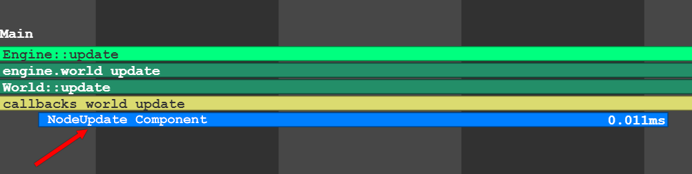

Profiling Custom Code#
You can use the Microprofile to inspect performance of your application logic.
Let's review a simple example. Suppose you have a C++ component that moves a node in the scene and enables/disables it depending on its position in the current frame.
To find out how long it takes to execute such logic, you can use the Profiler class methods:
  1. At the beginning of the update() method call Profiler::begin(). Specify the counter name that will be displayed in Micropofile as its argument. At the end of the method call Profiler::end().

  2. Build and run the Release version of the project by selecting the Release configuration (see the image below for MS Visual Studio) and hit Ctrl + F5.
  3. Run the microprofile_enabled 1 console command, if Microprofiler hasn't been enabled via SDK Browser yet.
  4. Open Microprofile in the web browser.
  5. Find the region with the name you passed to the Profiler::begin() function. In our example that is "NodeUpdate Component".
