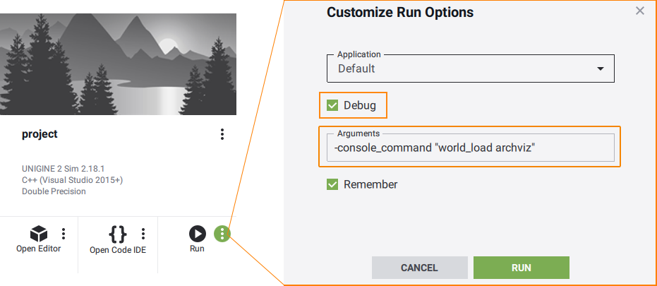

Save the world by hitting Ctrl + S. Switch to SDK Browser and change the default world for our application in Customize Run Options, by clicking an ellipsis under the Run button on the project's card (type -console_command "world_load archviz" in the Arguments field then check Remember and click Run to launch our application by clicking the Run button.
