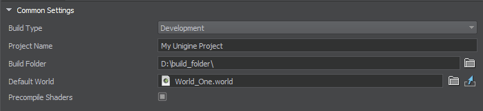

  • Open the project in the Editor. To assemble the project, choose File → Create Build. The Create Build window will open.
  • In the Create Build window, set the Build Type to Release.
  • Set the final application name in the Project Name field and specify the output folder in the Build Folder field. Make sure that your application world is set as the Default World.
