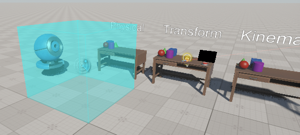

  1. First of all, create a trigger to define the rain area. On the Menu bar, choose Create -> Logic -> World Trigger and place the trigger near the Material Ball, for example. Set the trigger size to (2, 2, 2).

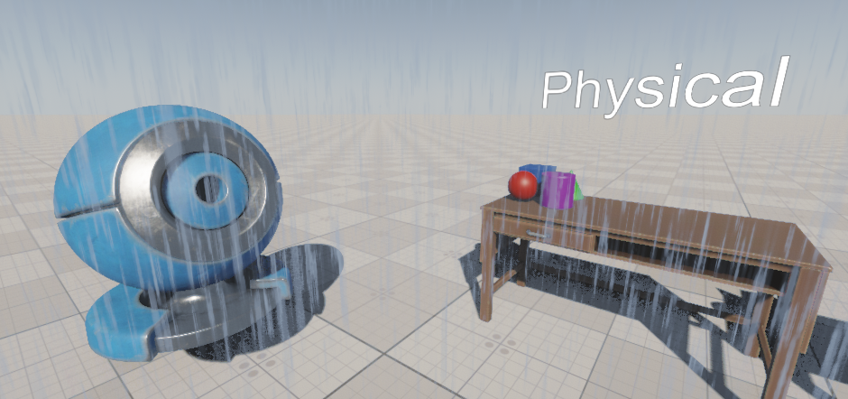

  6. Save changes (Ctrl+S), rebuild the project, and run it via SDK Browser, then try to enter the area defined by the trigger — it should raininside.
