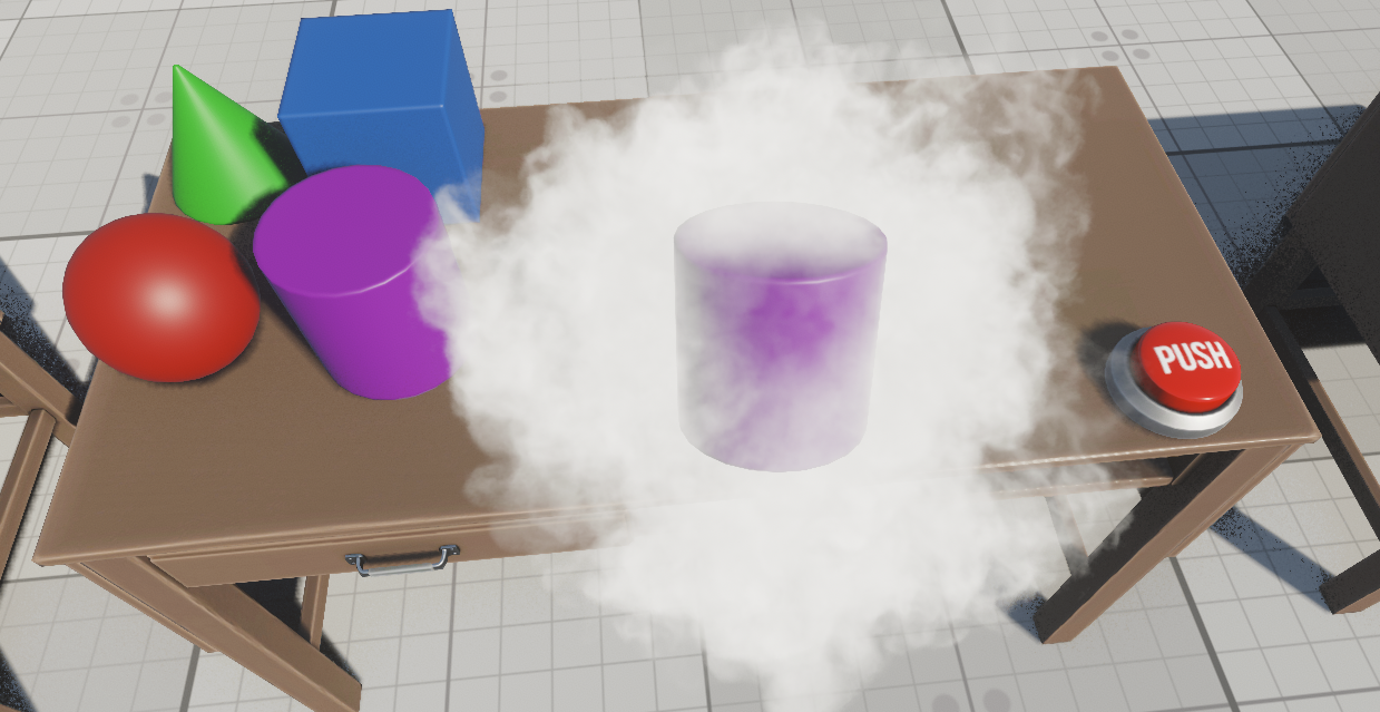

    Save changes (Ctrl+S) and run the application via SDK Browser.
Now, if you grab and hold the cylinder, it will generate smoke:
