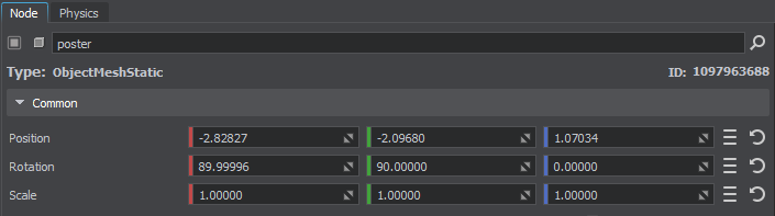

  3. Set poster's transformation as shown on the image below:

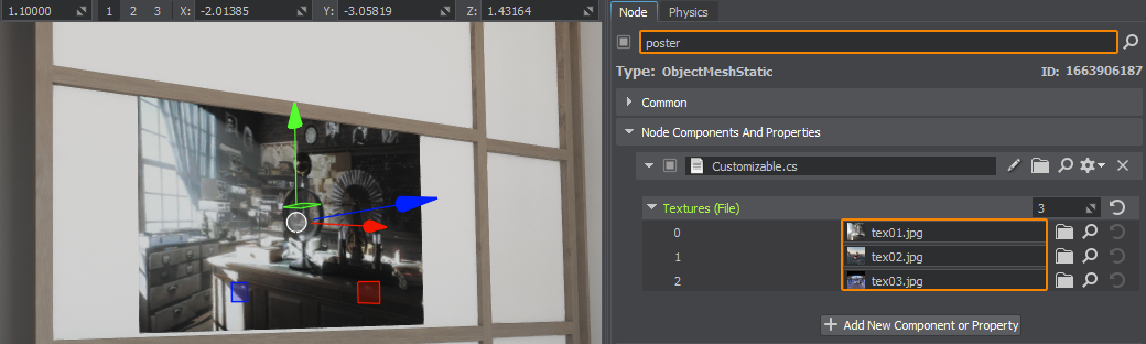

Let's save our files and then build and run our application by hitting Ctrl + F5 to make the Component System generate a property to be used to assign our component to nodes. Close the application after running it and switch to UnigineEditor.
Then let's assign our component to the poster node and fill the texture array (tex01, tex02, tex03).
Now the image on the poster can be changed in one click.
