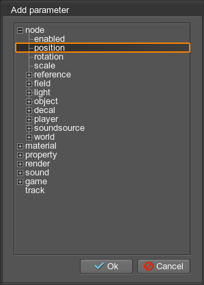

  1. Add a track that will animate the movement of our camera: Click . This will open the Add Parameter window.
  2. Select a parameter from the list, in our case it will be node → position.

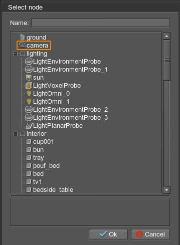

  3. Since the track animates the movement of the camera (Player) node, you must bind it to a specific node in the Select Node window that opens. Select the camera node and click Ok.

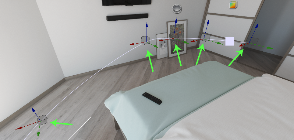

During playback, you can switch to the Editor Camera view in the viewport and see how the camera node moves along the trajectory. Here you can also move the manipulators placed at key points to change the trajectory in real time.
