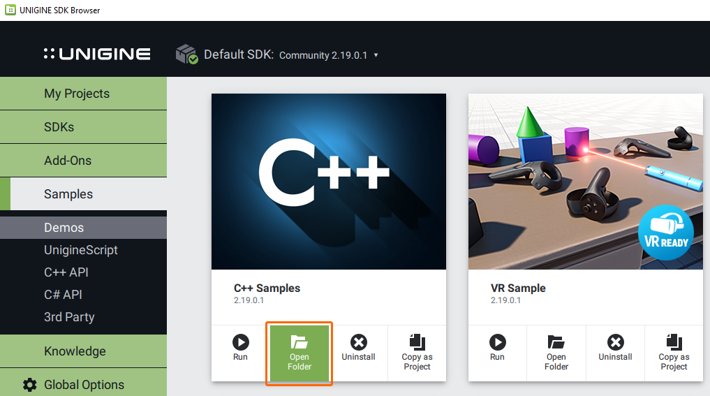

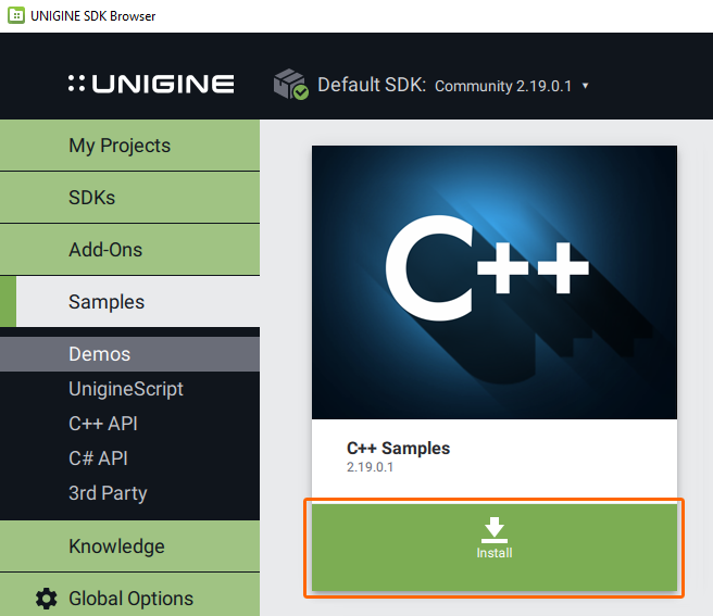

  1. Open the folder to which the C++ Samples suite was installed. Find the sample in the SDK Browser (Samples → Demos → C++ Samples) and click the Open Folder button.
    In case there is no Open Folder on the card, most likely the samples suite is not yet installed. To install it click Install, wait until the installation process is completed and click Open Folder.
  2. As the folder opens, go to the source\players subfolder and copy the FirstPersonController.h and the FirstPersonController.cpp files to your project's source folder.

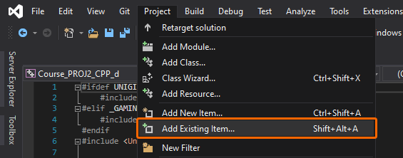

  3. Go back to IDE and choose Project → Add Existing Item in the main menu.
  4. In the file dialog that opens select the files you've just copied (FirstPersonController.h and FirstPersonController.cpp) and click Add.

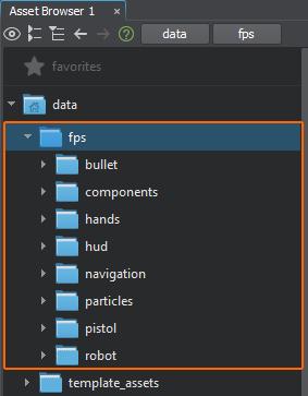

For a first-person setup you will need the hands and weapon models and animations previously created in a 3D modeling software. If you have your own assets, that's great, otherwise you can use our ready-to-use assets available in the data folder.

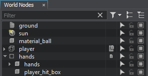

We'll start with adding hands, and then attaching a pistol to them. In Asset Browser, find the data/fps/hands/hands.fbx asset and add it to the scene.
To simulate a player's body that takes damage when hit by enemy bullets, let's create an additional object (it will approximate the player's body with a box):
  1. In the Menu bar, choose Create → Primitive → Box to create a box primitive of the size (1,1,2), add it to the scene and rename to player_hit_box.
  2. Add it as a child to the hands Dummy Node and reset its position to the parent one. And for player_hit_box let's enable the Intersection option in the Surfaces section of the Parameters window.
  3. Adjust the position of the player_hit_box so that it is placed immediately below the hands.
  4. Make it invisible by clearing its Viewport mask in the Node tab of the Parameters window using the Clear All button. Also clear the Shadow mask to disable shadows rendering. You'll get something like this:
We'll assign the Health component to it later.

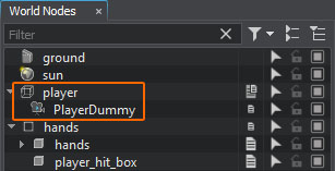

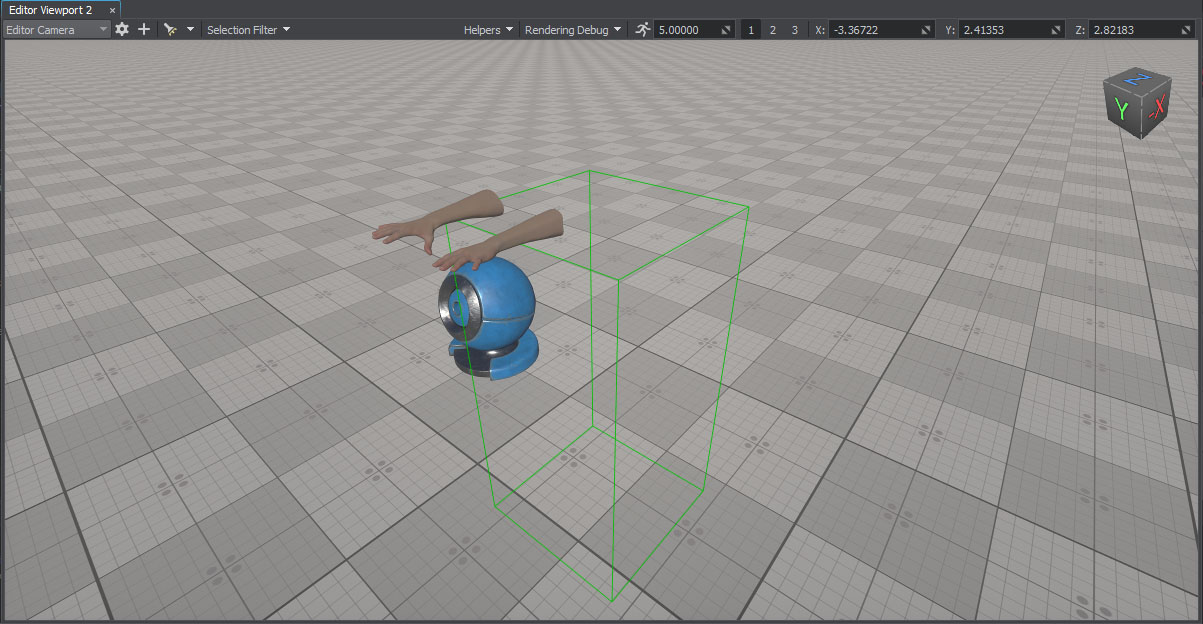

  1. Right-click the player Dummy Object and select Create → Camera → Dummy. Place the new created camera somwhere in the scene.
  2. In the Node tab of the Parameters window, reset the position of the camera to the player position. Then adjust the rotation so that the camera is directed forward: set the rotation around the X axis to 90.

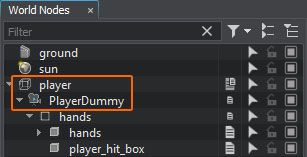

  3. Add the hands Dummy Node as a child to the PlayerDummy node.
  4. Adjust the position of the hands so that you can see them through the PlayerDummy camera. Transformation of the player's body should also be adjusted.
  5. In the Parameters window, change Near Clipping and FOV Degrees values of the PlayerDummy node: it will help you to get the required camera view.
  6. Check the Main Player box in the parameters of the PlayerDummy to make it the main camera.

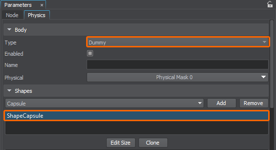

  7. Select the player Dummy Object and go to the Physics tab of the Parameters window. Here add a Dummy body and a Capsule shape to the object.
    To avoid hands falling under gravity, adjust the position of the Capsule Shape to coincide with the position of the player_hit_box node.

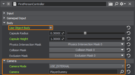

  8. Select the player Dummy Object and go to the Node tab of the Parameters window.
  9. In the Node Components and Properties section, choose Camera → Camera mode → USE EXTERNAL.
  10. Drag and drop the PlayerDummy node to the Camera field.
    And make sure to check the Use Object Body in the Body group of the FirstPersonController component's parameters.

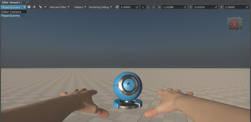

Now you can switch to the PlayerDummy camera in the Editor Viewport.

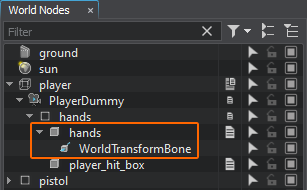

Attaching a Weapon to the Hands#
In UNIGINE, you should use the Skinned Mesh with bones for animated models. Our FBX model of hands contains several bones. We can attach the object to a particular bone to make it follow this bone. For this purpose, we use a WorldTransformBone node that has a controlled object (a pistol in our case) as a child, and the Skinned Mesh with bones as its parent.
  1. In the Asset Browser, find the data/fps/pistol/pistol.fbx asset and add it to the scene.

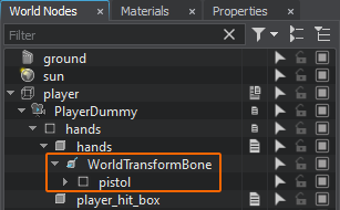

  2. In the Menu bar, choose Create -> Mesh -> SkinnedBone: a WorldTransformBone node will be created. Add it as a child to the hands Skinned Mesh (the one that is inherited from the hands Dummy Node).
  3. In the Bone drop-down list, select joint_hold. This will be the bone to which the pistol will be attached.
  4. Make the pistol a child of the WorldTransformBone node. Reset its relative position and rotation to zero if needed.

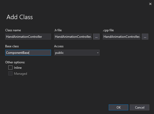

  1. Add a new HandAnimationController component class in the IDE (Project → Add Class).
    Copy and paste the following code to the corresponding files:
