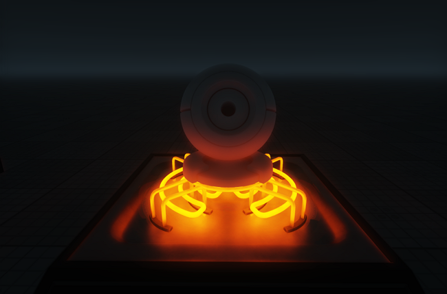

Emissive Objects#
It is also possible to make almost any geometry emit light (e.g. to make neon signs or a glowing electric stove). This is done using Emission, and materials have a corresponding set of parameters that allow you to set the glow brightness and color. By default, the glow from such objects does not affect the environment. However, it is possible to bake lighting from an emissive object to GI (we'll review this in detail a bit later) or calculate it in real time with Screen-Space GI.

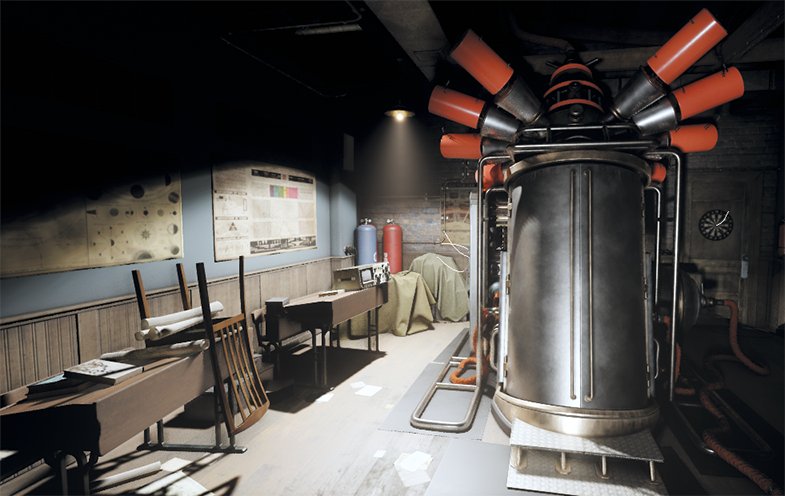

How Shadows Are Drawn and Why Too Many Sources May Cause Performance Drop#
Now we know what types of light sources are available and we want to hang the Sun (World Light) outside the window, light the room with a lot of spotlights (Projected Light), and a lot of bulbs (Omni Light), or even a garland! But, it is said that a large number of light sources can be very hard on performance, and shadows are the culprit! To understand why regular shadows are so expensive, we need to understand how they are drawn.
Shadows in engines (and UNIGINE is no exception here) are drawn using the traditional Shadow Mapping method, which allows you to define lighted and darkened areas for each light source. This method is based on the use of Z-buffer (depth buffer). First, we draw the scene into the Z-buffer from the point of view of the light source to define the pixels visible from this point and the distances to them — thus a special buffer (shadow map) is created, which is a two-dimensional texture. Then, when the scene is drawn from the observer's point of view, the texture coordinates are compared with the shadow map: if this comparison says that the corresponding pixel is invisible from the point of view of the light source and therefore should be shaded, it is painted with a dark color.
This is how it's done for a directional Projected source, but if we have an Omni point source (an ordinary light bulb, for example), then instead of one depth buffer we have to draw a whole cube map (6 depth buffers, one for each side of the cube surrounding the light source). Thus, one bulb requires drawing the scene again, albeit highly simplified, but 6 more times! And this all is for one frame! Now it becomes clear why a large number of light sources significantly increases the load on the GPU, so all sorts of tricks are used to minimize the number of sources for which shadows are actually calculated. Depending on the scene type, different approaches are used.
