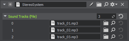

Let's save our files and then build and run our application by hitting Ctrl + F5 to make the Component System generate a property to be used to assign our component to nodes. Close the application after running it and switch to UnigineEditor.
Assign the StereoSystem component to the tv1 node in the scene (interior -> tv1) and add tracks from the archviz/sounds folder to the Sound Tracks list:
