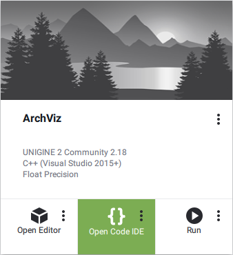

1. Open Project in IDE#
First, open your project in an IDE (Microsoft Visual Studio is recommended) - go to SDK Browser and choose Open Code IDE on your project's card.

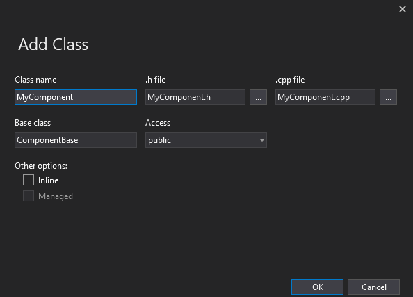

2. Add New C++ Component Class#

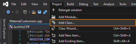

In an IDE create a new C++ class (Project → Add Class) and call it MyComponent.
Make sure it inherits from the ComponentBase class. You can build a whole hierarchy using your own components, by inheriting some components from others in accordance with the OOP principles (we'll review this in detail later).
Two files*.h and *.cpp will be added to your C++ project.

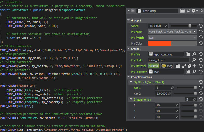

  2. Declare parameters with their default values (if any). The simplest way to declare a parameter is to use the following macro (optional arguments are enclosed in square brackets []):
    PROP_PARAM(param_type, name[, default_value, title, tooltip, group]);
    A set of macros enables you to define multiple types of component parameters to be displayed and adjusted in UnigineEditor. See the the ComponentBase class documentation for the detailed information about supported parameter types and attributes.
    Possible parameter types
    The list of available macros includes the following ones to declare complex-type parameters (arrays, structures, and arrays of structures):
    PROP_STRUCT(type, name);
    PROP_ARRAY(type, name);
    PROP_ARRAY_STRUCT(type, name);

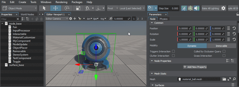

After successful registration all available properties associated with your C++ components are displayed in the Properties window as children of the basic node_base property.
The component is ready, but now it must be assigned to some node, otherwise its code won't be executed. Decide which object you want to rotate (e.g. Material Ball), drag the property (MyComponent.cpp) from the Properties hierarchy and drop onto this object (you can drop it on the object directly in the viewport or on the node in the World Nodes window).
In the Parameters window set the desired Angle value with a slider and save the world by hitting Ctrl + S.

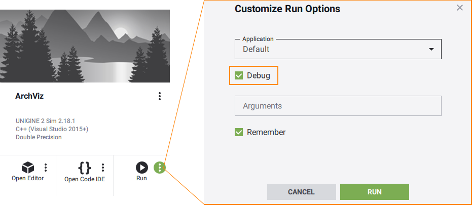

Now, we're ready to launch our application via the SDK Browser by selecting the project on the Projects tab and clicking Run. But before doing so let's make sure, that appropriate Customize Run Options (Debug version in our case) are selected, by clicking an ellipsis under the Run button (check Debug and Remember then click Run).

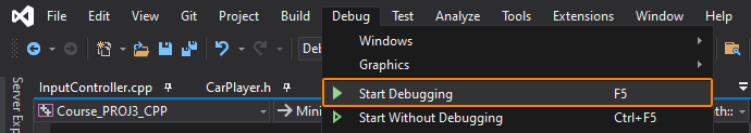

The Microsoft Visual Studio environment is known for its excellent debugging tools. You can test the source code of C++ components while your application is running, whether the application is launched via the SDK Browser or created and running from the IDE.
Debugging in IDE#
To compile all your components, build the application, and debug it by running it directly from the IDE, select Debug → Start Debugging (or press F5):
Now you can add the necessary breakpoints and just press F5 to start the debugging process.

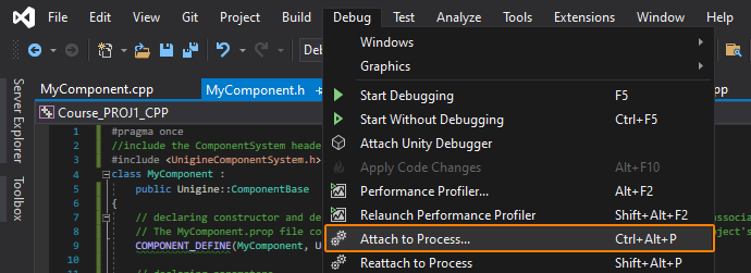

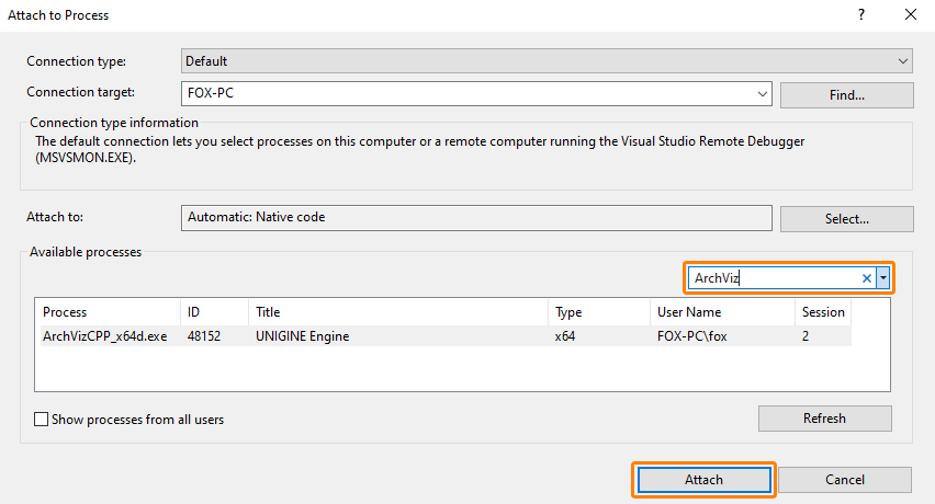

You can also connect Visual Studio debugger to an instance of your application that is already running. The most common case is launching it via the SDK Browser. Just add necessary breakpoints and select Debug → Attach To Process from the main menu.
Type your project's name in the search field in the Available processes section to find the process you need. Select it in the list and click Attach

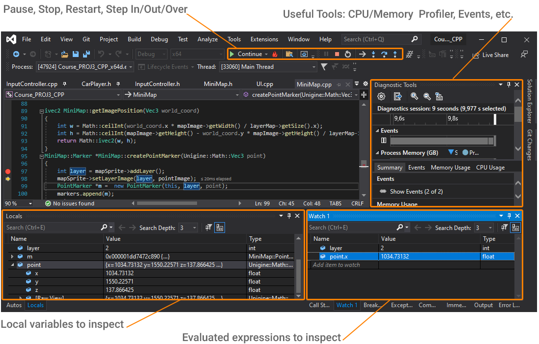

Breakpoints are used to pause your application by stopping execution of your code and giving you a chance to inspect and analyze your program's operation. You can check values of variables, and move step-by-step through your code.
To set up a breakpoint put the cursor to the desired line of your code and press F9 or use the menu.
