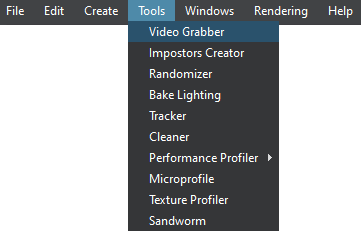

To open Video Grabber, select the appropriate item from the Editor menu:
The Video Grabber window will open:

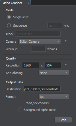

The settings available in it allow you to select:
  • Shooting mode: single frame or sequence.
  • Camera used to take the picture.
  • Image parameters: antialiasing, resolution and image format.
To capture a screenshot, we'll require the Single shot mode. The sequence of actions to create a screenshot is as follows:
  • Set the desired camera view.
  • Select the required camera from the list: the standard viewport camera (Engine Camera) or any other camera available in the scene (the "*" button will refresh the list).
  • Specify the required resolution (to use the current viewport size, press the "*" button).
  • Select antialiasing mode (supersampling multiplier) to improve image quality and remove the jagged effect on diagonal edges.
  • Specify the target folder and select the desired output format (for example, JPG will provide the best compression and EXR supports 16-bpc color depth).
  • Now all you need to do to get a screenshot is to click Grab.

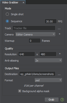

Capturing Frame Sequences#
To capture a sequence of frames, we need a track with an animation that we created in the Tracker tool. Frame sequences are captured in a special mode (not in real time), and this allows you to get a given frame rate on any hardware.
Switch Grabber to the Sequence mode and do the following:
  1. Set the desired frame rate.
  2. Specify the animation track that we prepared for our project in Tracker (tracks/camera_animation.track).
  3. Set the desired screen resolution, antialiasing mode, target folder, output format, and other settings (just like we did for screenshots).
  4. Now you can start capturing frames by clicking the Grab button. If you want the editor to continue capturing even when out of focus, enable the Keep Running In Background option (Settings → Editor).
  5. When the capture process is complete, you will find the sequence of frames as a set of images in the specified target folder.
