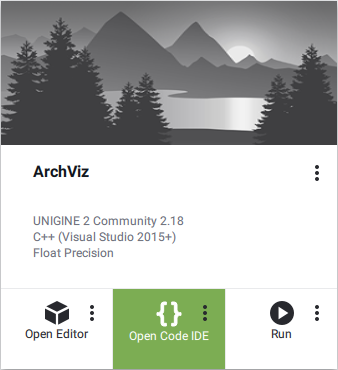

Open your project in an IDE - go to SDK Browser and choose Open Code IDE on your project's card.

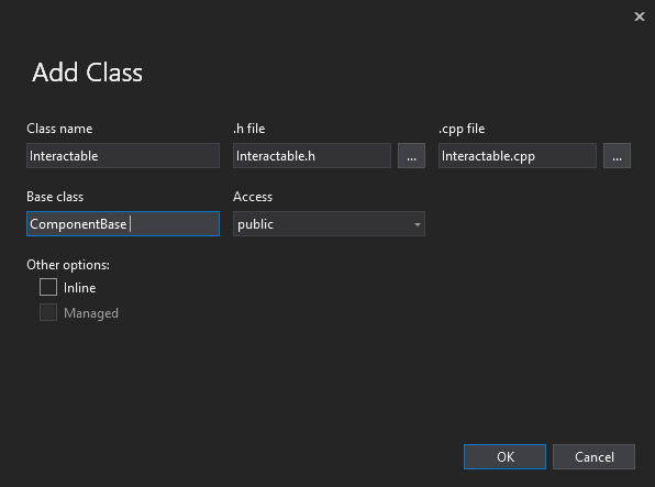

In an IDE create a new C++ class (*.h and *.cpp files) and call it Interactable. Make sure it inherits from the Unigine::ComponentBase class.

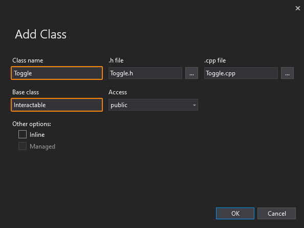

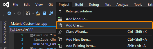

Similarly, in your IDE add a new class (Project → Add Class), call it Toggle, and type Interactable in the Base class field instead of the standard ComponentBase class.

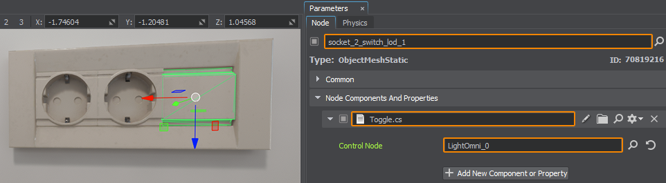

Now let's assign this component to the light switches in the room, and associate them with the corresponding light sources:
Assign the Toggle component to the socket_2_switch_lod_1 node of the left bedside switch, and drag the LightOmni_0 node into the Control Node field.

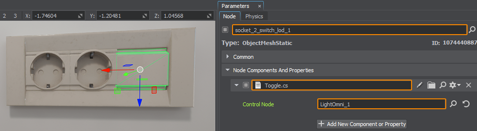

Similarly, assign the Toggle component to the socket_2_switch_lod_1 node of the right bedside switch and drag the LightOmni_1 node into the Control Node field.
