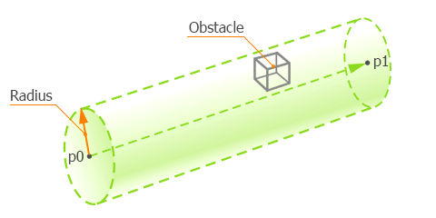

Ptr<Obstacle> getIntersection( const Math::Vec3 & p0, const Math::Vec3 & p1, float radius, int mask, const Vector< Ptr<Node> > & exclude, Math::Vec3 * intersection )
Performs intersection to find if a pathfinding Obstacle is located within the cylinder between two points. The specified obstacles will be ignored.
World space coordinates are used for this function.

Ptr<Obstacle> getIntersection( const Math::Vec3 & p0, const Math::Vec3 & p1, float radius, int mask, const Ptr<GameIntersection> & intersection )
Performs intersection to find if a pathfinding obstacle is located within the cylinder between two points.
The following example shows how you can get the intersection point (vec3) of the cylinder between two points with an obstacle. In this example we specify a cylinder from the point of the camera (vec3 p0) to the point of the mouse pointer (vec3 p1) with the specified radius. The executing sequence is the following:
  1. Define and initialize two points (p0 and p1) by using the Player::getDirectionFromScreen().
  2. Create an instance of the GameIntersection class to get the intersection point coordinates.
  3. Check, if there is an intersection with an obstacle. The Game::getIntersection() function returns an intersected obstacle when the obstacle appears in the area of the cylinder.
  4. After that GameIntersection instance gets the point of the nearest intersection point and you can get it by using the getPoint() function.
