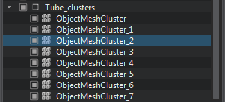

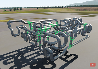

  • Mesh Cluster contains only identical meshes. So, if you need to create a complex construction that contains several types of identical meshes (like the tube construction on the picture below), you will have to bake several mesh clusters:
    Mesh Clusters in World Hierarchy
    Meshes Baked to Mesh Cluster (Click to watch the video tutorial)

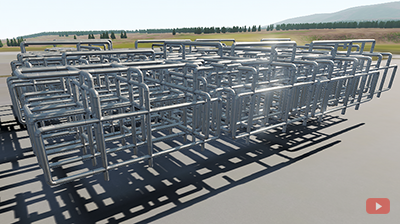

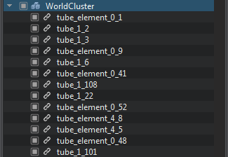

  • World Cluster contains node references. It means that you can bake different objects into the cluster and then manage them. For example, all details of the tube construction can be baked to the single world cluster:
    Expanded World Cluster in World Hierarchy
    Different Nodes Baked to World Cluster (Click to watch the video tutorial)

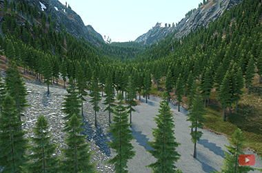

  • Mesh Clutter contains only identical meshes randomly scattered across the area.

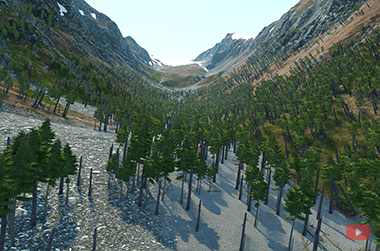

  • World Clutter contains randomly scattered node references. It means that you can bake different objects into the clutter and randomly position them.
Mesh Clutter with Identical Meshes (Click to watch the video tutorial)
World Clutter with Different Nodes (Click to watch the video tutorial)
