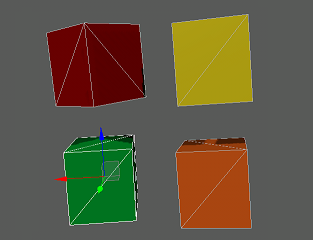

    Selection can be performed in two modes: Window and Crossing. You can choose the mode via the drop-down list near the selection icon () on the Positioning panel:
    • Window Mode requires the whole object to be inside the selection box.
    • Crossing Mode makes the object selected if any part of it is inside the selection box.
    Selection box in Window mode
    Selection box in Crossing mode

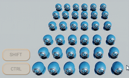

  • Select one of the nodes, press and hold Shift to add nodes to the selection and Ctrl to remove.
    Add and remove nodes from selection

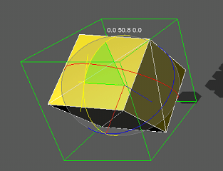

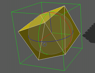

When the node is selected, the following is shown:
  • Wireframe of the node
  • Bounding box of the node
  • Bounding box of the selected surface (or surfaces)

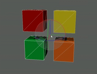

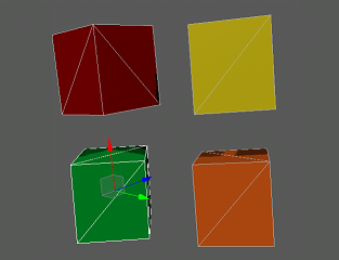

Moving, Rotating and Scaling Nodes#
To transform nodes, choose the required transformation mode (manipulator) on the Positioning panel of the Toolbar:
You can specify the position and rotation coordinates and the scale factor via the Parameters window.

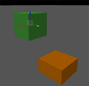

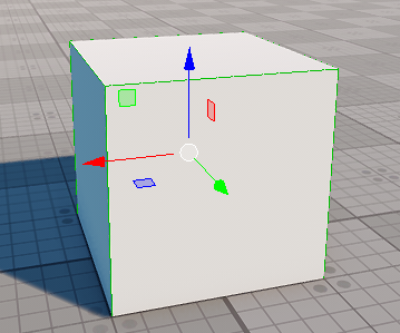

Move Nodes#
To move the node:
  1. Choose the manipulator on the Positioning panel (or press W).
  2. Click the required node. The axes along which the node can be moved will be shown.
    Move Node
  3. Move the node:
    • If the arrow manipulator is dragged, the node can be moved along the selected axis.
    • If the rectangle manipulator is dragged, the node can be moved by two axes.
    • If the circle manipulator is dragged, the node can be moved in the screen plane.
    Move along 1 axis
    Move by 2 axes
    Move in the screen plane

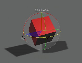

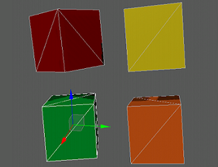

Rotate Nodes#
To rotate the node:
  1. Choose the manipulator on the Positioning panel (or press E).
  2. Click the required node. The sphere with the axes, around which the node can be rotated, will be shown.
    Rotate node
  3. Rotate the node:
    • If an axis of the sphere is dragged, the node is rotated around the axis.
    • If the sphere is dragged, the node can be rotated freely around several axes.
    Rotate around 1 axis
    Rotate freely

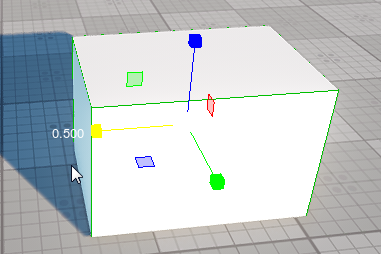

Scale Nodes#
To scale the node:
  1. Choose the manipulator on the Positioning panel (or press R).
  2. Click the required node. The axes, along which the node can be scaled, will be shown.
    Scale Node
  3. Scale the node:
    • If the red, green, or blue cube manipulator located at the end of any axis is dragged, the node is scaled along this axis.
    • If the red, green, or blue square manipulator is dragged, the node is scaled along two axes.
    • If the white cube manipulator at the origin is dragged, the node is scaled along three axes.
    Scale along 1 axis
    Scale along 2 axes
    Scale along 3 axes
It is also possible to scale the selected node with the given step by using the arrow keys:
  1. Choose the manipulator and select the node you want to scale.
  2. Enable snapping by scale and specify the step.
  3. Scale the node:
    • To scale along the X axis, press left and right arrows.
    • To scale along the Z axis, press up and down arrows.

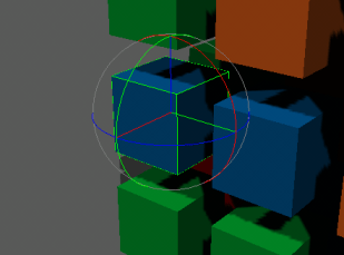

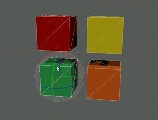

Pivot Point and Coordinate System#
Transformations of the node are relative to the pivot point. The pivot point is used to control the way nodes rotate and scale.
To rotate or scale several nodes, select them, choose the required manipulator, and specify the position of its pivot point by using the pivot point toggle.
If one node is selected, the pivot point position will not change when toggling.
  • If the button is active, the pivot point is set to the center of selection.
  • If the button is active, the pivot point is set to the center of the last selected node.
To toggle the pivot point, you can press Z.

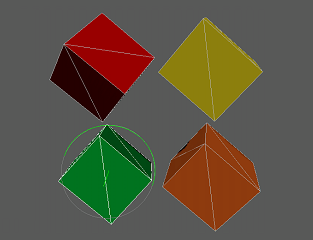

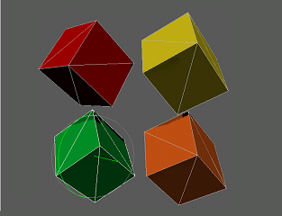

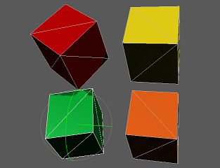

For example:
  • If you select several nodes, set the pivot point toggle to Center, and rotate these nodes, they rotate around the center of selection as follows:
    Pivot point in the center of selection
    If you scale the nodes, they are scaled out from or in toward the center of selection.
  • If you set the pivot point toggle to Pivot and rotate the selected nodes, each node will rotate around its center as follows:
    Pivot point coincides with the center of the last selected node
    If you scale the nodes, each node is scaled relative to its center.

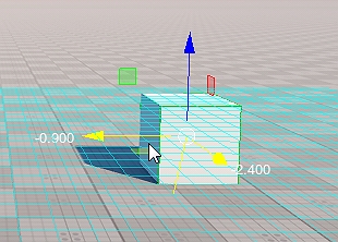

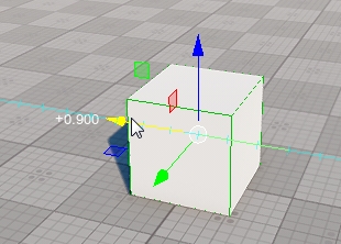

Snapping Nodes by Grid#
Snapping a node by the grid enables to position a node along the axis or over the grid with a given step (in units).
Snapping should be enabled when moving the node by using arrow keys. If disabled, the node is moved by 1 unit by default.
To snap a node by grid:
  1. Choose on the Positioning panel (or press Shift+W)
  2. Specify the grid step using the drop-down box:
    Now you can move any node in the world along an axis or across a grid with the given step.
  3. Move one of the nodes:
    • If one axis is chosen (an arrow manipulator is dragged), the node is aligned along the axis.
    • If a node is repositioned by two axes (a rectangle manipulator is dragged), the node will be aligned by a horizontal or vertical grid.
    Snapping by an axis
    Snapping by a grid stripes

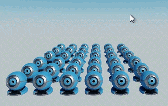

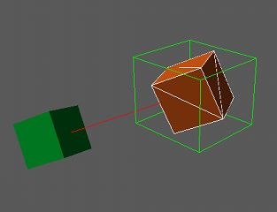

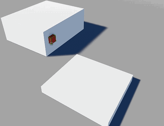

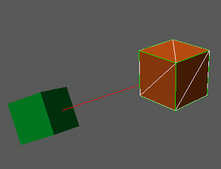

Snapping Nodes to Surface#
Snapping a node to a surface of another node provides pixel-perfect positioning of the nodes relative to each other.
To snap a node to the surface:
  1. Select a node that should be snapped.
  2. Choose on the Positioning panel (or press Alt+W).
  3. Specify snapping settings via the following panel:
    Option Description
    Offset from surface Specifies the distance from the node's pivot point to the surface (in units).
    • To increase/decrease the distance to the surface, use the WHEEL UP/WHEEL DOWN hot keys.
    • To reset the distance to the surface, use the MIDDLE CLICK hot key.
    Orient by normal Specifies whether the node should be oriented by the surface normal.
    The hot key is RIGHT CLICK
  4. Move the node until the red stripe intersects the required surface of the other node. Click the left mouse button to place the node.
    To abort placement, press ESC.
The node will follow the mouse as on the image below:
Node is oriented by normal
Node is not oriented by normal

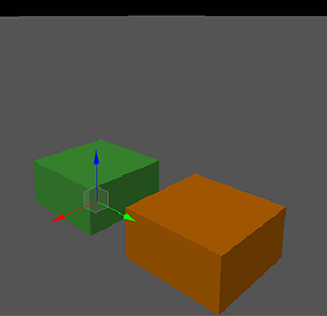

Dropping Nodes to Ground#
Dropping a node to the ground means positioning a selected node to the surface below this node.
To drop a node to the surface:
  1. Select a node (or several nodes) that should be dropped.
  2. On the Positioning panel, find and specify the required settings in the drop-down window:
    Option Description
    Intersection mask Sets an intersection mask that defines whether a node (or nodes) will be positioned on a surface to which it is dropped. A node will be positioned on a surface if they both have matching intersection masks. Otherwise, the node will penetrate the surface.
  3. Click to drop a node (nodes).
    Initial position of a node
    Node dropped to surface (default settings)
