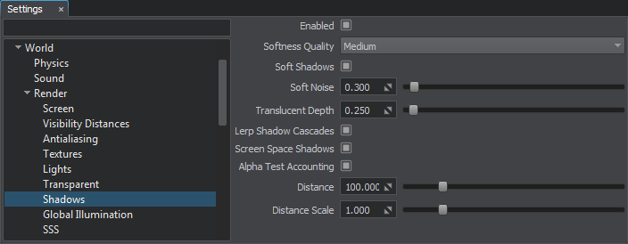

Shadows Settings
Enabled Toggles rendering of shadows on and off.
Softness Quality Softness quality of shadows. The higher the value the softer (more blurred) the shadows are. The option has an effect only if Soft Shadows is enabled. Available values:
  • Low — low quality
  • Medium — medium quality
  • High — high quality
Soft Shadows Toggles rendering of soft shadows on and off. When enabled, shadows become blurred on the edges.
Soft Noise A control to adjust the level of noise at the edges of shadows. Has effect if medium or high-quality softness is enabled for shadows.

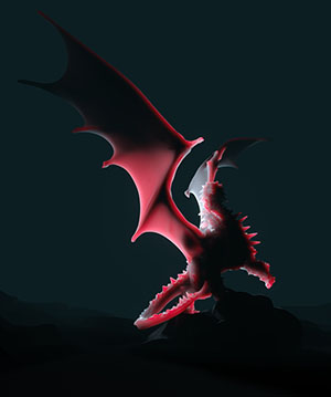

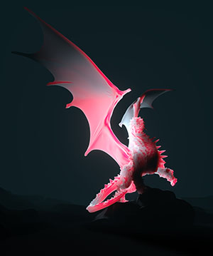

Translucent Depth A multiplier for the depth of light penetration into materials. Shows to what extent the translucent material is permeable to light.
Translucent Depth = 0.06
Translucent Depth = 0.4

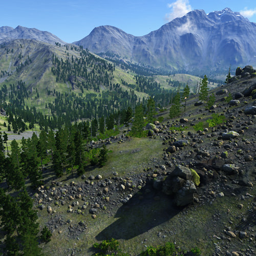

Shadow distance
Shadow Distance = 1200 units

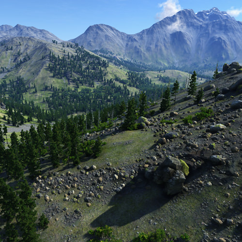

Shadow distance
Shadow Distance = 80 units
