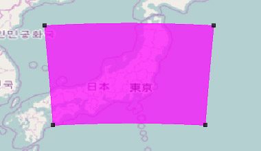

A procedural data source is assigned with a Houdini digital asset (*.hda file) and can be used to refine data from elevation and landcover data sources. It can also be used to refine the data produced by another procedural data source. The area for which refinement is to be performed is determined by an adjustable bounding rectangle, which can be manually placed inside the Play Area on the Preview panel.
Due to the equirectangular projection, it looks like a trapezium near the terrestrial poles.

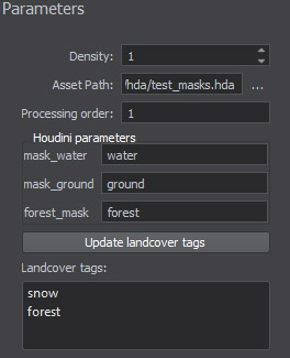

  3. Specify the following data source parameters in the Parameters panel.
    Density The density of the procedural data source, in meters per pixel. A procedural data source grabs the data for the Houdini asset from underlying data sources with the set density value (upsampling is performed if necessary).
    Asset path The path to the Houdini digital asset (*.hda file) that performs data refinement.
    Processing order Priority of the data source in the whole generation process.
    For more information see the Processing Priority section.
    Houdini parameters The list of parameters required by the selected Houdini digital asset (if any). These parameters are specified when the digital asset is created and are used to pass certain numerical values or tags from the Landscape Tool to configure refinement procedure (e.g. you can specify landcover tags to be treated by the Houdini asset as rivers for elevation adjustment).
    Currently supported types include float, integer, dropdown list.
    Landcover tags The list of tags of all underlying landcover data sources. If the bounding rectangle of the procedural data source covers (completely or partially) a landcover data source, all tags of the latter will be added to this list.
    A Houdini asset can generate its own landcover tags on the basis of input data. To add these tags to the list of available landcover tags use Update landcover tags button.
