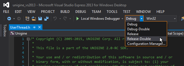

    1. Open the solution file for Visual Studio: <UNIGINE_SDK>\source\engine\unigine_vs2013.vcxproj or <UNIGINE_SDK>\source\engine\unigine_vs2015.vcxproj. The postfix shows the version of Microsoft Visual Studio.
      If you use Visual Studio 2017, open unigine_vs2015.vcxproj and click Upgrade.

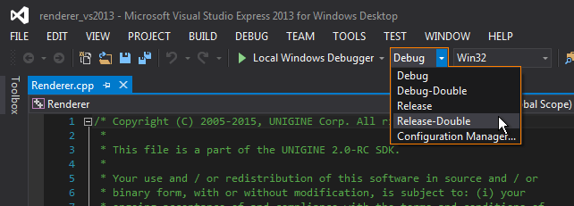

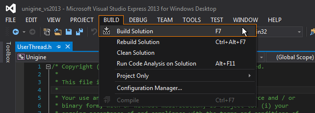

    2. Specify the solution configuration: Debug, Debug-Double, Release or Release-Double.

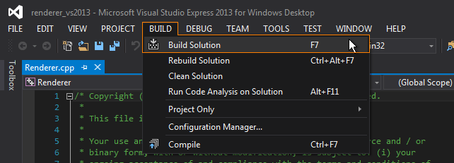

    3. Choose Build -> Build Solution in the menu or press F7.

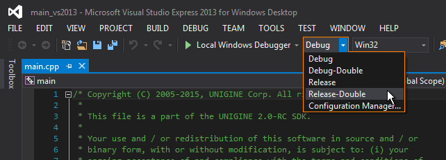

    1. Open <UNIGINE_SDK>\source\apps\main\main_vs2013.vcxproj or <UNIGINE_SDK>\source\apps\main\main_vs2015.vcxproj. The postfix shows the version of Microsoft Visual Studio.
      If you use Visual Studio 2017, open main_vs2015.vcxproj and click Upgrade.

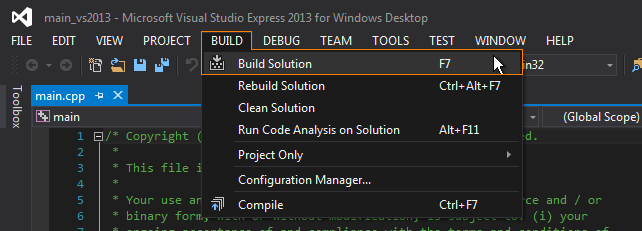

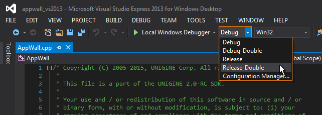

  • Open the solution of the necessary plugin to rebuild. All plugins are located in <UNIGINE_SDK>\source\plugins\.
  • Specify the solution configuration: Debug, Debug-Double, Release or Release-Double.
  • Choose Build -> Build Solution in the menu or press F7.
