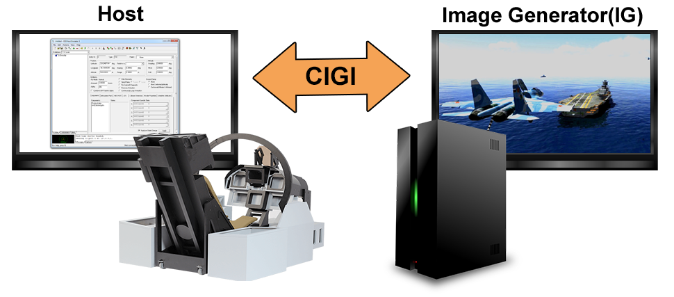

Common Image Generator Interface (CIGI) protocol is a standard way for a host device to communicate with an image generator (IG). It is widely used in the simulation industry.

CIGI Host - IG communication
