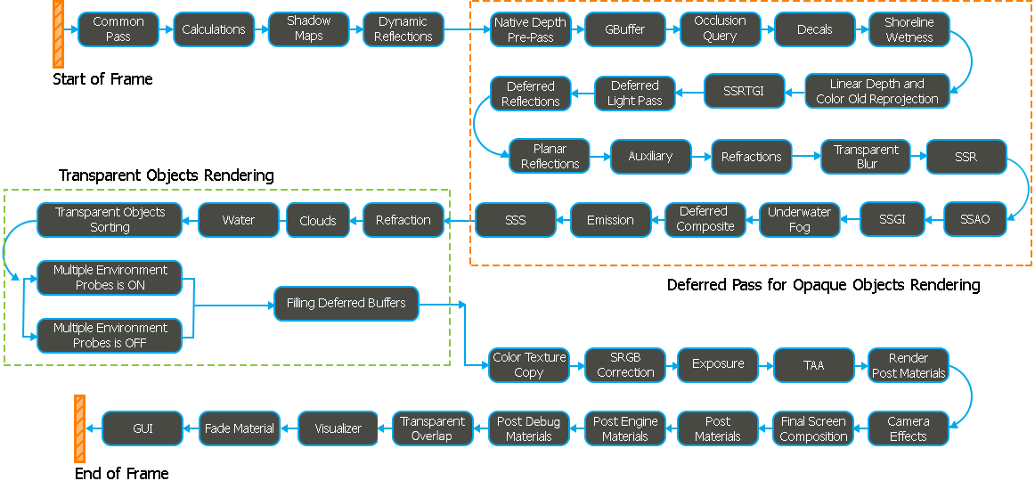

Rendering Pipeline Overview#
A frame is a complex structure including a lot of different calculations and textures rendering.
Here is the rendering pipeline, all stages are performed during one frame composition. Some stages can be switched off, if necessary: decals rendering stage, auxiliary pass, post-materials, etc.
During rendering, the engine initializes necessary texture buffers and most of them are not cleared completely (the engine cuts out sky areas). Some passes just re-use these already created buffers. Such optimizations help to increase the rendering performance.
The schematic representation of the rendering pipeline displays the main stages of the rendering sequence.
Schematic representation of the rendering pipeline

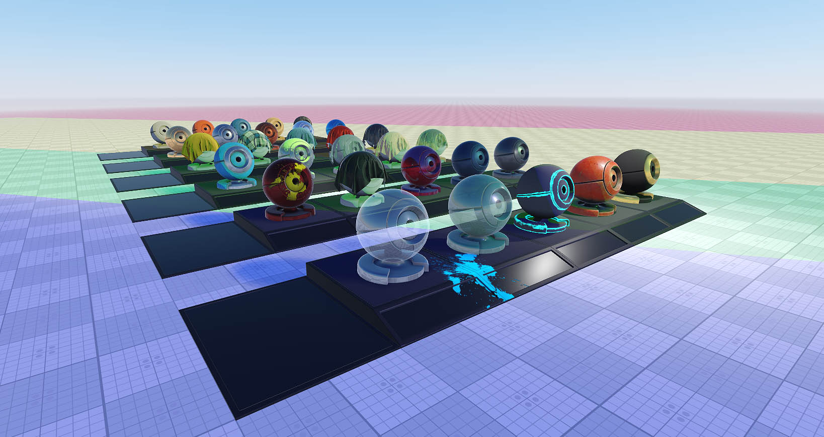

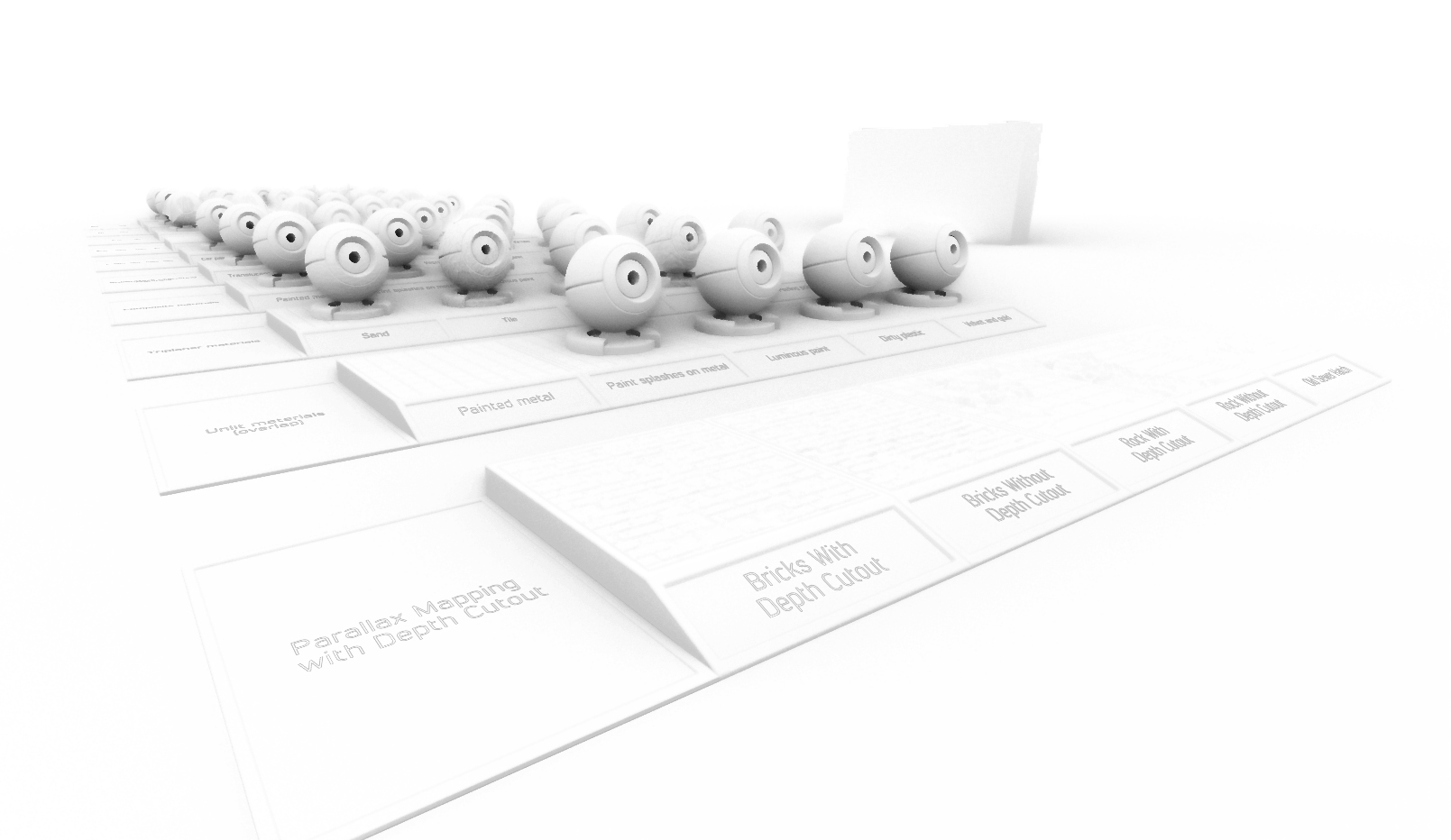

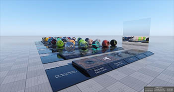

The frame rendering process will be illustrated by screenshots from a simple test scene with a variety of materials (transparent and opaque), environment probes, decals, planar reflections, different light sources.

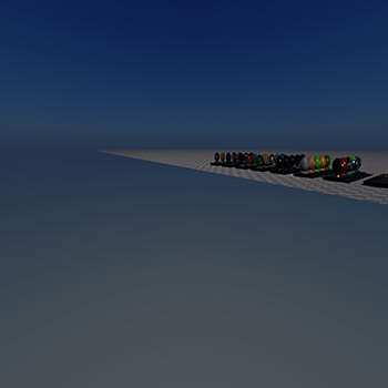

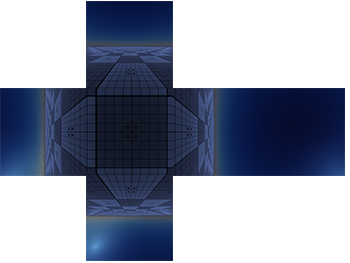

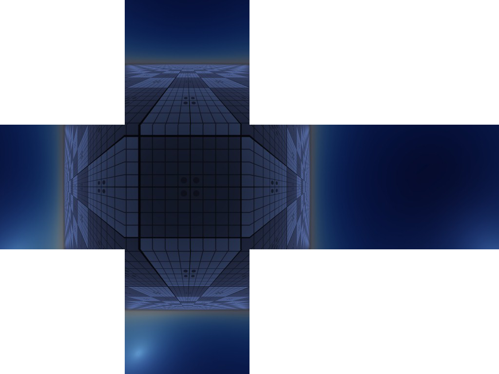

The Common pass is the very first step of the rendering sequence. In this pass, environment LUTs and the Environment cubemap are rendered. These textures are rendered only once before all the geometry in the scene and will be used further for the final screen composition: for scattering rendering and non-dynamic reflections.
Environment cubemap is composed of six pieces (256x256 px each).
Schematic representation of the 1x256 LUT textures.
LUT textures are represented as 1x256 px textures taken from the current state of the loaded LUT textures for scattering.

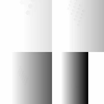

For the world lights, the engine creates cascaded shadow maps. World Light's shadow map is rendered into the orthographic projection.
The shadow map of the world light source is rendered into texture divided into four parts (since the 4 is the maximum quantity of shadow cascades).
Shadow map of the world light source
Shadows near the camera have higher resolutions, while shadows that are far away from the camera have fewer details.
Rectangular shadow cascades on the final scene

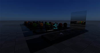

Dynamic Reflections#
During this stage, the engine renders necessary textures for dynamic reflections (i.e. changed each frame): cubemaps for environment probes and 2D textures for planar reflections. To render these textures, the engine goes through all rendering pipeline (but misses some passes described below).
Cubemaps are generated by using 6 cameras, planar reflections use only 1 camera. Both render the final image (one more rendering cycle) with some hooks:
  • Textures use shadow maps, that were already generated in the previous shadow maps rendering pass.
  • All post effects are ignored.
  • Final image for dynamic reflections is rendered missing TAA.

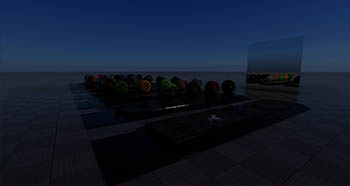

The final texture of dynamic reflections

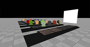

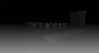

Native Depth Pre-Pass#
In this pre-pass, the GPU performs a depth-test for surface culling. The pre-pass is performed only for alpha test and complex materials (like Terrain materials with a lot of layers).
The depth buffer stores native depth values z/w.
The depth data stored in a depth buffer texture format D32F
During this pass, the GPU can discard a pixel (shading for this pixel won't be calculated).

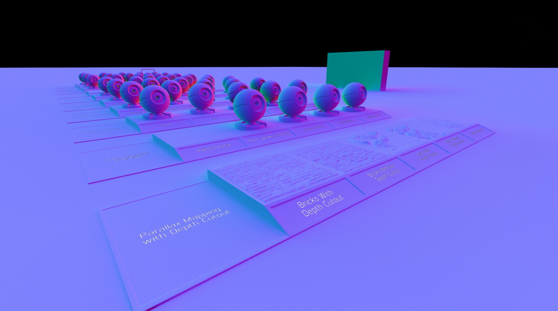

Normal#
The normal buffer stores normal vectors for each vertex of geometry which are required for calculation of the proper lighting.
The texture format is RGBA8 (RT2):
  • RGB channels store compressed normal values (in view space)
  • A channel stores the roughness value

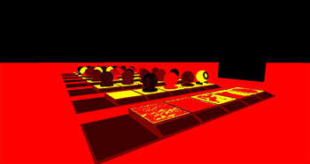

The velocity buffer stores information about the displacement of pixels per frame. When the image is still, the buffer is filled with zero (black) values. These values are necessary to make the temporal anti-aliasing (TAA) and motion blur work correctly.
The texture format is RG16F (RT3):
  • RG channels store pixel displacement values (XY coordinates)
You can disable the buffer, if you don't need velocity-related effects: motion blur, TAA, etc.

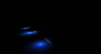

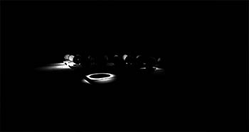

Light sources diffuse layer
Light sources specular layer
The engine uses tile rendering technique for omni lights without shadows. With this optimization, omni light sources are grouped and rendered in batches, decreasing the number of DIP calls and, therefore, improving the performance.

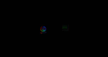

During this stage of rendering, the engine renders all environment probes that have been already sorted on the calculations stage.

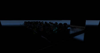

Environment probes are rendered into the 2D array of RGBA16F textures: the first layer contains reflections, the second layer contains ambient light.
The renderer doesn't clear the deferred reflection textures if at least one environment probe has infinite size.
If there is no environment, the RG11B10F 2D array is used.
Reflection texture of Environment Probe
Ambient texture of Environment Probe

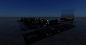

In the reflection pass, planar dynamic reflections (that have already been rendered) are applied. Dynamic reflections are rendered in the same texture that was used for Deferred Reflections.
Planar dynamic reflection is applied

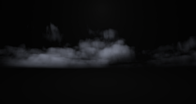

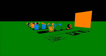

The auxiliary pass is a type of custom pass. Materials with the Auxiliary pass enabled are rendered in the auxiliary RGBA8 texture.
The auxiliary texture is often used for different post effects. This texture has its own TAA stage.
The engine skips this pass if there are no materials with the enabled Auxiliary pass and during the Dynamic Reflections pass.
Auxiliary buffer texture

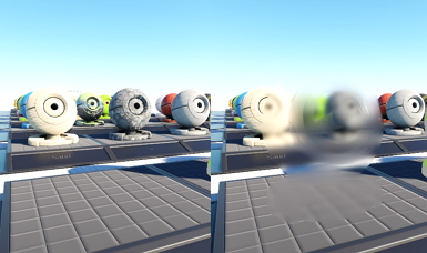

During this stage, the transparent surfaces used in the Transparent Blur effect are rendered. They are rendered in the transparent blur texture and applied during the post effects stage.
Transparent Blur is the R16F texture that contains blurriness values.
This pass is skipped during the Dynamic Reflections pass.
Transparent Blur buffer texture

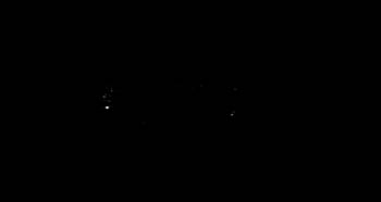

SSR#
Screen-Space Reflections are rendered in RGBA16F textures. They are applied to the deferred composite stage.
SSR buffer texture

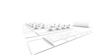

SSAO texture
If the value of the render_ssrtgi console variable is set to 1 and the SSAO texture has been already filled during the SSRTGI stage, the engine skips this step.

Emission#
The emission pass follows creation of the deferred composite image and applies the emission effect over this image.
Emission applied

Volumetric Clouds#
During this step, all layers of procedural Volumetric Clouds are rendered into the RGBA16F texture using parameters of the clouds_base material.
Example of the Clouds texture content
Due to optimization, Volumetric Clouds are rendered in a certain order depending on the following conditions:

In this pass, the engine performs SRBG correction and static exposure (if enabled). If static exposure is off, the engine goes to the Adaptive Exposure stage.
After the SRGB correction
Adaptive Exposure#
During this step, the engine renders luminance texture and applies it to the screen by using the corresponding exposure: logarithmic or quadratic.
After the Adaptive Exposure

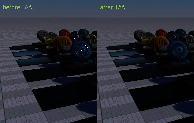

Temporal Anti-Aliasing (TAA)#
This pass is used when TAA is enabled. Otherwise, the engine skips this pass and goes to the next one.
After the TAA
TAA uses previous frames to improve the current frame by using linear interpolation.
