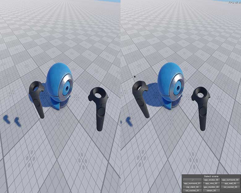

Both the windowed and the full screen modes are supported. By default, on the PC display the image is rendered in mono mode (image from the left eye). Use setViewportMode to change the mode to stereo (both eyes) as follows:
All UNIGINE projects supporting SteamVR are compatible with both HTC Vive and HTC Vive Pro. However, please note that Vive Pro has a higher display resolution, and although no modifications are required, it is recommended to check your project's performance and optimize it accordingly.
To run the plugin sample from the UNIGINE SDK Browser, go to the Samples tab, choose UnigineScript -> App and run the app_vive_00 sample.

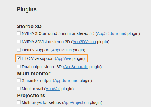

  2. Create a new project with AppVive support via UNIGINE SDK Browser: click Plugins, check the HTC Vive support (AppVive plugin) option in the form that opens and clickOk.
    To add Vive support to an existing project, in UNIGINE SDK Browser, click Other Actions ->Configure Project -> Plugins -> HTC Vive support (AppVive plugin) -> Ok.

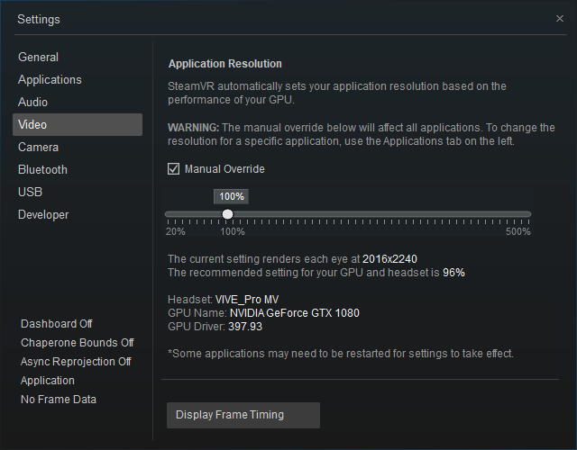

  • vive_render_width and vive_render_height - set a resolution for each eye. The default resolution for one eye is set equal to recommended value by SteamVR.
    Please note that by default SteamVR selects resolution based on your computer's performance. Therefore, for best image quality it is recommended to open the Video tab of the SteamVR settings window, enable Manual Override mode and set resolution to 100%.
    So the resolution will be set as follows:
    HTC Vive HTC Vive Pro
    Resolution per eye 1512 x 1680 2016 x 2240
    The same resolution is set for both eyes.
