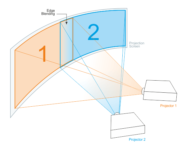

AppProjection allows you to create multi-projector setups. Edge blending, non-linear image mapping and color correction for each projection are supported. Therefore, AppProjection can project images onto large curved screen displays covering 360 degrees, if necessary. Moreover, each projection can be fully customized to use required view frustums.

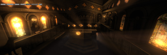

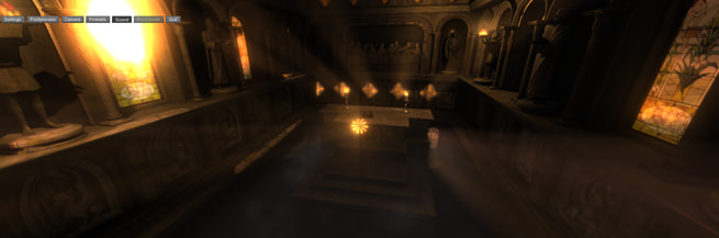

AppProjection with two projections

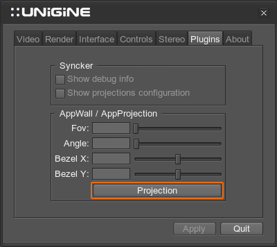

To set up projections, open the system menu by pressing Esc, go to Plugins tab and click Projection button.
The Projection Configurator window will open. Here, it is possible to:

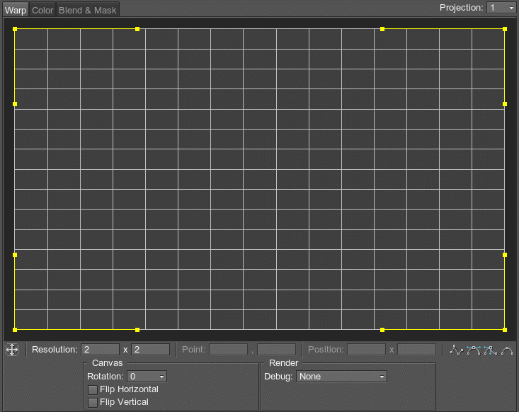

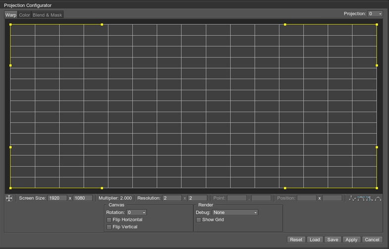

Warping#
The Warp tab allows you to set up geometry correction for your projections. Areas where geometry correction is required include:
  • Advanced off-axis correction where projector placement is awkward and needs an advanced mapping over the keystone function in a projector
  • Non-planar screens such a curved screens and hemispherical domes
  • Projecting one image from one projector onto more than one surface
  • Unusual projection applications onto custom designed screens
You can switch between the control points using arrow keys and move them with the Ctrl key pressed. Adjustable screen size parameters enable you to control each point of your projection with a pixel accuracy. You can also increase and decrease Multiplier to be used when moving points with arrow keys via A and Z keys respectively.
Points are always moved in screen space coordinates regardless of image orientation (whether it is flipped or not), this means if you press left arrow - the point always goes left.
You can also use the following view control options:
  • Middle Mouse Button for panning (dragging the view vertically or horizontally)
  • Mouse Scroll for zooming in and out
  • button to fit the view to the window
The following options are available:
Projection Allows you to choose a projection in the drop-down list to set up its parameters: warping, edge blending and color correction.
Screen Size Allows you to choose screen size in pixels (width x height). These parameters determine the size of the pixel for control point displacement with arrow keys on the keyboard.
Multiplier Indicates the displacement amount to be used when moving points with arrow keys. The resulting displacement amount equals to pixel size, calculated for the Screen Size specified, multiplied by this value. Use A to increase value, or Z - to decrease it.

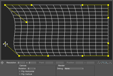

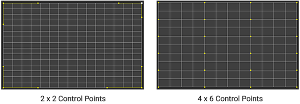

Resolution Warping is performed by defining a grid. A 2 x 2 grid is used by default. You can set the number of control points for the grid along horizontal and vertical axes.
Points Visual editor enables you to set up warping for the selected projection using control points and yellow handles. These handles are displayed for each selected control point depending on its type.
The maximum grid size is 32 x 32.
  • Drag control points and their yellow handles to warp the projection and adjust it for the required configuration.

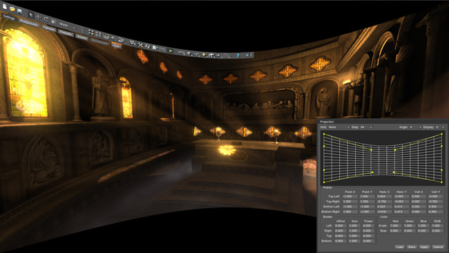

    You can see an example of warped grid and a corresponding projection image below.
    Warped grid
    Warped grid
    Warped image
    Warped image
  • You can fine-tune projection warping by adjusting the parameters of each control point by selecting it and changing parameters via the following panel next to grid resolution settings

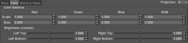

Color and Brightness Correction#
The Color tab allows you to correct color intensity, as well as to adjust color balance for the selected projection.
Scale Per-channel color multiplier. It allows to control the intensity of:
  • Red
  • Green
  • Blue
  • RGB at once
Red channel scale
Scale for the red channel = 2
Bias allows you to adjust the color balance per channel (as well as for all channels at once):
  • Positive values (up to 1) are added to the color values on the screen.
  • Negative values (starting from -1) are subtracted from color values on the screen.
Red channel bias
Bias for the red channel = -0.1
Brightness (corners) allows you to adjust brightness compensation for each of projection's corners individually.
Edge Blenging and Masking#

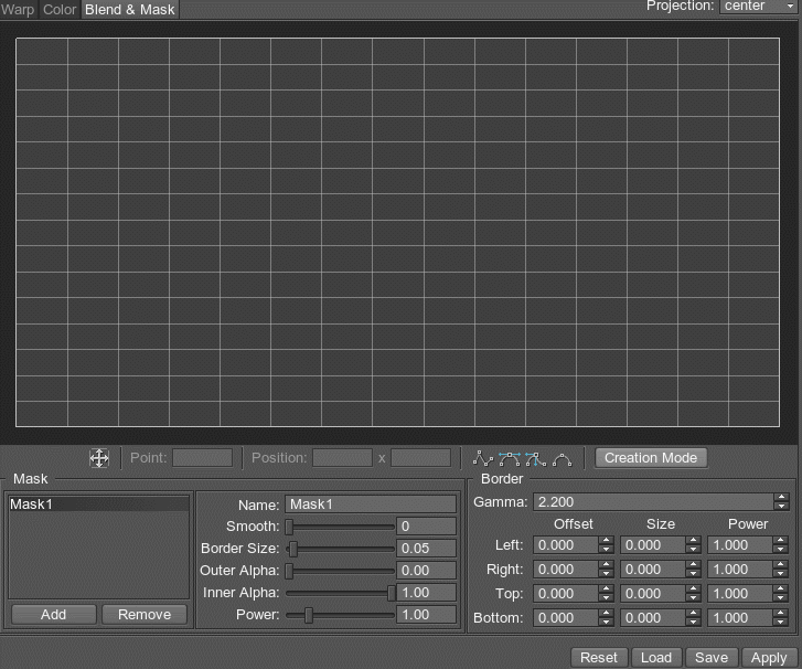

The Blend & Mask tab allows you to configure blending along the edges and according to masks, you can also use masks to cut out certain areas for the selected projection.

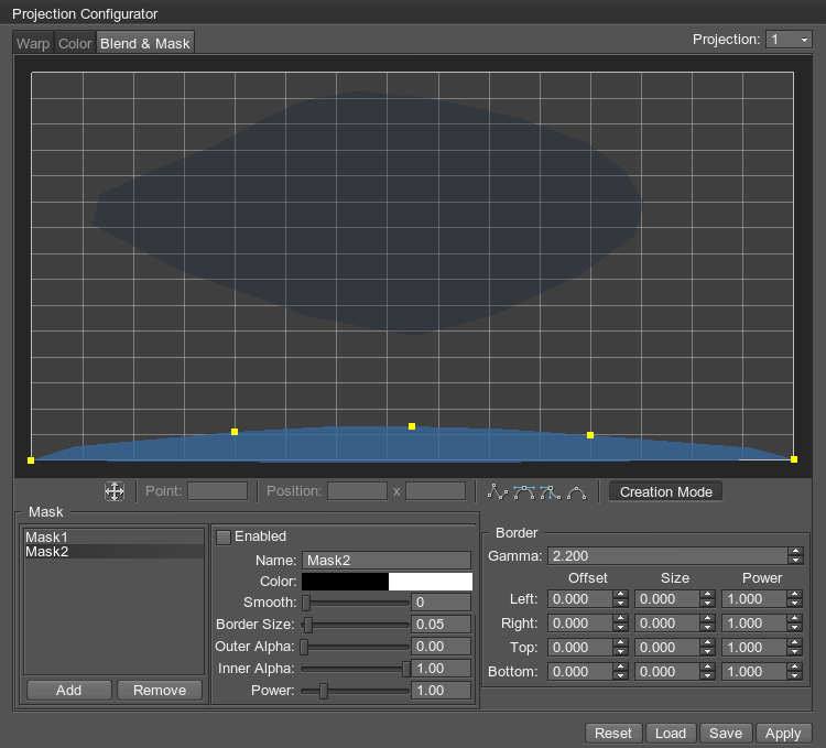

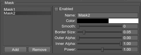

Mask This group allows you to set up masks to be used for blending regions or to cut out certain areas (e.g. top and bottom areas for a curved screen projection).
The list of masks for the current projection is displayed on the left. You can add new masks and remove existing ones using the corresponding buttons.
Visual editor enables you to create and modify masks.
  • To add new points to the mask selected in the list, you should click Creation Mode button. Then you can add new points by clicking within the grid area, new points will be placed at the mouse cursor. To insert a new point into an existing mask, select the point next to which a new point is to be added, and click to insert a new one. You can drag an existing point to move it. To remove a point, simply right-click it.
  • You can also adjust your masks precisely by specifying the coordinates of each point. Select a point on the grid (its color will turn to white) and enter the coordinates in the corresponding Position fields below.
    You can change the type of the selected control point using the following icons:
    • - automatic linear interpolation (no control handles available)
    • - symmetric control handles for smooth curves
    • - asymmetric control handles (you can control each handle independently)
    • - automatic smooth curve (no control handles available)
As you select a mask in the list, its parameters are displayed on the panel next to it:
  • Enabled - enables or disables displaying the selected mask. Can be used for convenience when configuring overlapping regions, when there are a lot of masks.
  • Name - mask name.
  • Color - color to be used for the selected mask. This option can be used to distinguish between masks when configuring overlapping regions and perform color correction.
  • Smooth - smoothing of mask edges. Determines the number of additional points to be inserted between the control points.
  • Border Size controls the width of the blended area along the edges of the mask polygon (analogous to Size parameter for the border):
    • 0 - there is no blending.
    • 1 - a half of the screen is blended.
  • Outer Alpha - opacity of the mask border area along the edges:
    • 0 - the mask is fully transparent.
    • 1 - the mask is fully opaque.
  • Inner Alpha - opacity of the mask polygon:
  • Power controls how fast the screen is blended across the area specified by Size (analogous to Power parameter for the border).
    • The higher the value, the larger the black area is.
Border Controls soft edge blending for each side of the projection (left, right, top or bottom one). Set a non-zero Power value to start setting it up.
  • Gamma - gamma correction value.
  • Offset - viewport clipping offset. The clipped part is rendered in black.
    • 0 - the whole viewport is shown.
    • 1 - a half of the viewport is cut out.

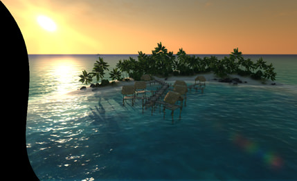

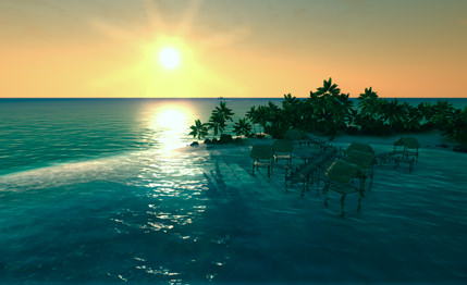

    Low Offset
    Offset = 0.1
    High Offset
    Offset = 1

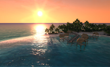

  • Size controls the size of the blended area:
  • Power controls how fast the screen is blended across the area specified by Size.
    Low Power
    Power = 1
    High Power
    Power = 5
