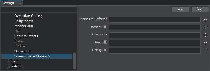

Screen-Space Materials settings
Screen-Space Materials Settings
Composite Deferred Custom composite deferred materials, that are used at the deferred compositestage of the rendering sequence. Several comma-separated materials (without whitespaces) can be specified. A debug material can be put here in order to be added to the final image
Render
The checkbox toggles on and off the pass to render postprocess materials applied before all other Unigine postprocesses (such as Bloom, Exposure, HDR, DOF, refraction, motion blur, and so on) are rendered. To skip this pass, disable the checkbox.
In the field, indicate postprocess materials that should be applied before all other Unigine postprocess (such as Bloom, Exposure, HDR, DOF, refraction, motion blur, and so on) are rendered. Several comma-separated materials (without whitespaces) can be specified. Custom postprocesses can also be set.
For example, if post_blur_radial is set here, radial blurring will be applied first.
Composite Custom composite materials, that are used for final screen composition instead of the default ones. Several comma-separated materials (without whitespaces) can be specified.
Post
The checkbox toggles on and off the pass to render postprocess materials applied after all other Unigine postprocesses (such as Bloom, Exposure, HDR, DOF, refraction, motion blur, etc.) are rendered. To skip this pass, disable the checkbox.
In the field, indicate postprocess materials that should be applied after all other postprocess (such as Bloom, Exposure, HDR, DOF, refraction, motion blur, etc.) are rendered. Such postprocesses, when applied to the screen image, affect glowing areas and so on. Several comma-separated materials (without whitespaces) can be specified. Custom postprocesses can also be set.

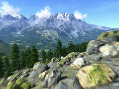

Here is an example with post_blur_radial material.
Radial Blur Post Material
