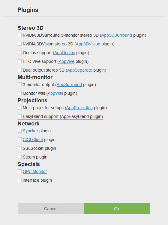

  3. Create a new project with AppEasyBlend support via UNIGINE SDK Browser: click Plugins, check the EasyBlend support (AppEasyBlend plugin) option in the form that opens and click Ok.
    AppEasyBlend Plugin on Plugins Panel
    To add AppEasyBlend support to the existing project, in UNIGINE SDK Browser, click Other Actions -> Configure Project -> Plugins -> EasyBlend support (AppEasyBlend plugin) -> Ok.
