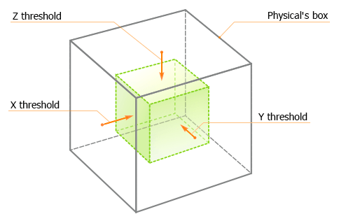

void setThreshold( const Math::vec3 & threshold )
Sets the threshold distance values along the coordinates axes relative to the wind node size (that is, inside of it). It determines the area of gradual change from zero to full wind velocity.
The threshold distance values form an invisible box, inside which the wind blows with full velocity:
Arguments
  • const Math::vec3 & threshold - Threshold distance in units.
